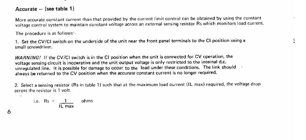

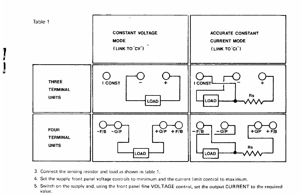

I recently got an old 1970s regulated power supply unit off of ebay. I´ve tried looking for info on the manufaturer and had no success...
I want to ask you if anyone knows what is meant with the resistor connection thats printed on the positive outputs labeled V and I. This might be a newbie question, but i haven't had experience with this kind of PSU.
Thank you for your help!
jjasniew: Yeah it just feels odd. I wish I could find a manual for it! I have the feeling I am missing something. But why make it go into constant current mode in that way if there is a switch to put the PSU into const. current though?
JonSnell: Maybe for an external meter? The PSU has a meter built in.
I suppose I'll have to re-cap it and just test to see what it does.
I have a couple of Farnell PSU's with a similar set up. The manual describes how to use the feature and why it exists. Yours will be the same...
Have a read at the pdf file.
