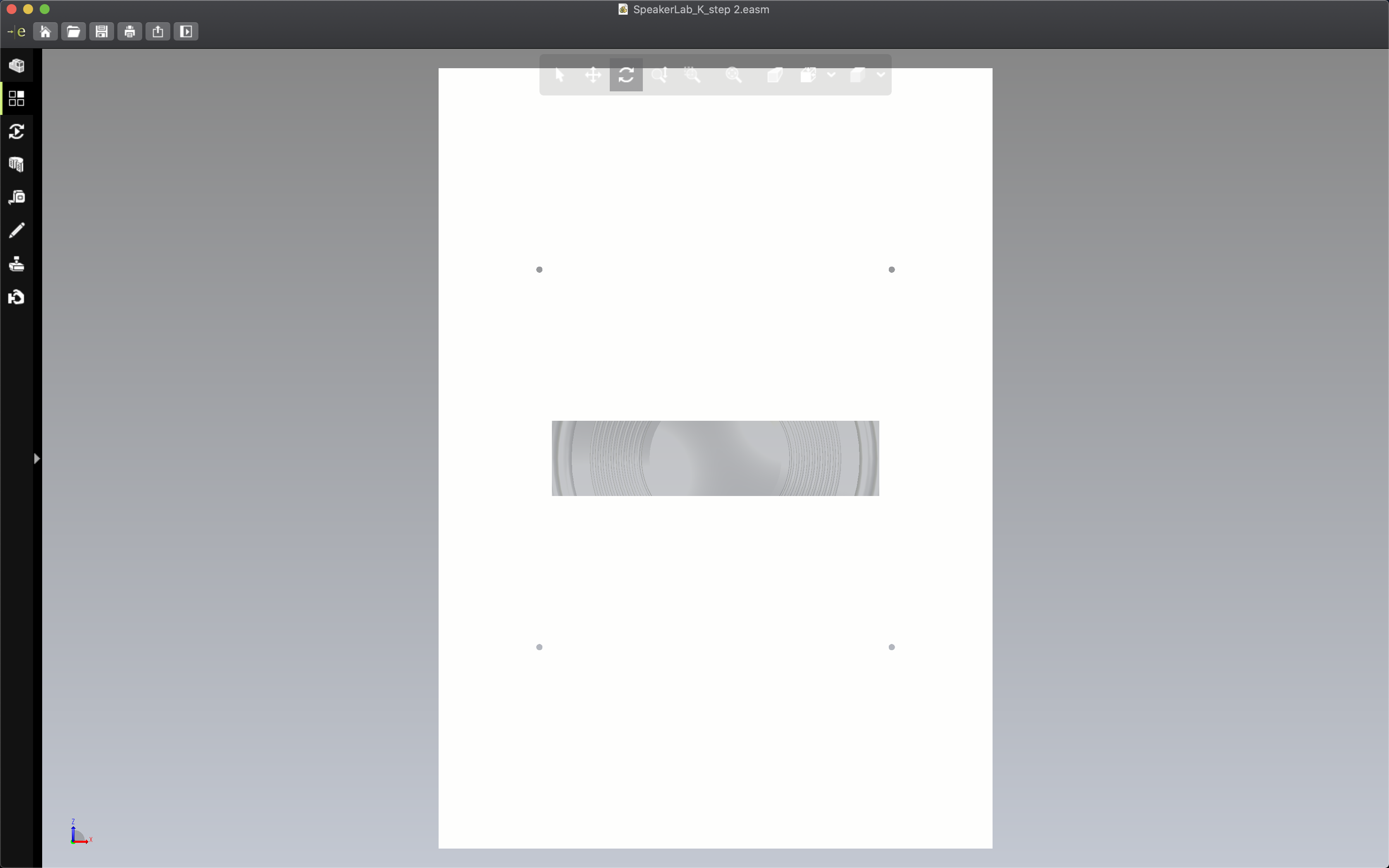

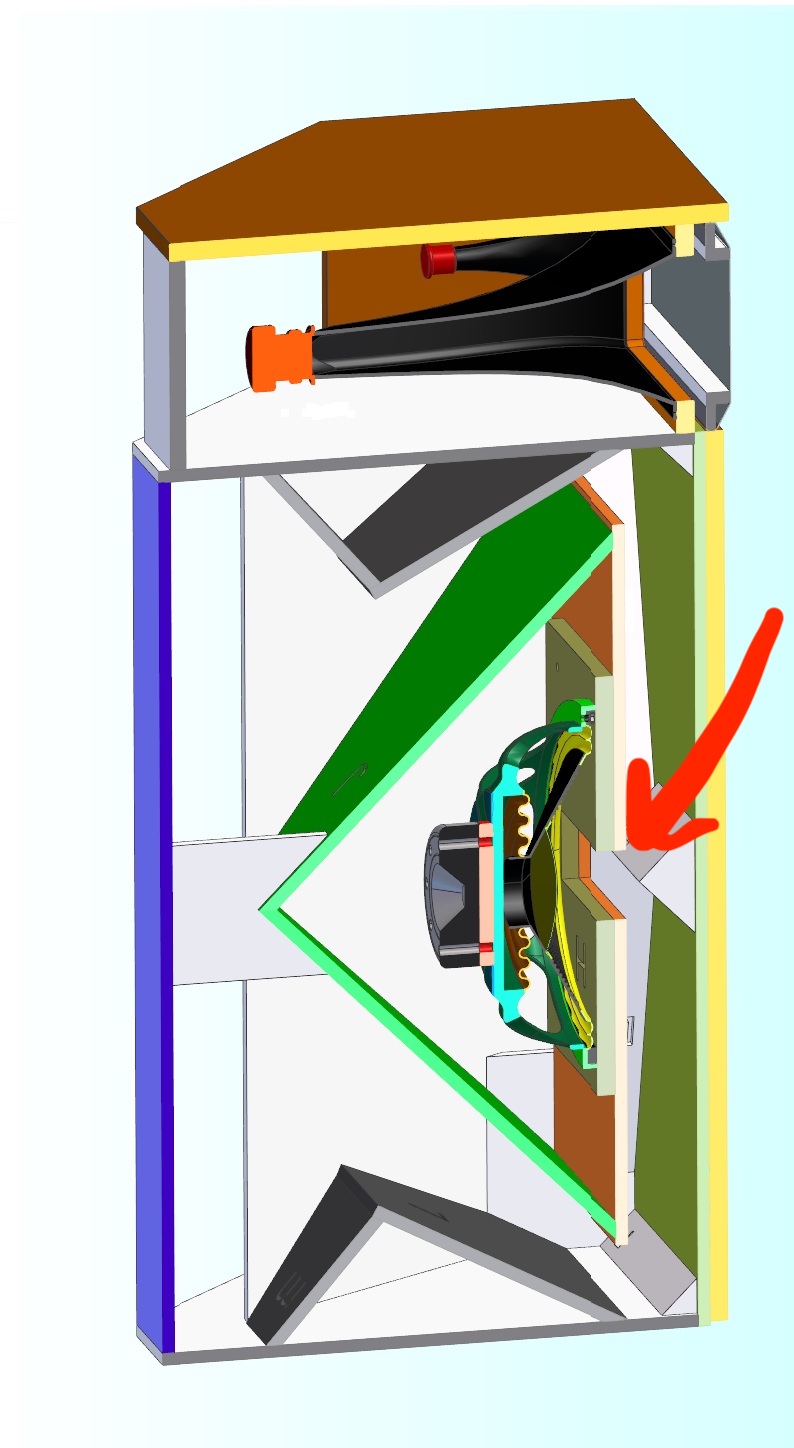

What does this "bass horn" actually consist of?
What is the function of the opening for the driver and why is it that shape and size?
Why is it rectangular?
Why is it not the shape and size of the driver?

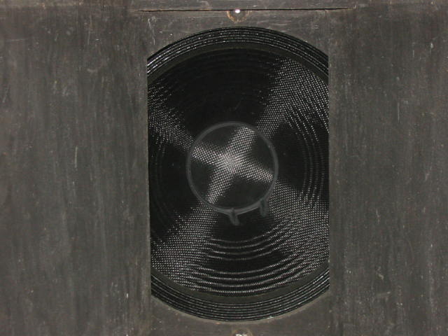

In simple terms, it's a means of compression and has been used since long before these horns. Here is an Altec 828 FLH cabinet from before I was born. There are many examples of this including those right up to this day. It's shape likely has to do with it's similarity to the remaining horn pathway. IOW, it's good to control the air flow, it's not necessarily good to fight it or complicate it further.
IIRC, it was 13 inches by 3 inches. It sets the compression ratio.

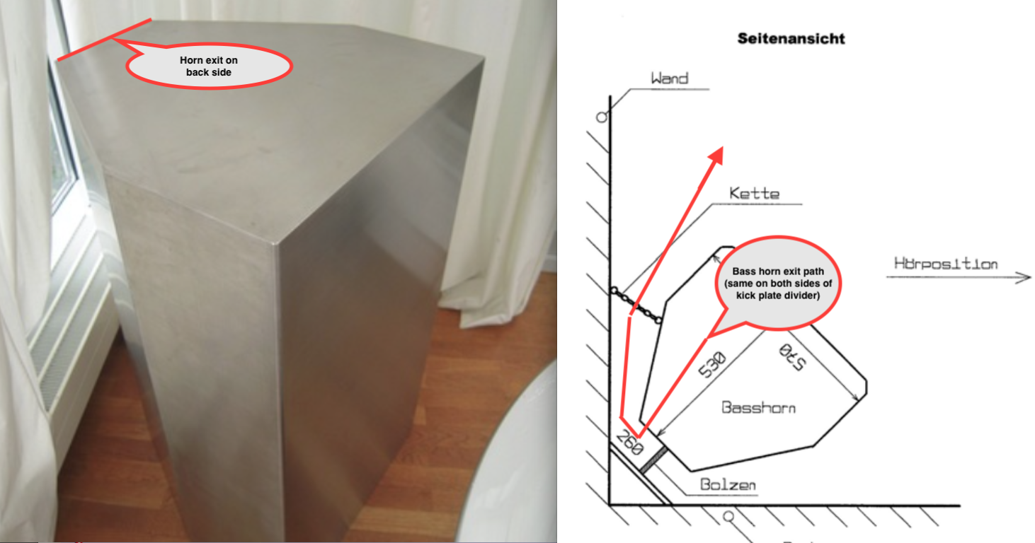

Since the cabinet is completely sealed, what happens when the airflow finally stops?
Do the walls of the cabinet become the new resonators?
2)What is the function of the opening for the driver and why is it that shape and size?
3)Why is it rectangular?
4)Why is it not the shape and size of the driver?
Simonsig,
The Martion Orgon cabinet is not completely sealed, it is open on the back, similar to the Klipsch corner horn. The cabinet walls are not resonators, they form the inner portion of the corner horn. The corner completes the horn, using a "bolzen" (kick plate reflector) in the area between the FLH cabinet and corner walls for a smoother transition between the two.
This type of "corner" FLH (front loaded horn) has a gradual (exponential) expansion of cross section area through several different bends.
The horn throat is reduced to less than the driver's Sd (surface area of the driver) to achieve a higher compression ratio, using less cabinet volume than a large throat would require.
Higher compression ratios result in higher horn efficiency.

In the Klipschorn the slot is tiny compared to the driver so I always assumed that it does create a compression chamber but with Altec I assumed that there isn't much compression going on and I thought it was mostly to widen dispersion in order to change it from conical (above 700-800Hz) so it can be shaped into the nominal 90x40 over it's entire operating range.
Am I wrong? I've never bothered to calculate it properly, it's just what it seemed like to me.
The reason the slot is short and wide is more likely practical, as with a constant width box it can go to narrow and tall at the other end. At these frequencies, directivity isn't likely to have anything to do with it.
