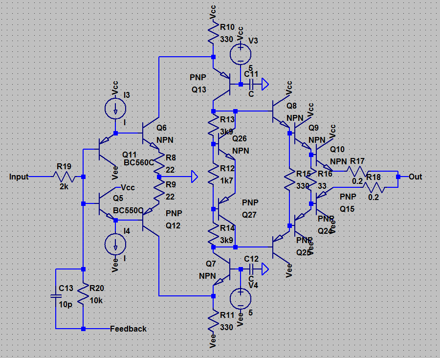

This is not buffer, input impedance are 2k and gain =5, but it's very simple and could be optimised for any goal.

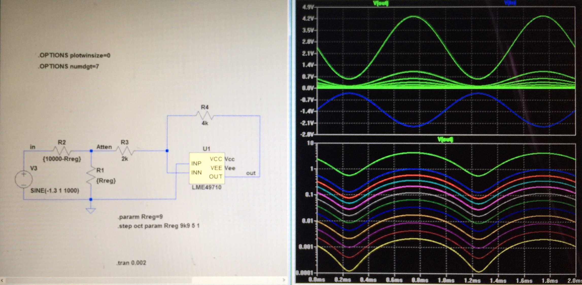

In this amp the gain is source resistance dependent.
Thank you for your input, Damir!
I supposed to have low output resistance of the source.
But you are clearly right and it was designed exactly for having well-approximated logarithmic volume regulation with simple, better quality and cheap linear potentiometer.
Not less than 100 dB regulation depth:

You are making very interesting circuits for sure Pavel, but I still see the problem here. The potentiometer should be of low resistance, is it not? The DC current is going to flow through it and that's not good. I would add a buffer here.
Thank you for your kindness, Damir!
Your circuits are well-designed and very sophisticated too!
Sometimes i’m thinking about some kind of guide, but average level aren’t high enough, so let’s allow Douglas Self and Bob Cordell to carry their own crosses...
No, sinewave are biased for better look.
But really, we could add some DC for excluding croosover effects in the resistive alloy, wire alloy, wiper contact, etc...
We’ld subtract it later, somewhere at the load...
Yeah, logarithm have a two setting up parameters.
~2k input and ~10k potz are good enough, not so low for loading previous source, not so high for excessive noise.
It appears simple to someone used to understanding schematics, but non-technical builders will quickly see that it has 14 transistors, minus what you will need for the current and voltage sources. In contrast the MJR7 amp I linked to earlier has 7 transistors. Though despite the simplicity I haven't heard a single person say they've built one.
Both designs would have to be adjusted for unity gain however.
