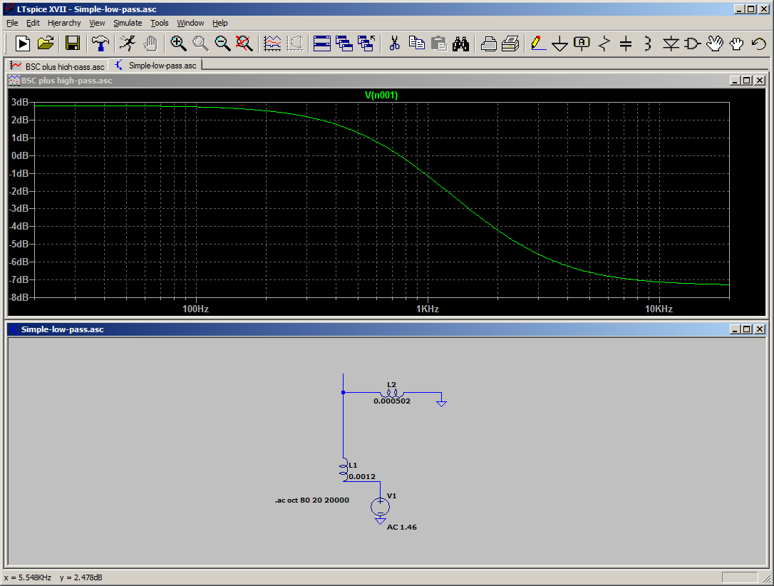

Seems to me (and LT Spice) that a series inductor on its own works as a simple high frequency attenuator:
attachment.php
But the inductor in the video was put in parallel with the speaker not in series.

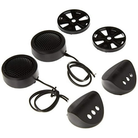

This is not a simple inductor, it is step-up autotransformer ("booster") salvaged from a cheap piezo tweeter. It delivers more voltage to the speaker, but introduces serial resistivity - thus increasing Qts. Step-up transformer wire is extremely thin, not allowing much of power through it.
Bottom line: crap gimmick.
I'm satisfied with that explanation, and the conclusion as well. 🙂
Motorola didn't use this trick, but some loudspeaker manufacturers did incorporate externally their own step-up autotransformer in the "crossover". Today, there are plenty no-name Chinese manufacturers of this kind of "boosted" piezo tweeters. It works OK for tweeters, but usually the piezo disc is unsupported, or it is glued on the wrong places/points - making horrible tweeter. Many models are advertised as a "dome" tweeter, which is deceiving - the dome is glued to a piezo disc, with step-up autotransformer behind it. This one (from Walmart) is typical:
