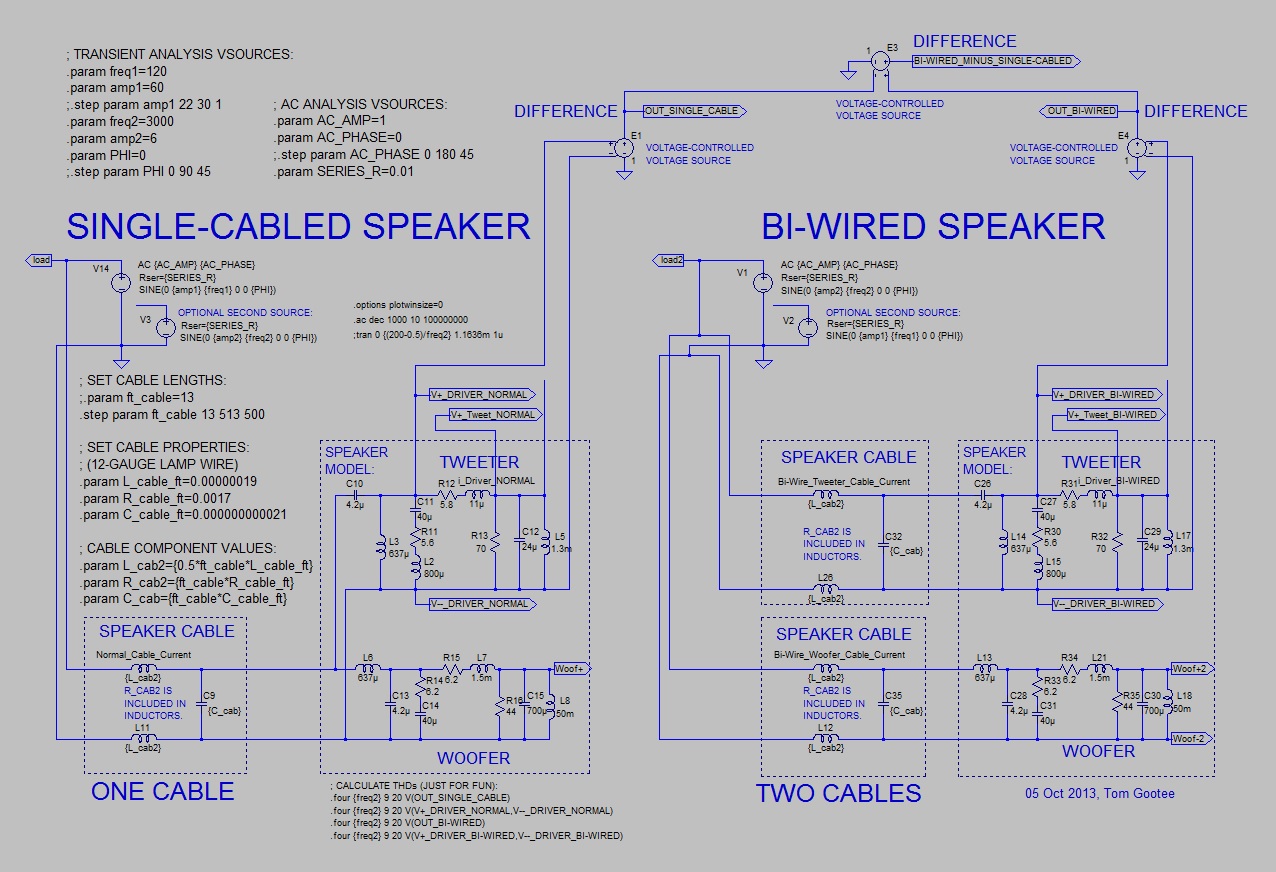

In LTspice, use a vcvs (voltage controlled voltage source). I believe its model is called E.
~Tom
Thanks, Tom. That is actually what I have been doing.

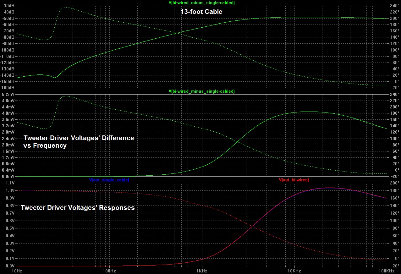

Attached is a cleaned-up version of the schematic and its corresponding LT-Spice .asc file.

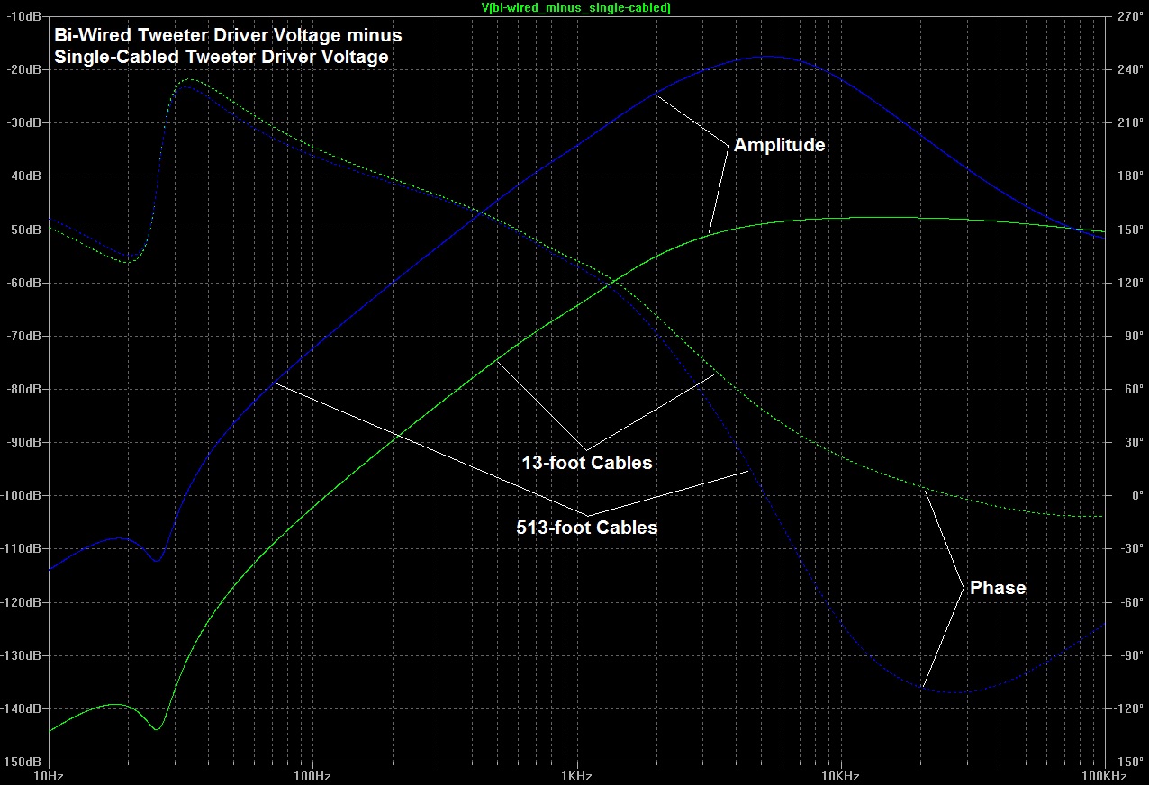

Plots of differences between tweeter driver voltages for bi-wired and single-cabled are also attached.
I will let someone who knows more about this stuff, like bolserst, show plots of things like on-axis response differences, if desired.
Edit: I also temporarily used a time-domain pulse source for each speaker (with all other sources disconnected) and applied a 6-Volt step with a 10 µs rise-time, and plotted the difference of the two tweeter driver input voltages.
Tom

I disconnected all of the voltage sources shown in the schematic and added two identical ones (one for each speaker) that use a WAV file for input, with a WAV file containing the intro to Highway to Hell, by AC-DC.
Using 13-foot cables, there is a difference between the bi-wired and single-cabled tweeter output voltages. Plots are attached.
Tom

I believe if you zoom in to the fuzzy difference area, you will find that it is sawtooth in nature, with the same slope as the 10 usec step.
If you halve the tweeter impedance or double the cable impedance, that fuzzy will double in amplitude.
jn
