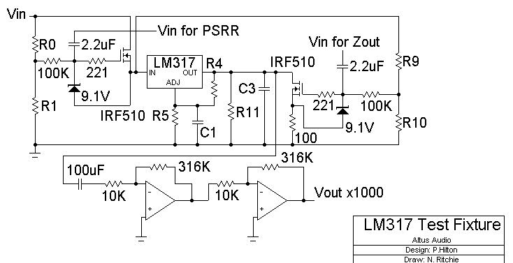

You can use Fred Dieckman's regulator tester to examine PSRR and Zout. If you can find Zout, you can find phase/gain relationship:
Great info

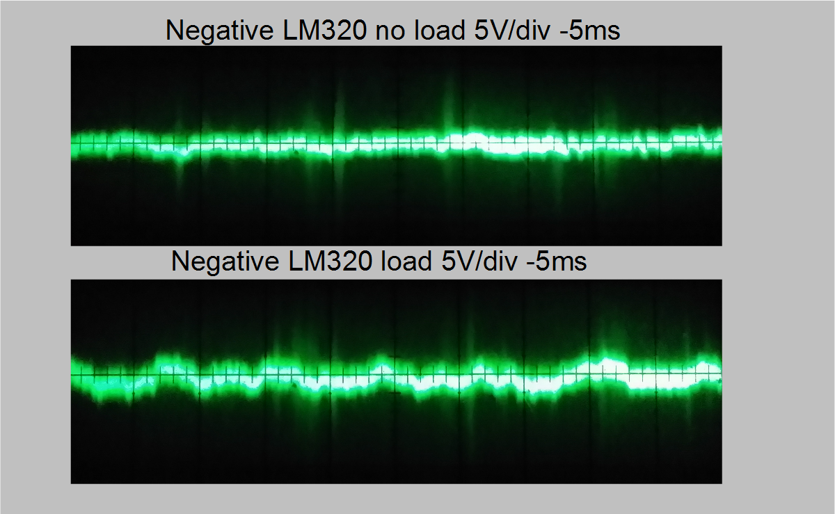

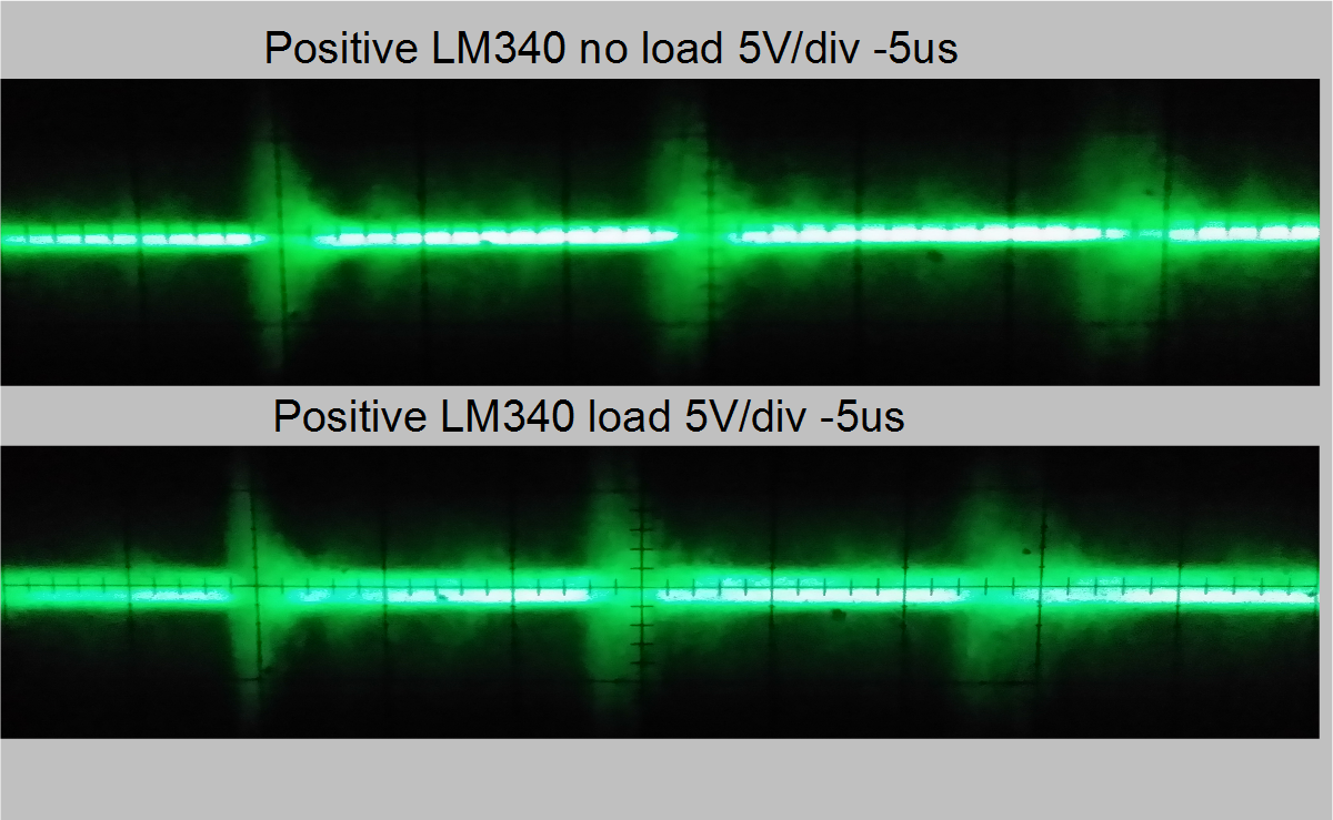

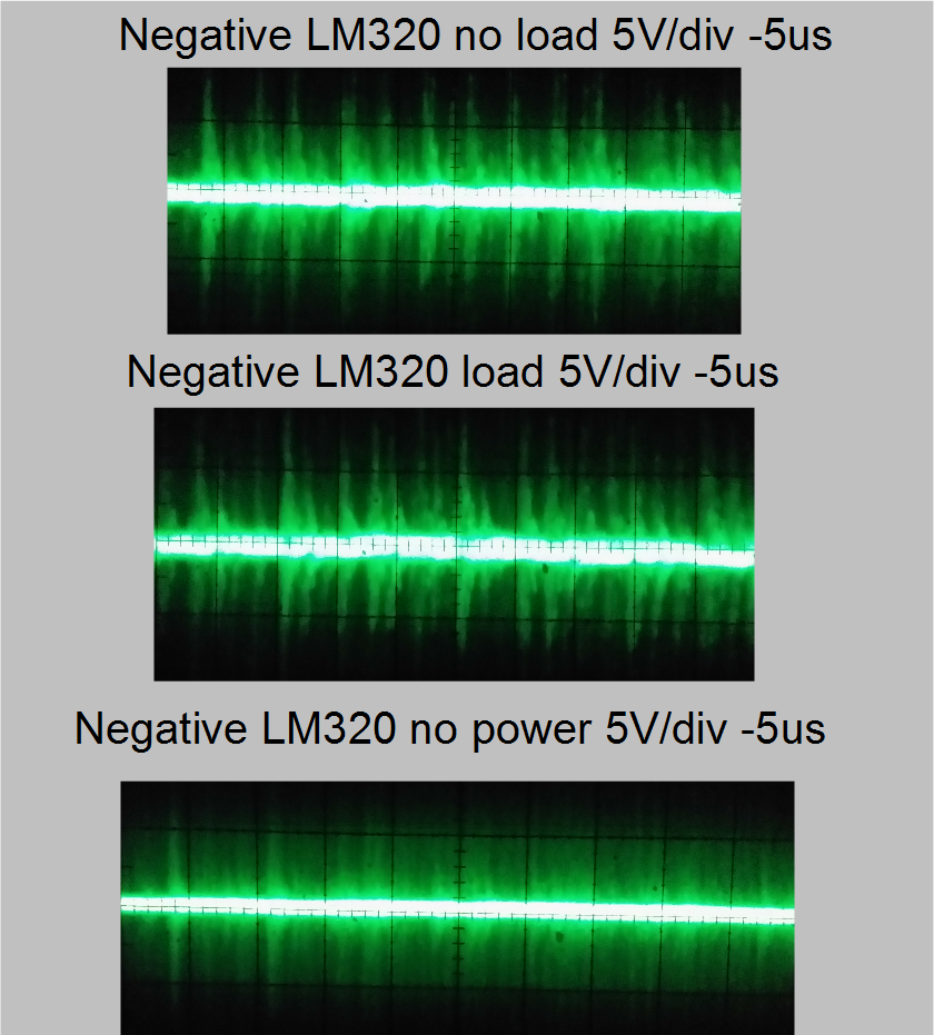

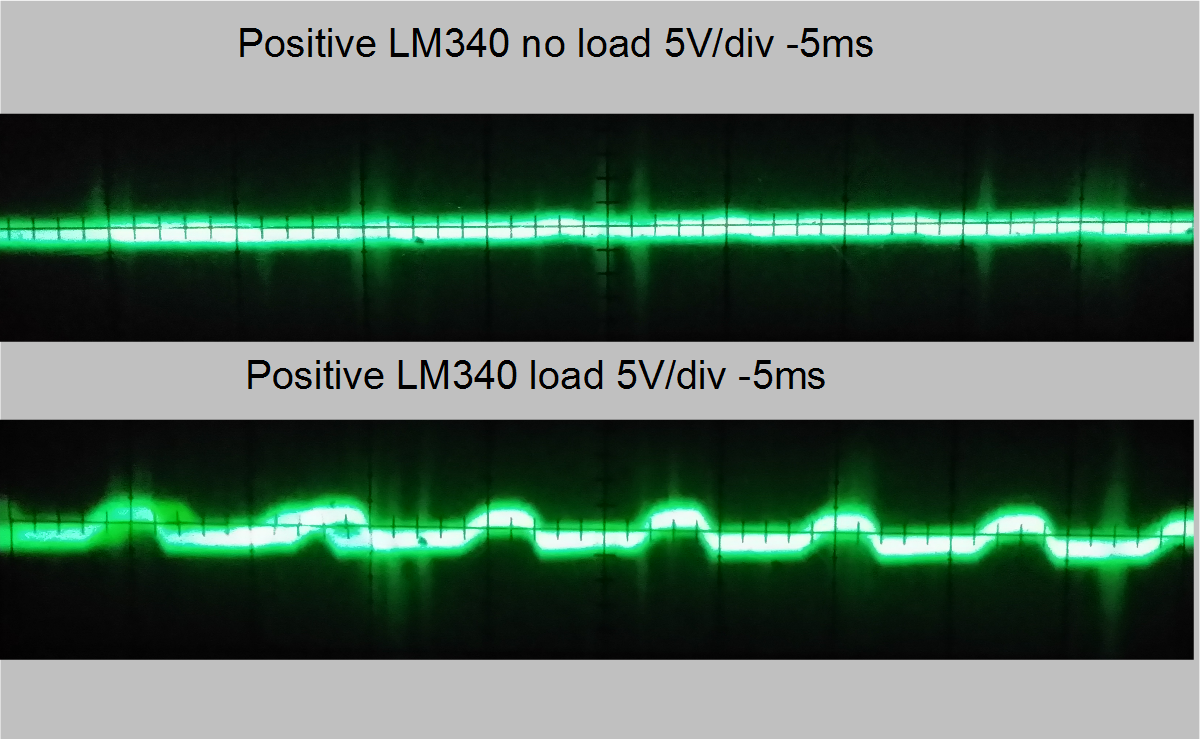

Here are some pictures of measurements. Does anyone see anything bad going on? The load was 98.77ohms. +/-15V regulators' output.

Now that is one cool PSU tester! I do mine a little differently by injecting the noise or sawtooth into the error amp of the input regulator feeding the test supply. The current draw pulses are created with a DC amplifier feeding a 0.511 ohm resistor from the test supply. Fred Dieckman's regulator tester really sparks some ideas.
Many thanks to both of you on that!

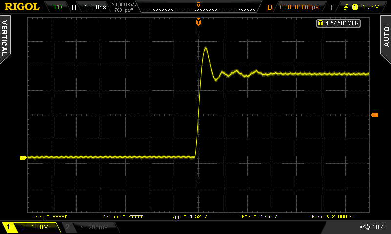

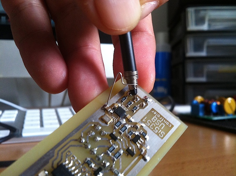

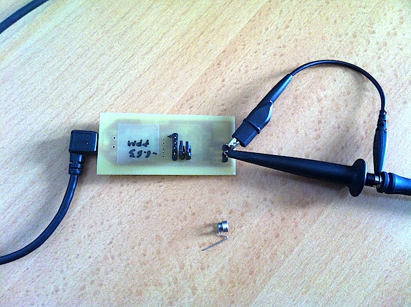

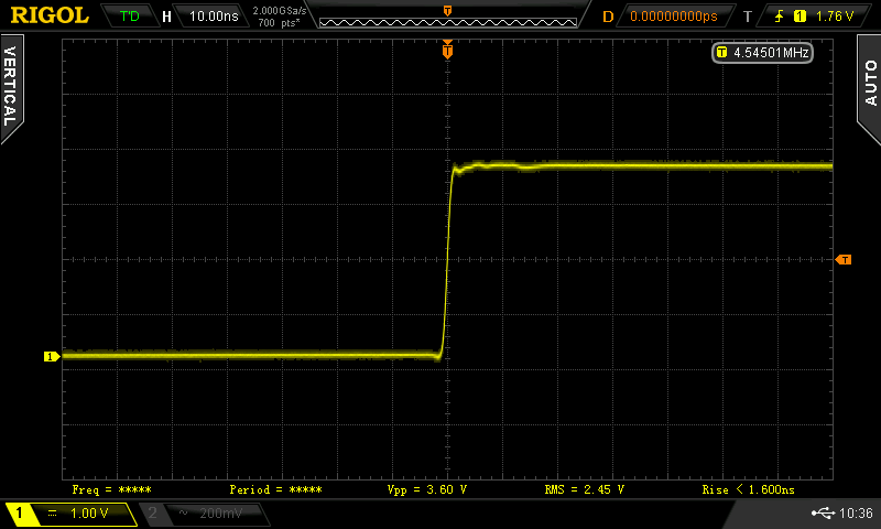

Beside having oscilloscope it is more important how you will make the measurements as there are many problematic point especially if you looking for some low values of signal or working with high speed signal.
Here is one practical example how you can be fooled to have "something" in your signal but after considering the effect of parasitic inductivity of just 10-15cm GND cable of oscilloscope probe you can have much clear picture.
First and second picture show standard way to measure something and results of that measuring, but that is not correct for some application. Other two picture show correct method for most application.
PS: this is example of measuring high sped signal which have about 1500V/us slew-rate. Such high slew rate can be found in almost every SMPS and it is very important to use proper method. Similar is with measuring (AC coupled) noise or ripple of some linear regulator.
