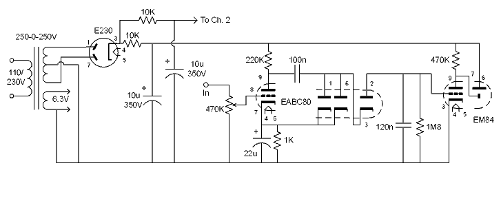

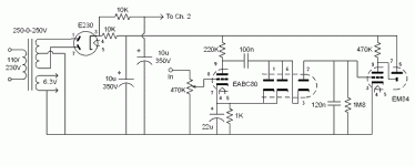

I think a "magic eye" type of tube with it's associated circuitry to drive it to show VU looks damn cool...anyone tried it?? I have seen a pair of em at my local speaker repair shop...tt guy built it on his own...maybe some of the tube guys will know what I'm talking about...here's a circuit...

i've seen some "magic eye" tube in a shop here, maybe u'd like to try
