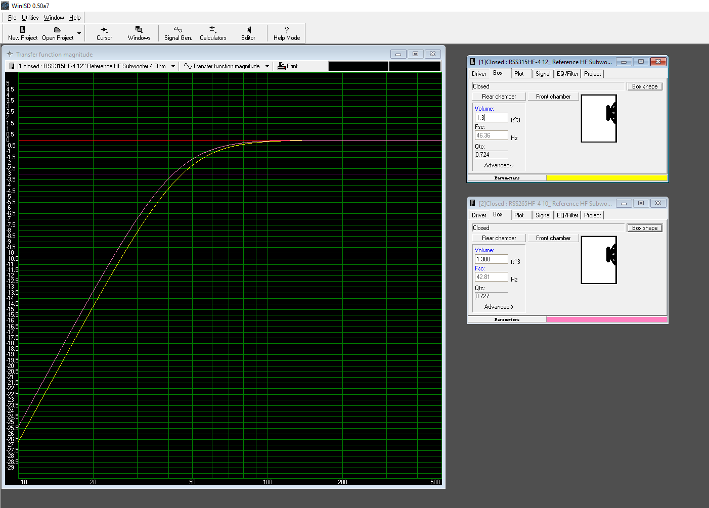

I am a bit confused about what 'EQ-ing' a subwoofer means. I understand it has something to do with flattening the response but how is it done? Is it a physical process? Could it help me get lower bass in a sealed enclosure?
I'm on the fence between two drivers, one 12'' which is more efficient and better at power handling and one 10'' which is less efficient but has a marginally better bass response. Could I EQ the 12'' to have a more desirable bass response? Someone mentioned a Linkwitz Transform and that it could help in this scenario at a cost to efficiency. Whats the go with that? I had a little look into it and it sounds pretty technical.
Here is a screenshot of the Transfer function magnitude graphs of each driver in a 1.3 ft^3 box which seems to be a fairly good size for both drivers (correct me if I am wrong). Capture12v10.PNG
YELLOW = 12''
PINK = 10''
Thanks!

Your 10" driver (RSS265HF-4) would be fine in anything between .5 and 1.5ft^3, and the 12" driver (RSS315HF-4) would like between 1 and 3ft^3. Change you simulation to show the output w/ the driver(s) @ Xmax to compare the high output capabilities. What you have to evaluate is the output capability in your chosen enclosure, and if it fits your requirements. I doubt that the 10" has higher bass output than the 12".

The two drivers are different sizes in the same series, the Dayton Audio Reference HF series. I am asuming the build quality and materials are the same but the 12'' drive has a 2mm larger Xmax and is more efficient. I am thinking of going with this driver for those reasons. Thanks for your response 🙂

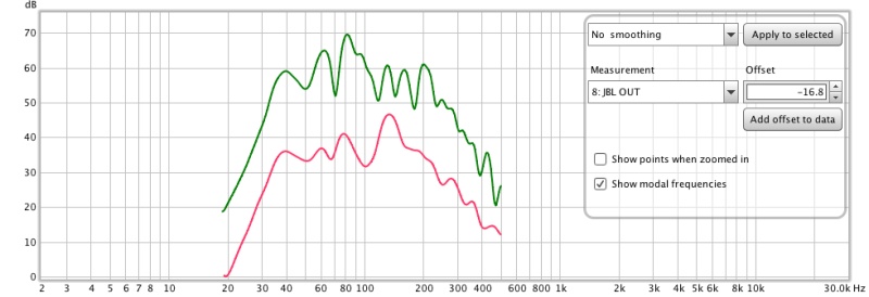

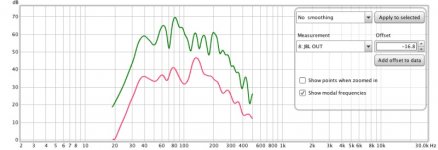

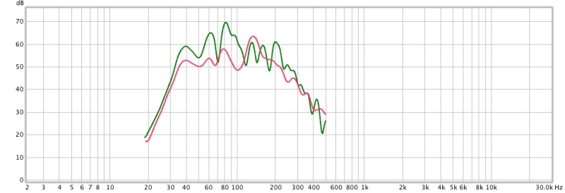

To illustrate my point, here is the same sub moved maybe 3 feet, same input. The first chart shows how they would sound at my ears, 1/12 smoothing. In the second, I've moved the traces apart to see them separately better.
Neither is a great curve, but second one seems nicer to my eyeballs because the low bass, while lower absolutely, is relatively closer to the trend for the upper bass. Well, good enough for $40 at the thrift store.*
BTW, in testing three rather different subs (smaller ported, bigger ported, bigger with passive radiator), the differences between any were quite small when in the same location. The conclusion is that the room has more to say about bass than anybody's sim supposes.
Ben
*JBL PowerBass PB12.... maybe us$500 originally
