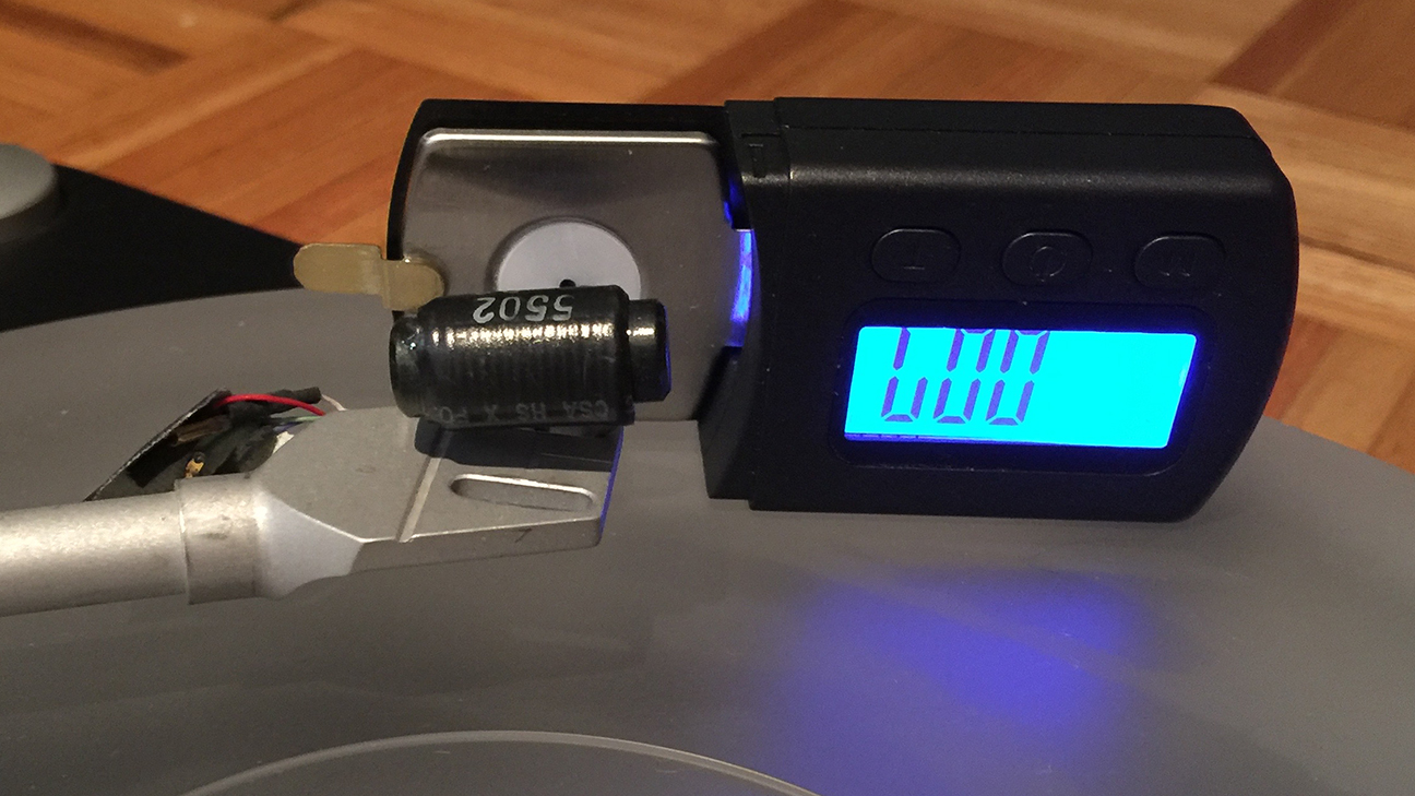

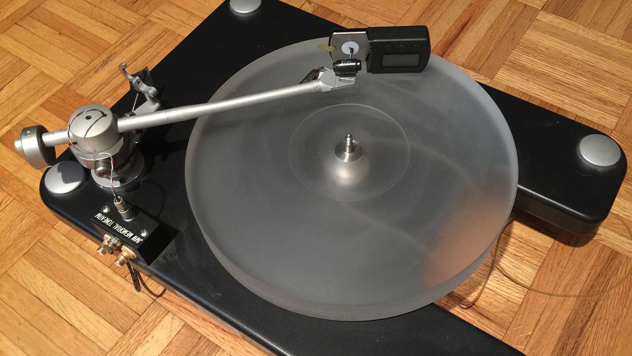

I always used Test LP to adjust anti skating before I built my air bearing arms, but I have been thinking of using jewelry scale to measure anti skating force for long time.
This method of anti skating measurement is based upon following principal. Anti skating force should be almost same as VTF.
The arm I used was VPI’s. It has no anti skating device. The only thing I could do was to twist the signal wire to get some resistant force. I have Graham 2.2 arm, too. Graham has very nice anti skating device. However, I broke the arm tube.
First, I added a weight which was 13 g on the head shell and adjusted the counter weight until the head shell suspended in the air. In reality, you don't need to add weight. I added weight just for the experiment. Care should be taken not to damage your cartridge. The height of head shell should be about same as the height of actual cartridge. Then, I put the scale on its side. I have three jewelry scales. This kind of scale doesn’t change its reading when you put it on its side. In order to let the scale to set to zero, I put the scale on its side first, then to turn it on. I twisted the signal wire to get some outbound force. When the head shell hit the scale, I got a reading on the scale. Due to VPI arm has no anti skating device, I only got .07 g. The .07 g was the force generated by twisting the signal wire on the arm. If you have anti skating device on your arm, I believe you may get anti skating force 1 g or even higher.
If you want anti skating force is some percentage of your VTF, it can be done with simple math.
This method may not be perfect. However, it gives an estimate and let you know how much you decrease or increase anti skating force.

that is clever and interesting use of scale. I have digital scale and Technics DD turntable with spring anti skate. If I set vertical tracking force to say 1.7 g. and put scale on opposite side (Opposite of what you mentioned) and set 1.7 g. anti skate will that give approximate good anti skating value ?
Thanks and regards.
Thanks and regards.
Yes. I think so. You need to make sure that your scale doesn't change its reading when you put the scale on its side. I have no way to test my method now.
