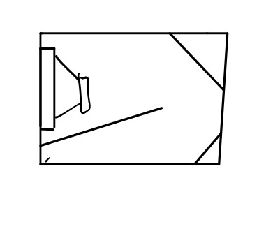

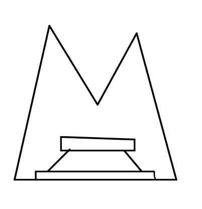

What does an ideal phase response for a driver look like?
Something like these shapes?
A (Top View)
B (Side View)
In that case, I'll redo the measurements tomorrow to see if I can fix the problem, and hopefully, we can make some interesting insights.

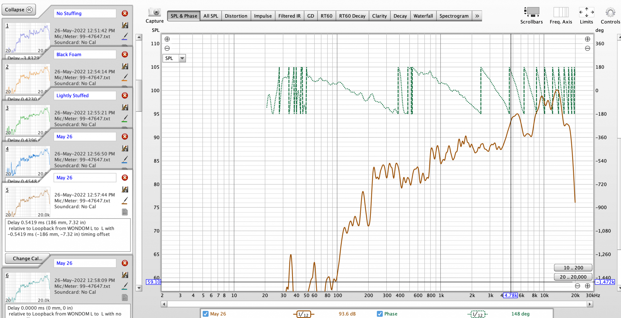

I recently ran an experiment with a small box and a midrange driver. The goal was to test the effects of different stuffing materials on the response. I shot these sweeps on REW and kept all the variables the same besides the materials used for stuffing. I'm not really sure how I should be interpreting the phase response graph and what is ideal.
Test 1: No stuffing, empty box
Both the frequency response and phase response are jagged. The pattern is broken up around 13khz, I'm assuming that is some kind of driver breakup causing a spike in FR.
Test 2: lightly stuffed with polyfill
In this test, the phase response seems to have flattened out significantly. My assumption is that this is a good thing since that means the different frequencies are more or less aligned closely?
Test 3: Tightly stuffed with polyfill
With the tightly stuffed polyfill, the phase response has gotten very smooth and linear. The FR has also smoothed out quite nicely.
So my question is, what is an ideal phase response? Subjectively speaking, what should a good phase response sound like?
The ideal is no big phase shifts (the third one). Take a look at the GD plot. Between 1khz and 5khz, you don't want any negative larger than -0.5ms and humps bigger than 1ms. Nice and smooth slopes or flat is best.
Be sure to check out the decay graph and also set your window to something short like 4ms to view 1khz on up.
I definitely agree with you about the internal reflections superimposing on the driver's output. I probably should have mentioned that this is a planar driver (GRS PT6825-8) which I would assume makes it more sensitive to that kind of interference due to the lightweight nature of the driver.
In an application scenario, the dip at 1700 is probably the only issue thing holding this back from being a really good midrange. A lot of speaker-building literature (mainly guides on YouTube) seems to think that adding foam/stuffing materials is enough to eliminate standing waves, but maybe that isn't the case. Maybe a differently shaped box would be better for eliminating standing waves? something trapezoid-shaped or triangular.

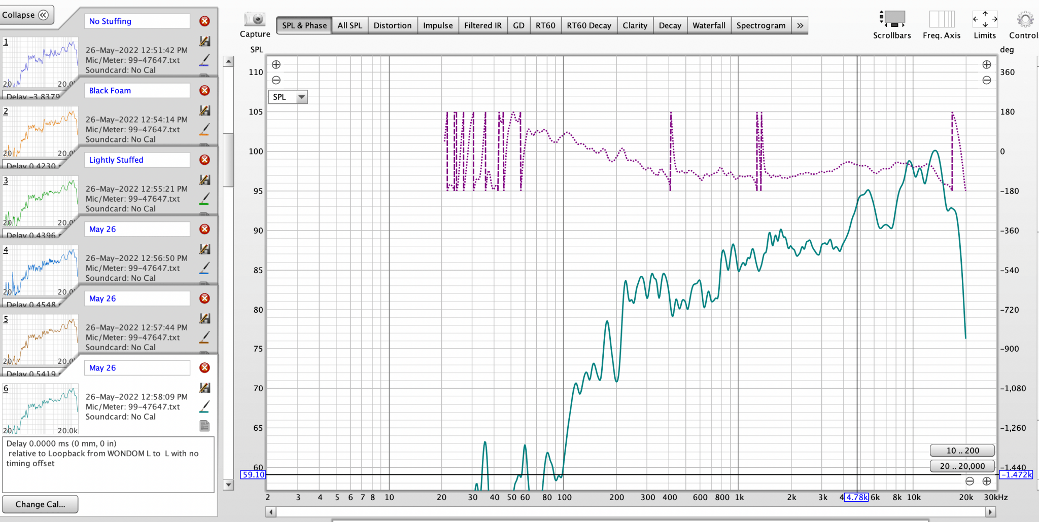

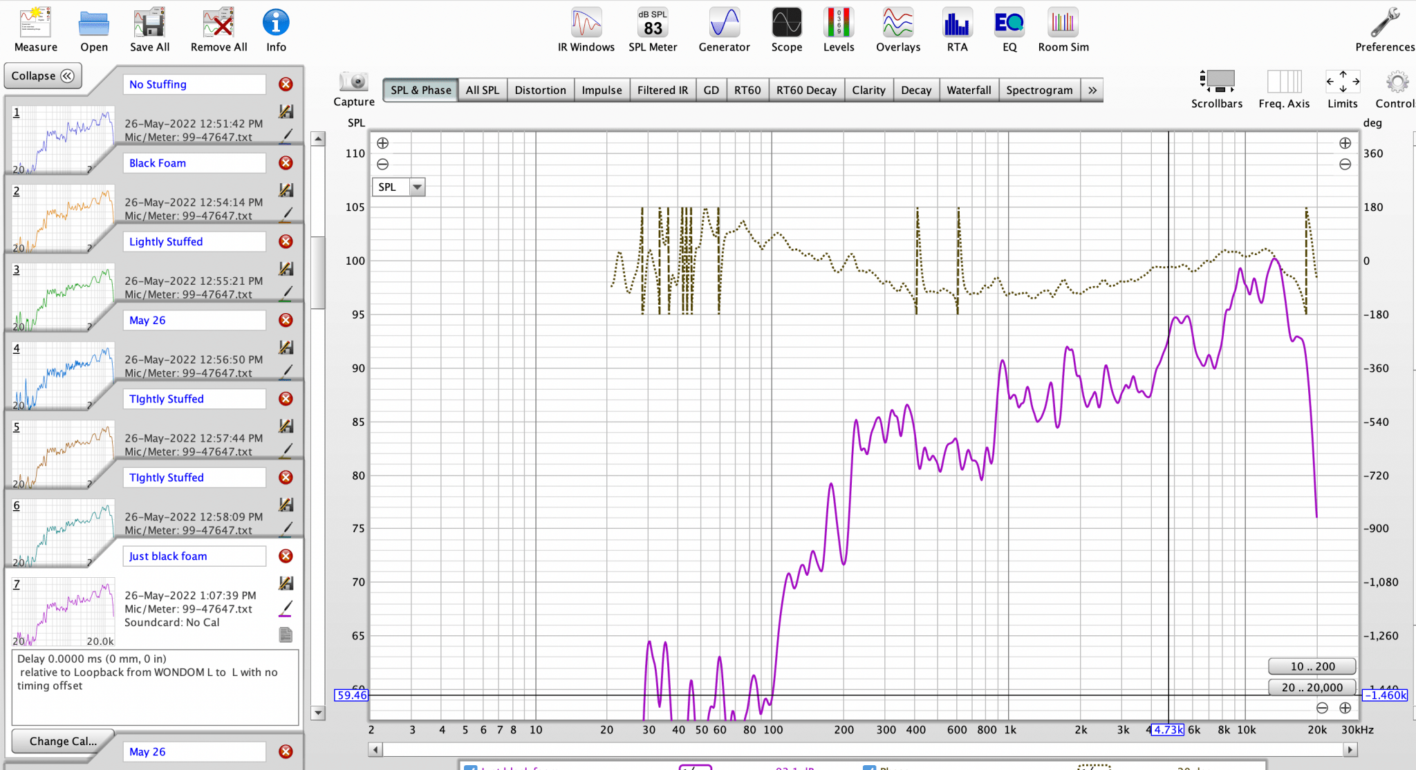

Here are some interesting findings. Seems like I definitely had the delay set wrong. Here are two measurements, one with the delay set automatically and the other artificially set to zero. Obviously, the frequency response stays the same, but there is a significant difference in the phase graphs. The graph measured at zero delay has a much flatter response.
Automatically Set Decay (Box tightly stuffed)
Manually set decay (0ms) (Box tightly stuffed)
This does not match with my previous graphs though since it seemed like the phase response smoothed out as I added stuffing to the box. So I also removed some stuffing from the box to see if it would cause the phase response to wrap around more.
No stuffing, delay artifically set to zero
The phase response stayed about the same even though the stuffing changed.
This is a confusing result and definitely leads to more questions than answers.
Could it be that stuffing has no real effect on the phase response?
Since the results of the previous experiment could not be reproduced it might have been an error on my part during the measurements?
on a side note, the distance measured by REW's delay (I'm assuming via time of flight) is off of the real distance between the driver and microphone. Possibly because I am running the signal over bluetooth which introduces more delay. I have the microphone positioned about 1m away from the driver, but all of the distance estimates are somehow shorter?

Would also recommend to continue to use the manual delay set method. When you first measure with 0 time offset, and hardwired loopback on the soundcard, you know you get a precise delay calculation based straight of the measurement, without further REW time shift estimations.
Using that measured delay as the new measurement timing offset, has proven the most repeatable method ime. And it gives the flattest phase traces that correspond with the driver's usable passband...
Your graphs make much more sense now, huh? 🙂
Again, nice follow through. If you want to remove the phase trace wraps like at 400 and 600 Hz in the last graph, apply some FDW widowing. The default setting works well enough for that and is pretty mild.
I just wanted to add that to click "Estimate IR Delay" and then "update" is the exact same as to manually input the delay that you read from the text-box. It's the same number.
When i work on integration in a certain bandwidth, i sometimes find it helpful to manually adjust the timing a bit to get a flat phase graph in that area. I find it easier to work with.
