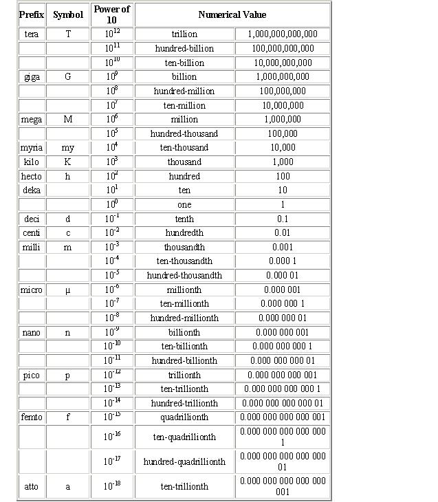

what does 200mW = 2W or 0.2W???
Someone posted this on the forums a while ago, sorry, I've forgotten who, but I always keep a copy on my desktop for those brain overheating moments😉

200mW = 200 milliwatts = 0.2 watts
which in most cases is not very much power
If you'd asked about 200MW, I'd be more concerned! 😉
little m = milli, or thousanths
Big M + mega, or million
Handy chart! I'm saving it, and printing out a copy to
hang up next to my Ohm's Law Wheel
--Damon, who isn't too big on math either
