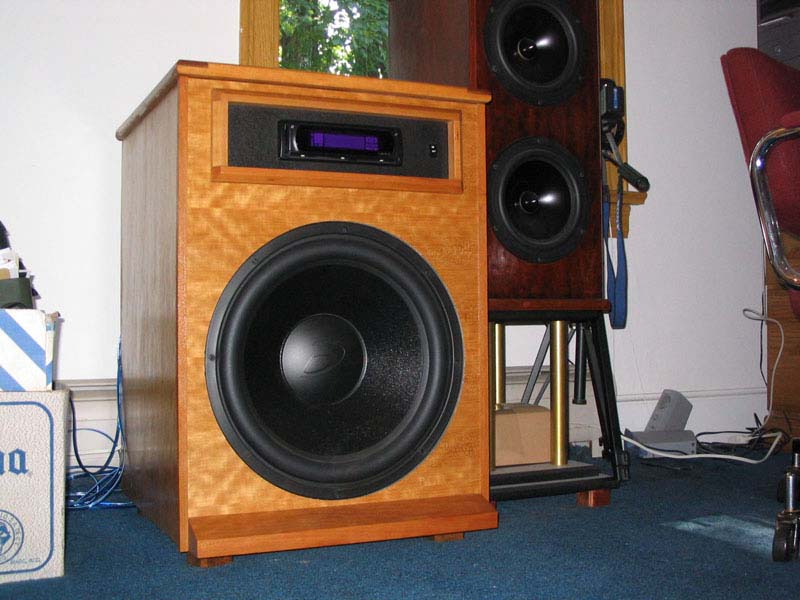

For "Dburc59866"
Here's a subwoofer for you....Powered by a Sony car stereo(Pre-amp outputs...custom amplifier 600watts.. RC
