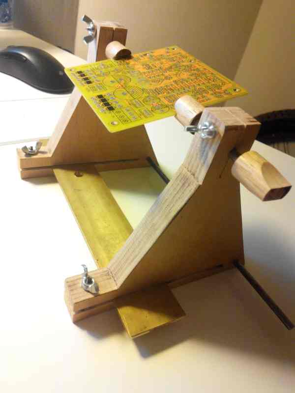

I'll use a Panavise board holder if I'm desoldering and need to use a soldering iron on one side of the board and a solder sucker on the other side.

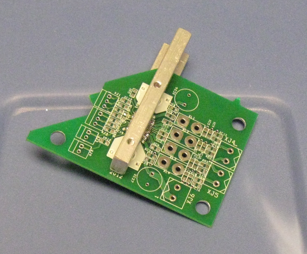

I use painters tape & small steel blocks to hold things in place. I also knock off the back pole piece of blown speakers for weights and knock off the maqnet which holds all the screws when repairing. A good set of reading glassses help. Of course I'm reading this thread to see what everybody else is doing.... I don't have any local soldering buddies...
I like it. I might try to devise a holder for the third side of the board, just using a rubber pad and spring tension.
