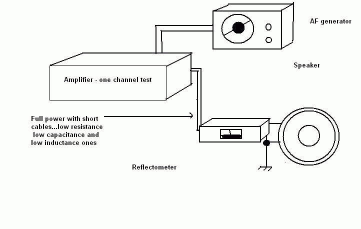

destroyer X said:
If you like to check those crazy things, produce a reflectometer...the same used to Radio Frequency, and check the return patch...adjust zero the going signal to full pointer deflection and observe what will return.....the return is a visual information about the mismatch you have.
regards,
Carlos
Very interesting, Carlos.
I know you have practical real experiences from some areas (high freq, RF radio techniques )
that others may not have (Lineup and such persons ).
A reflectometer, I guess is something what is commonly used
for Tuning Antennas - can be Receiver or Transmitter antenna.
I do not know if I am right ....
So what you are telling is, we can use something similar, or even one of those boxes,
to see what happens in between the Amplifier Output and Loudspeaker Input.
I say again:
INTERESTING
Christmas - in north and south
Christmas - in Brasil and North Europe
under same sky
--- your lineup ----
