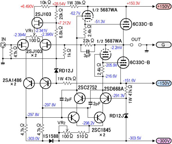

Now that finals are over I am looking for a tube amp project. I need something with at least 20 watts (mainly because I cant afford anything with much more power). This poses a challenge as my speakers are magnepan MMGs, they are a bit inefficient and they are 4 ohms. I have an output trafo which is 20w with a 6K6 primary, it would be great to find an amp which I could use it in maybe a 6L6.
I was searching and found the OLT amp which I attached below. It came from the Evolve Amplifiers web site. It looks nice and simple, it might be a bit costly bit I think I might just take the risk.
The big question is will it be able to handle my MMGs?

No way would that OTL amp drive a Maggie MMG! You'd need at least 3 sections of 6C33 in parallel to get anything like enough current to drive an inefficient 4Ohm speaker.
Ouch! He's right, OTL is the worst way to go, unless you want something huge, inefficient, and expensive. And one which will be frightfully difficult to make reliable.
You've got 6.6K transformers. Those are perfect for 6L6 or EL34. That will still be pretty marginal power for MMGs- you really need at least 100W to make them sing, unless all the music you listen to has compressed dynamic range.

Hello all,
I agree with DigitalJunkie. A small tube amp can make maggies sing but just not at very high levels. I plan to make a UCD400/700 amp for the maggies anyway, I just want to jump into the tube world. The main reason for going with tubes is that there has been a lot of noise on AA about how good maggies sound with tube amps, even small ones (sacrificing high SPL of course).
So with that I, have attached the amp that I am going to build. It seems a bit old, does anyone have any ideas of how to improve the circuit or is it fine as it is?
I also plan to use KT66 instead of the 6L6 (if my wallet allows).
