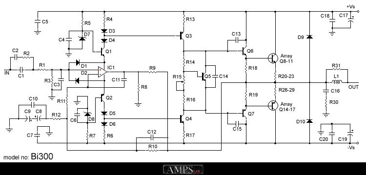

The series of post by MikeK left me with the impression that he might follow up with more detail. Perhaps he was a bit pressed for time, but the observations make some claims that many might dispute. As these threads go, they usually greatly expand in detail and discourse before closing.
From mikek;
"A three gain-stage design. The final gain stage is notorious for quiescent current instability.
Outside of a configuration with gain in the output stage, i cannot conceive of any circumstances in which three gain stages are necessary, or required."
"if the published distortion figures are good and it doesn't 'sound' right, then it's not being measured right..."
And in his response to:
........one of the designers aims was to get lowest THD, remember it was 86 and that was everything back then.
"...it still is everything really, or should be......."
These post left me with the impression that he might follow up with more detail on very brief but seemingly quite strongly held opinions. They would seem to be intended to provoke further discussion. Perhaps he was a bit pressed for time, but the observations make some claims that many might dispute and can't be his last word on this topics so lightly touched on.
I am puzzled by the stated goal of low distortion while rejecting three stages of voltage gain as unnecessary. The higher open loop gain would generally result in lower measured distortion due to the increase in loop feedback. Rejection of a topology that would likely result in lower distortion, seems in direct conflict with the last two statements. Surly there is more to come to clarify this paradox.......
Even more puzzling is the rejection of this topology after advocating the Marantz PM-17 (proof of concept implies approval I think) which has three voltage gain stages and a triple emitter follower, an output stage with no voltage gain! This would appear to be at least a first cousin to the rejected topology refered to in the first post.
http://www.diyaudio.com/forums/showthread.php?postid=192255#post192255
Am I the only one confused by these seemingly contradictory post ?
In post # 118 of Output stages with gain Enhance Slew rate
http://www.diyaudio.com/forums/showthread.php?postid=191570#post191570
You offer up the design below.
The op amp is usually at least 2 voltage gain stages. The conversion of the op amp output current to a voltage by Q1 and Q2 which is a voltage gain stage with the voltage across R8 as the input single. Whether this is a voltage gain stage greater than depends on the ratio between R8 and R4, R6. The contributions of additional poles and distortion from the op amp output stage driving R8 as well as the contributions of Q1 and Q2 would still be similar to a typical voltage gain stage even in the case of an output voltage gain less than unity. One could certainly not pass it off as a follower even in that case. The distortion contribution from the op amp follower op amp stage are well know and the use of in loop buffers becoming very common to minimize this problem.
So now we are left with an amplifier with a least FOUR voltage gain stages and an emitter follower output stage with no voltage gain. Doesn't this conflict sharply with the statement about three gain stages made in this thread in criticism of the initial design under scrutiny? In the US we have an old routine of asking the victim of a blow to the head "How many fingers am I holding up?" to access his mental state and the medical severity of the impact to there brain. Along the same line of concern may I ask, "How many gain stages am I holding up?"
Thanks for your attention in this matter,
Fred
In view of the brevity of my observations made earlier in the thread, Nelson's objections may, prima facie, appear valid. However, any reservations held in this regard will now be shown to be illusory.
'Higher open loop gain' is of itself entirely meaningless, unless and untill we define with precision at what frequency and/or bandwidth this worthy quantity is being sustained.
This is because, in the interest of stability, a 'higher' open loop gain, (presumably at DC), cannot be sustained indefinitely.
In other words, the higher the open loop gain, the heavier the compensation required for the same stability margins.......you are then proverbialy back to square one.
Of greater relevance, is the quantity of open-loop gain at a defined frequency, (say 20KHz), that can be safely accommodated without compromising the systems stability.
In broad terms, using three gain stages with a view to generating higher open loop gain, and therefore lower distortion is fallacious, precisely because the extra gain comes at the expense of additional poles contributed by the extra gain stage, which now have to be compensated for........taking you nicely back to square one!!
In other words, your compensation will have to be more rigorous, probably resulting in less loop gain at 20KHz than you otherwise might have with a two gain stage design......ergo more distortion at HF than the usuall two stage approach...the mother of all electronic ironies n'est pas?!!

Re: Fred D who are you asking for measurement details from, sorry i don't understand
To continue NP=FD(?),
....that is not to say that a triple gain-stage amp., as shown at the beginning of this thread, cannot be improved upon by employing unusual compensation.
Nested miller compensation is an obvious example, probably supplemented by feedfoward compensation, to by-pass one of the gain stage at HF.....but this would intoduce pole-zero doublets
before the systems transition freq., making for profoundly mediocre settling time...etc..etc...
incidentally, this is probably why no figures for settling time are given for the lm118.... :scratch2:
The following is i've found, a usefull precursor to comprehending nested compensation...
http://patimg1.uspto.gov/.piw?Docid...ageNum=&Rtype=&SectionNum=&idkey=B17B52FDAF72
....tiff viewer required....
Nevertheless, i am satisfied there is no pressing need for a three gain-stage design for the sole purpose of reducing distortion in linear audio power amps.

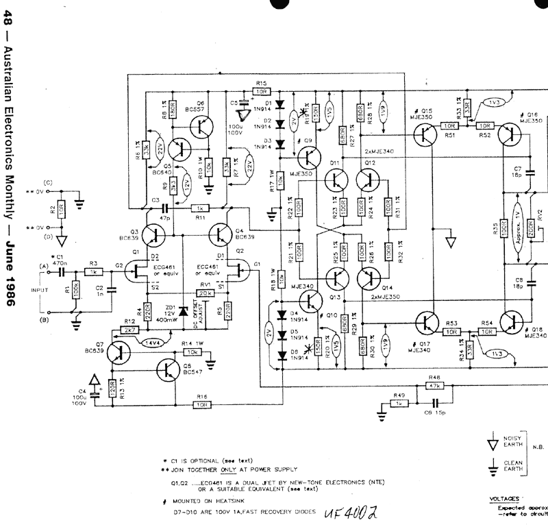

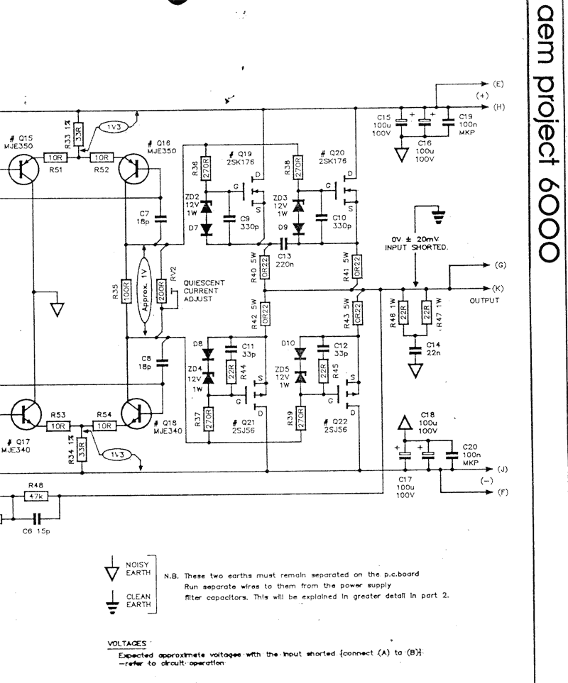

I give up
Can't believe how long I have spent on this. I can't get a better quality image that will post, If I get the image down to 100k it is still bigger than the 800x1200 format (can't work that one out), zipping doesn't do much at all. If anyone wants a better quality jpeg or tif or GIF or pdf email me & I will send from work in the next day or two (I only have dialup at home).
A couple of points re my amp compared to the schematic.
I run 3 pairs of mosfets on the output. The reason for this is when i was starting construction i got my old Nakamichi tapedeck (remember those?) serviced and got talking to the techie who said mosfet output stages are great but you need to parallel lots to lower the output impedance. so I thought this guy knows lots more than me (not terribly difficult I admit) so lets put an extra set of mosfets in there. In the text for the amp project Tilbrook talked about adjusting the value of R19 & 20 for users who wished to use different numbers of output devices, 150R, 220R & 270R. 220R was for 2 sets as schematic, the 150R shown in the schematic was actuallyan error listed in accompanying errata. I assumed 150R to be correct for 3 sets of output devices.
The Silicon Chip Ultra LD amp that so dissapointed me did have a positive outcome of sorts. That design uses a seperate regulated supply for input & VAS and the I thought they produced a nice tidy circuit capable of handling decent rail voltages for which PCB's are available. It was altogether to tempting for a tinkerer like me so I made a couple and tweaked the values of parts to produce arail voltage about 2.5v (a researched guess, any comments) higher than the 75 required by the output stage, hacked the PCBs of the amps to seperate the supplies and to my constant amazement nothing blew-up or failed to perform.
The improvement was significant though I have to admit i also replaced all 'lytics on the amp boards with panasonic FC's and bypassed the decouplers with MKP's (more tinkering) at the same time so what did what is a mystery.
Funny thing also i run max bias and the heatsink temp dropped a little after this mod (someone going to tell me it was oscillating(break my heart!))
