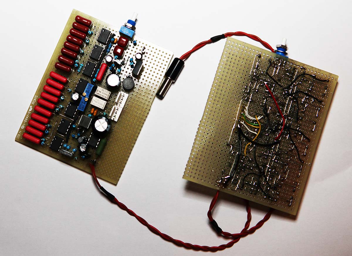

Who makes and where do I get a single ended 3-way stereo active crossover?
DT
Either you build yourself, like this set I recently finished and now is in the testing phase.
Or you buy two MiniDSP's for I think 100 USD each, and you are all set and done. You need the MiniDSP´s anyways to establish xover points, slopes and what have you before building an analog homologue.
The benefits of an analog filter over a MiniDSP are better distortion, lower noise, better gain structure and no latency, but for playing music, the MiniDSP is more than good enough.
