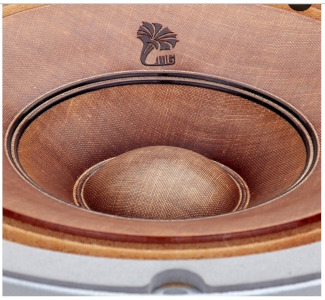

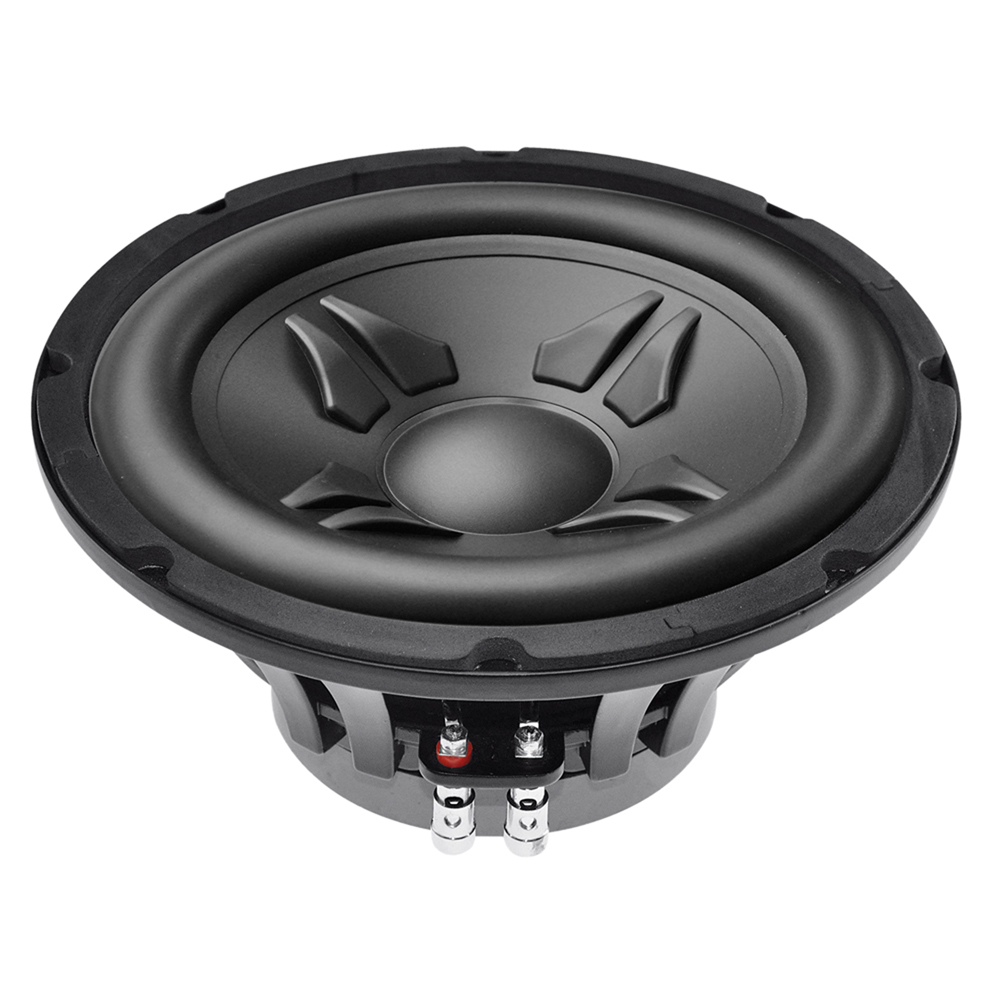

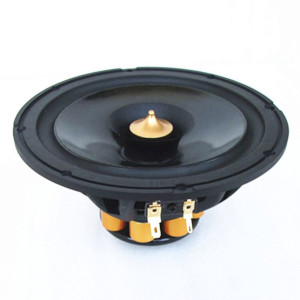

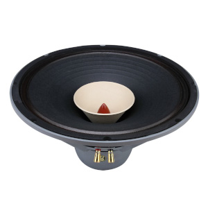

Dual cone angle, grooves in the middle (pseudo surround ?), varying cone thickness, at the top much thicker...separate parts of the cone radially vibrates differently creating different sound waves, even the dome in the middle (dust cap). One example below. Few more are out there...
I fear we are in danger of falling off the edge, TNT! Who knows what lies beyond?Why are we discussing this. Flatearthers?
Watch an easy to buy full range speaker making music. How the cone distorts on its surface. How the shiny cone in the middle tweets, without moving.
