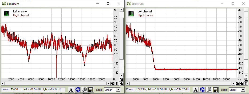

To illustrate Marcel's sound tracks with spectra, this is how they look like.The only way to really find out what a NOS DAC with only zero order hold reconstruction sounds like to a cat is to die, reincarnate as a cat and find personnel with such a DAC, but as an experiment to get a first impression, I've scaled everything by two octaves.
The attached zip contains a 10 second music excerpt band limited to 5 kHz, this is roughly what an OS DAC playing 44.1 kHz sample rate audio should sound like to a cat (two octaves too little on the treble side).
The other has the band-limited signal subsampled at 11025 Hz and all samples repeated four times. This is roughly what a NOS DAC playing 44.1 kHz sample rate audio should sound like to a cat (two octaves too little on the treble side and spectral copies).
Listening to these files, I think the reason why NOS DACs without reconstruction filter sound acceptable to humans is precisely that we can't hear the images.
It's obvious that the left 11.025Khz NOS Dac spectrum sounds terrible because up to our hearing limit of at least 18Khz we have already two images of which one is even reversed.
The spectrum at the right representing the output of an 4 times OS Dac at 44.1Khz of the same file is clean up to 20Khz.

Just to illustrate how subjective the listening impressions are, those two files sound indistinguishable to me.To illustrate Marcel's sound tracks with spectra, this is how they look like.
Hans
