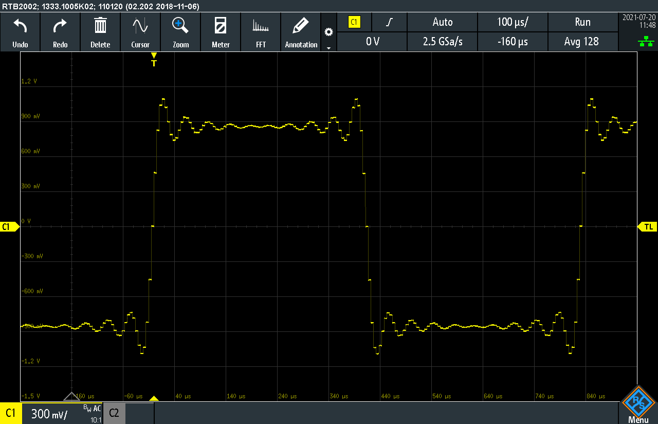

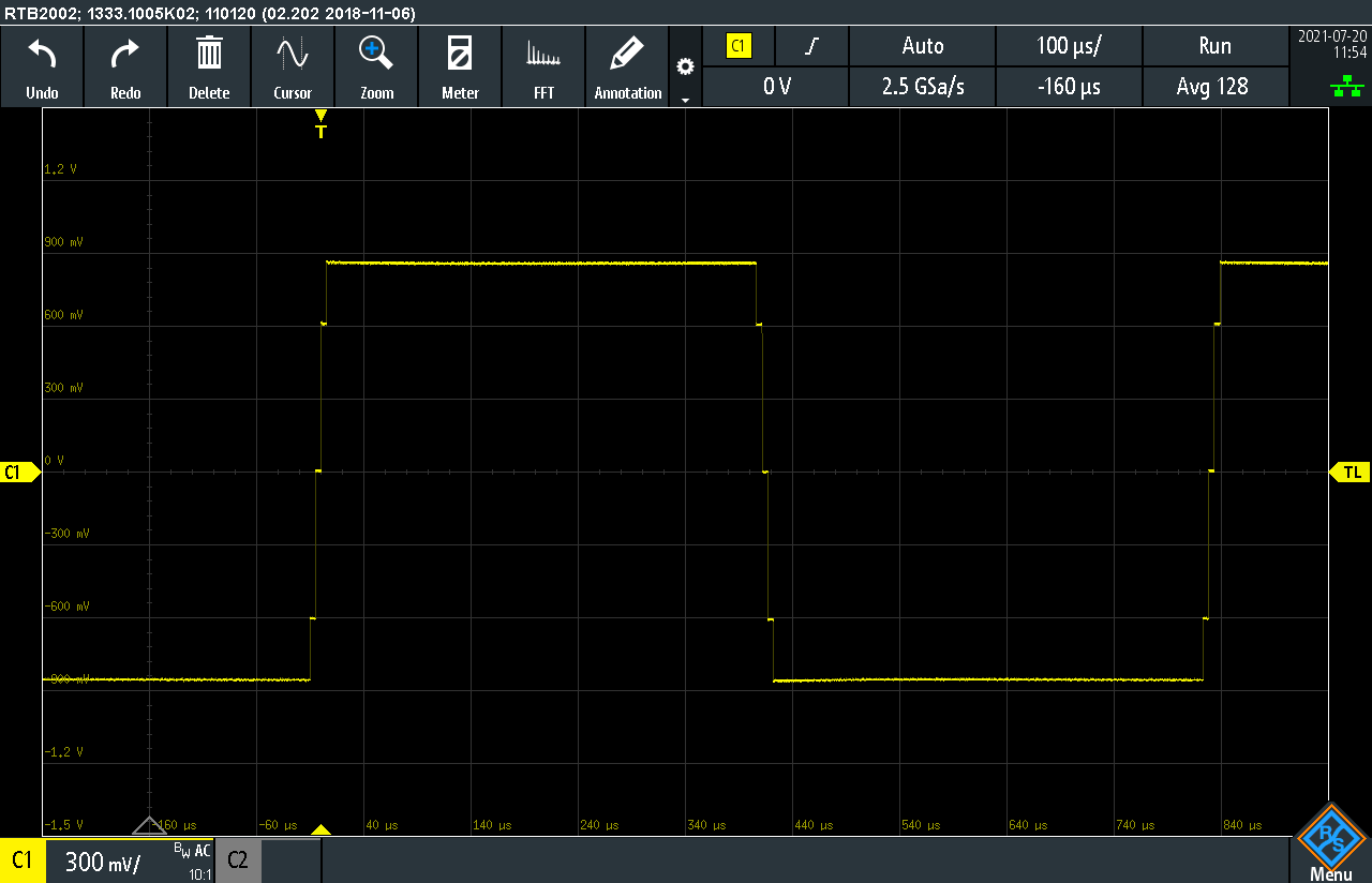

I will keep it short, as reactions were zero last time, but may be still interesting for the conclusions from Ken – if not just say so, I will back off 😀
I listened to original 44.1 kHz tracks and compared on the fly (Roon and HQPlayer allows for that) to upsampled /filtered versions FSx4 (176.4kHz) – by doing this the PCM1794 modulator runs 4x faster
Hardware: DDDAC1794 in no filter mode – OPT output – FiFoPi with Accusilicon XO clocks
Start: No filtering, no upsampling
First: Roon with normal FIR Filter
Second: HQP with FIR Filter
Third: HQP with Polynominal-1 Filter (See old post – VERY close to sample and hold filter)
Listening compared to Start situation:
First: uninspiring is the word. It just misses the freshness and directness of the start version
Second: Now HQP does the FIR better. The uninspiring level is much less as in First
Third: Now we are talking. It sounds almost the same in terms of typical NOS sound. Almost, very close… probably not able to hear this “the next day without knowing what plays”
BUT… On a positive, for all voices and air instruments sound just a bit cleaner – same effect when mains power is cleaned up – This is for a sure a small PRO
All having said so…. The differences are small between start and third and I will need to listen further if I would like to have this now standard in my reproduction chain or not. Both Start and Third has pro and cons (so far in my ears)

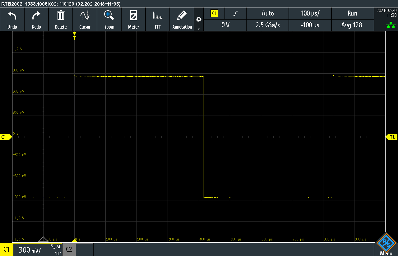

HQ Player NOS Test - Square Wave 1200Hz FS48 - No Filter.png24.5 KB · Views: 236
HQ Player NOS Test - Square Wave 1200Hz FS48 - FIR Filter.png31.2 KB · Views: 226
HQ Player NOS Test - Square Wave 1200Hz FS48 - Polynominal-1 Filter.png26.3 KB · Views: 244

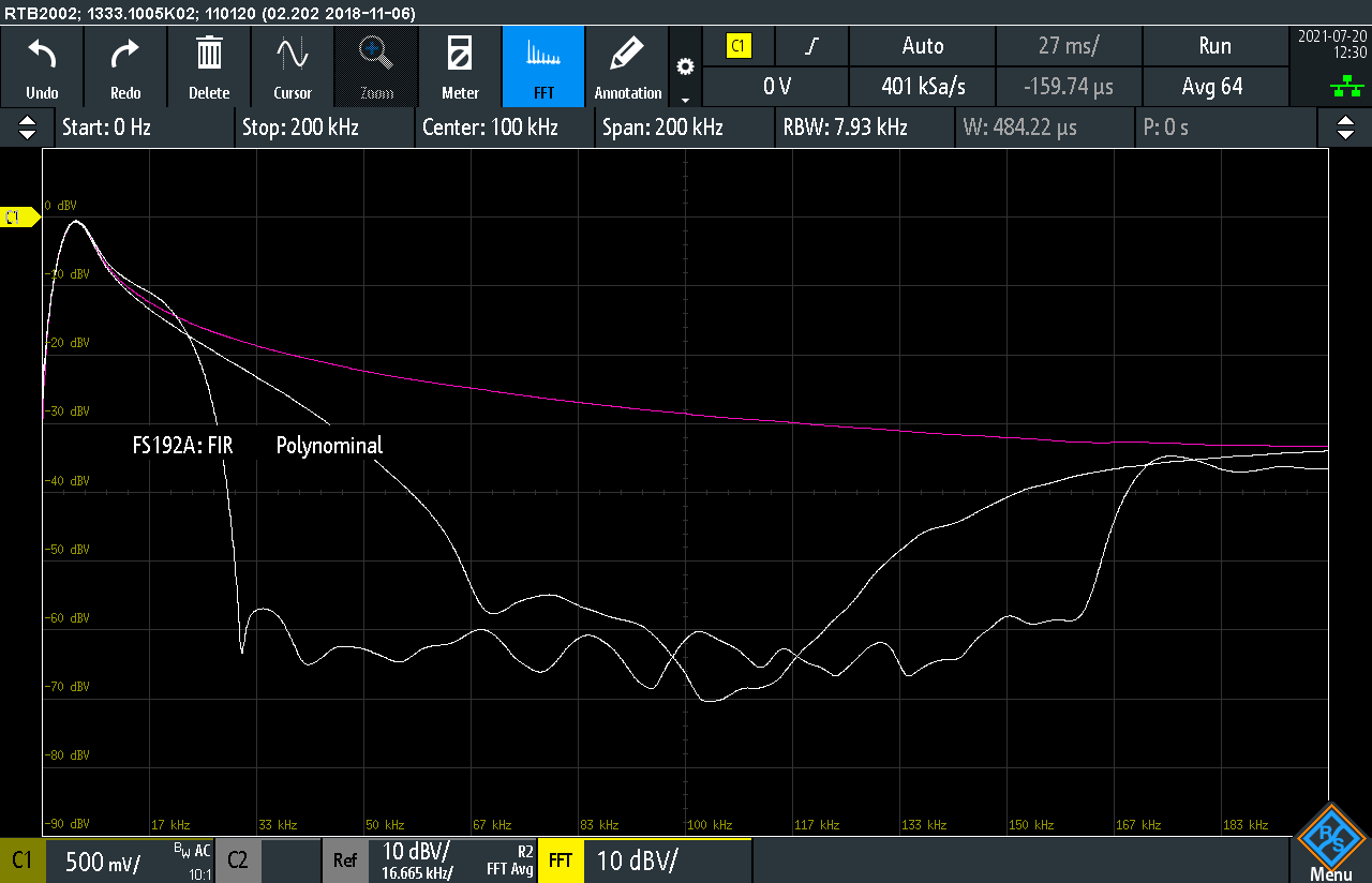

A question: The far right photo appears to show the frequency-response of the filter options. Why do they all appear to be not flat below 20KHz?
Almost Ken. thanks for your summary. I would not even call it inferior… The third in my ears is very close to typical NOS, with the extra pro (likely only as I use a pcm1794 in NO Filter mode with BCK driven Modulator) that the sound is a bit cleaner, (thanks the 4x higher BCK) hence I wrote that I am bit torn apart, what I would like more eventually….
On your question, this is not a frequency response, it is the FFT of a square wave… hence the falling curve. I wanted to have a lot of harmonics and their resulting noise effects
A "good" square wave contains a not ending equal level of HF. Is that what you want out of a DAC?
The PCM theorem don't work like this. It's ignorance to think that a good looking square wave is something good - its not, in context of PCM, its a sign of a broken, faulty reproduction mechanism.
Your lack of understanding really shows when you associate a "perfect" square wave with "NOS sound".... sound?

Why not do an experiment like:
PCM, Fs: 2ksps, 16bit, stereo.
a) Replay: 950Hz FIR filter, down -120dB at 999 Hz, (64ggr OS).
b) Replay: No filter (NOS!!) for a perfect square wave 😉
Record this with 24/96 with a good ADC and post the files.
Listen...
Listen...

Maybe you can explain what you don’t like when NOS Dac produces a analoque square wave from a digital version.
A digital square wave can never be recorded that way and only serves to prove that it is indeed a NOS Dac.

The hardware solution probably has its limitations.
It measures very nicely though (But that is not what we are after, right ?)
Sure the theorem is correct, yet from my understanding there must exist some mechanism that converts the HF spectrum back down into the audio spectrum for that to subjectively relevant. Furthermore, whatever mechanism is used in the digital domain to manipulate numbers the outcome is still a new set of numbers containing an infinite spectrum you suggest. Hence taking your perspective there isn't anything digital that isn't broken. Finally, if filtering of a square wave is perfectly done in the analog domain how is it variant from its digital counterpart?
TNT, dddac is just measuring the step responses of various filters to reverse-engineer what they do.
In principle a zero-order hold is almost the worst filter you can think of, with their roll-off in the audio band and lots of barely suppressed images, which is why it is peculiar that many people like their sound anyway. Hence this whole thread to figure out why.
