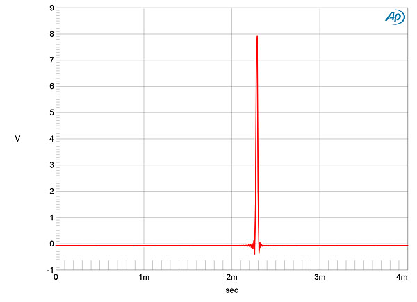

Holo Audio as Stereophile May test reveal, always deploy digital filtering and filter is set to 20kHz no matter of incoming sample rate, which is only aimed for better measurements. It is why there is no many NOS fans (very expensive brands get no many customers), even in the DIY community NOS is a rare case. However everybody points out that NOS sounds different. Why? It is still not known.

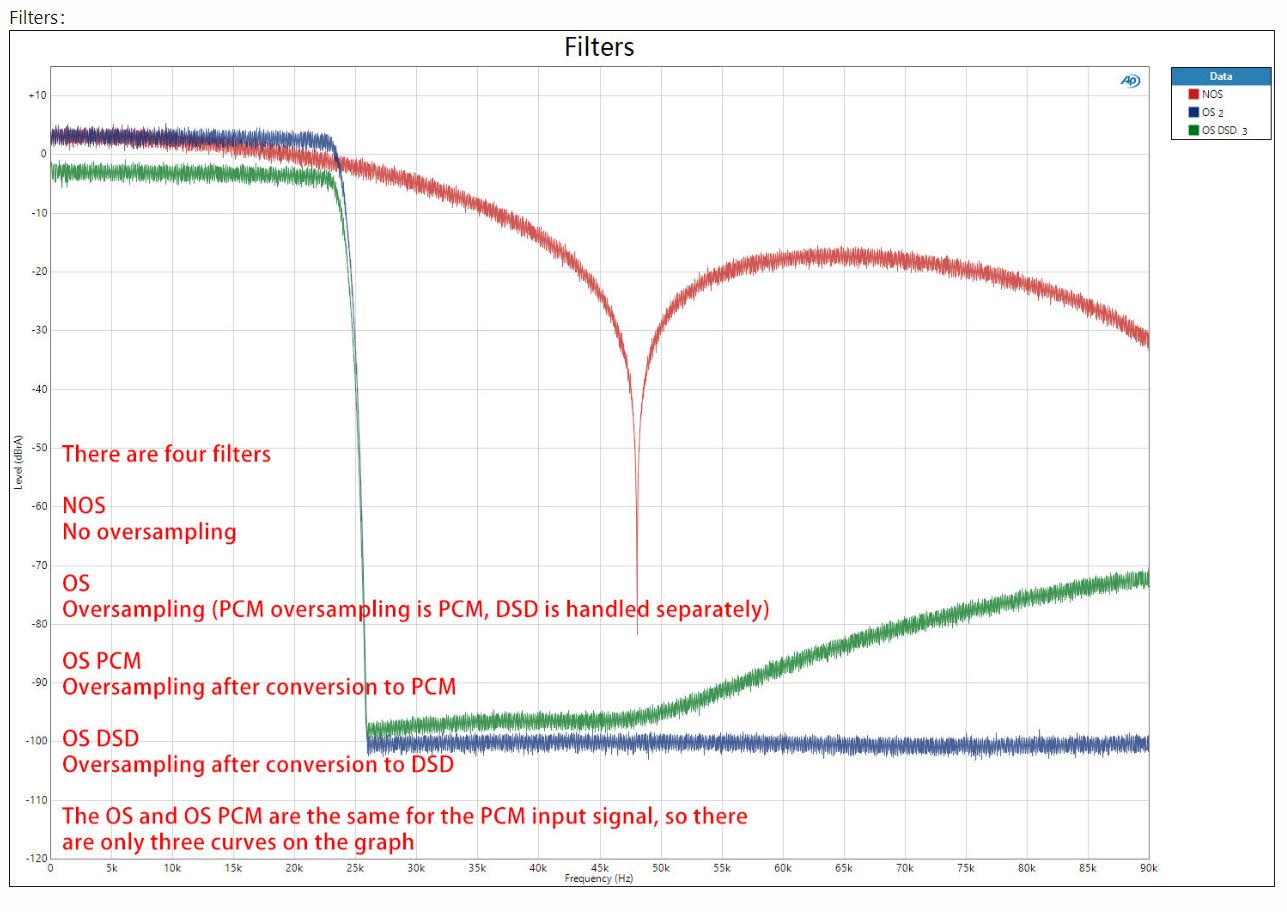

Have a look at the NOS filter response, as measured by AudioScienceReview member WolfX-700, and as per May's developer suggestion. I don't know what happened with the Stereophile's measurements, but I can confirm that the NOS filter response with May DAC Level 2 (which is the model and revision that I have) is as per my attachment (as per WolfX-700 measurements).
Refering to Audio-pseudo-science-review is a sin. They frequently attempt to hide deficiencies of a sponsor brands like Topping/MSI, now Holo Audio. Look at the first graph, pulse response has pre- and post-ringing.
Fig.1 HoloAudio May, NOS mode, impulse response (one sample at 0dBFS, 44.1kHz sampling, 4ms time window).
This plot shows filtering at 41.1k and higher frequencies. Stereophile test sample is not bandwith limited, where filtering of higher frequencies comes from?

They also use digital error randomisation technique which inevitably result in modulating audio frequencies. Users report hearing something like sea-waves correlated with music.

The pre- and post-ringing comes from the anti-aliasing filter of the Audio Precision analyser, according to your link. I haven't a clue why they have that much roll-off at sample rates of 96 kHz and above in NOS mode.
Yeah, I read that review and saw the caveat around ringing...
By the way, the Stereophile and Audisciencereview measured filters' plot is almost identical for NOS; they just measured at different white noise levels.

It is what you were told. Attkinson dropped a ball there, perhaps being under pressure. If it is true, then why ringing do not show in other his tests?The pre- and post-ringing comes from the anti-aliasing filter of the Audio Precision analyser, according to your link. I haven't a clue why they have that much roll-off at sample rates of 96 kHz and above in NOS mode.
They perhaps use double resampling, digital filtering with noise shaping during upsampling, then downsampling back to 44.1k. How otherwise they were able to achieve so low SNR figures? They need noise shaping to achieve it.
