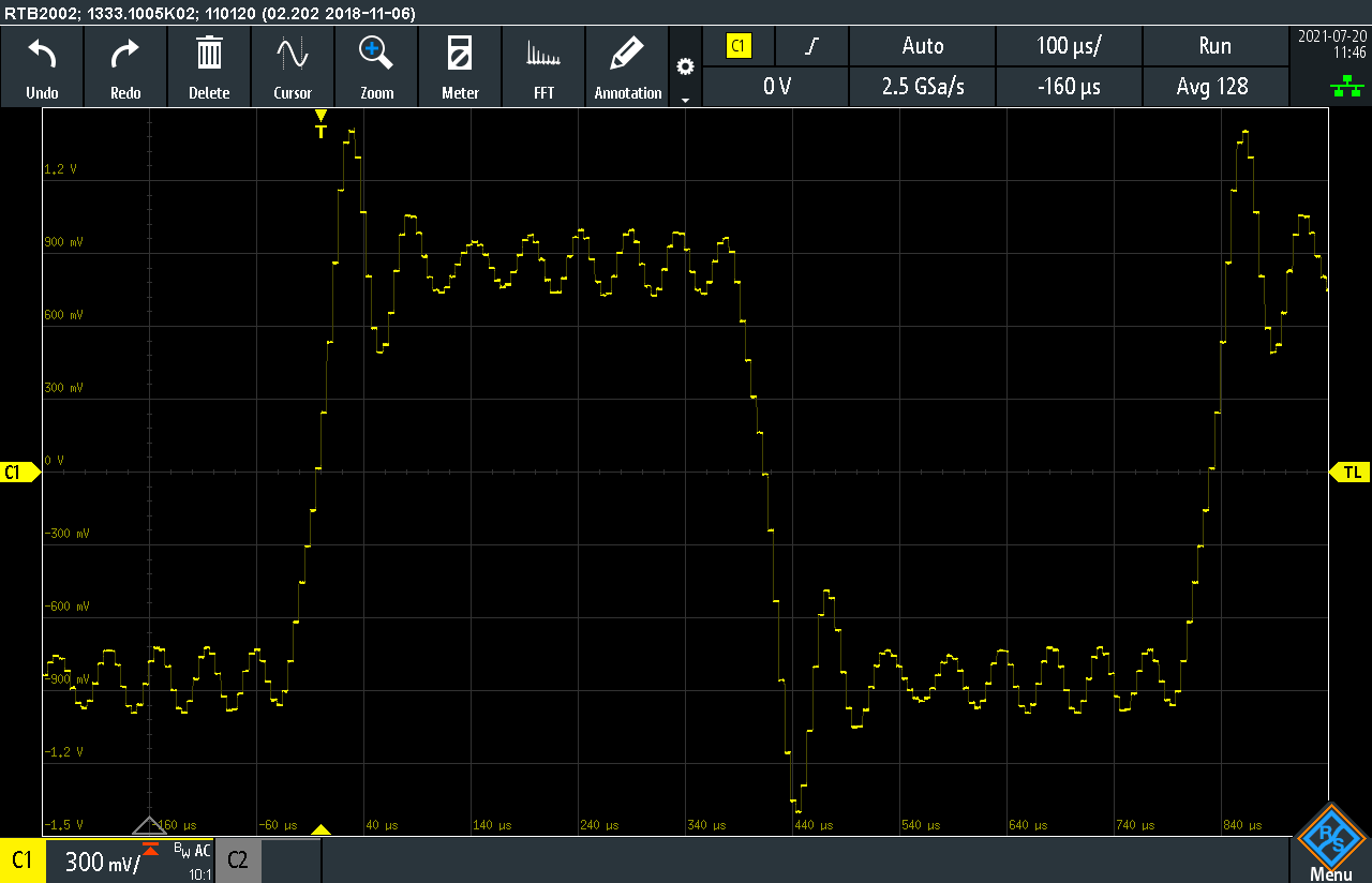

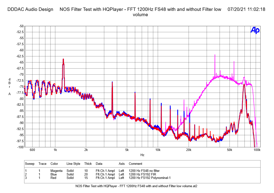

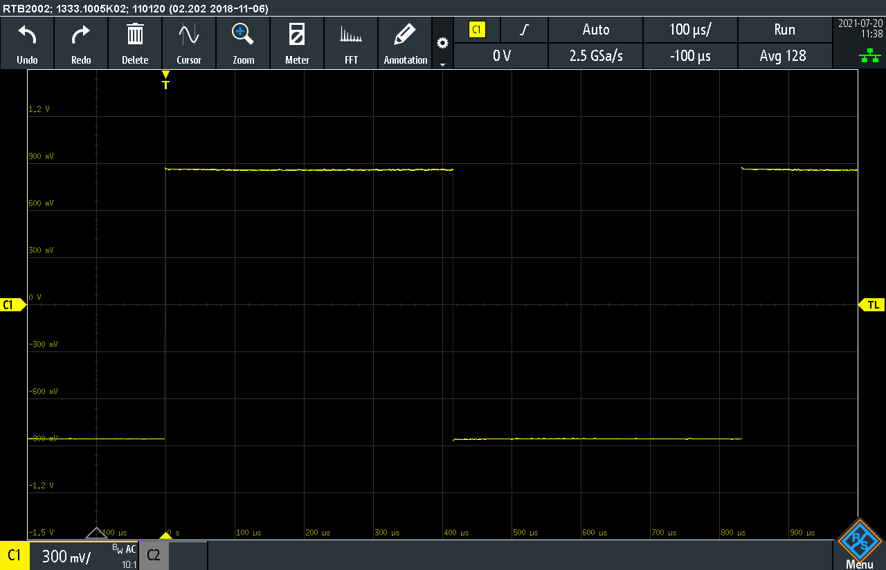

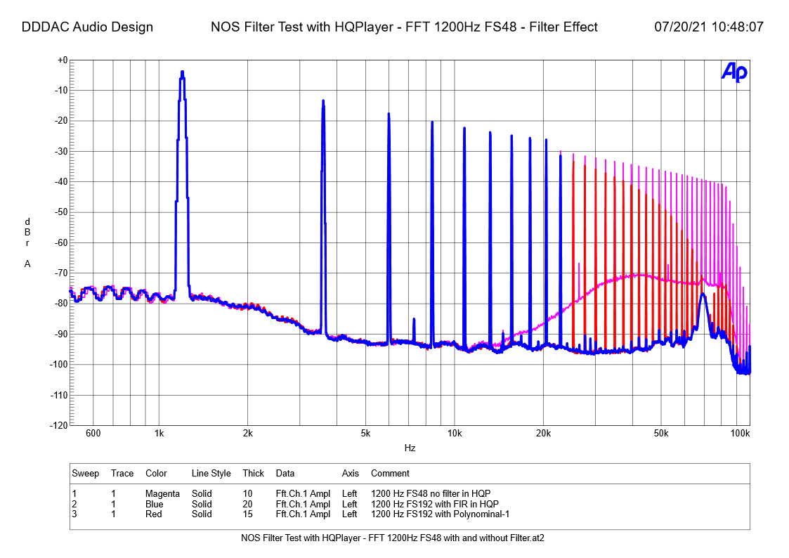

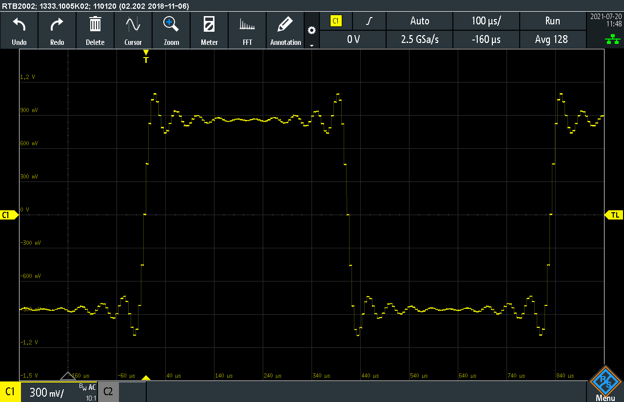

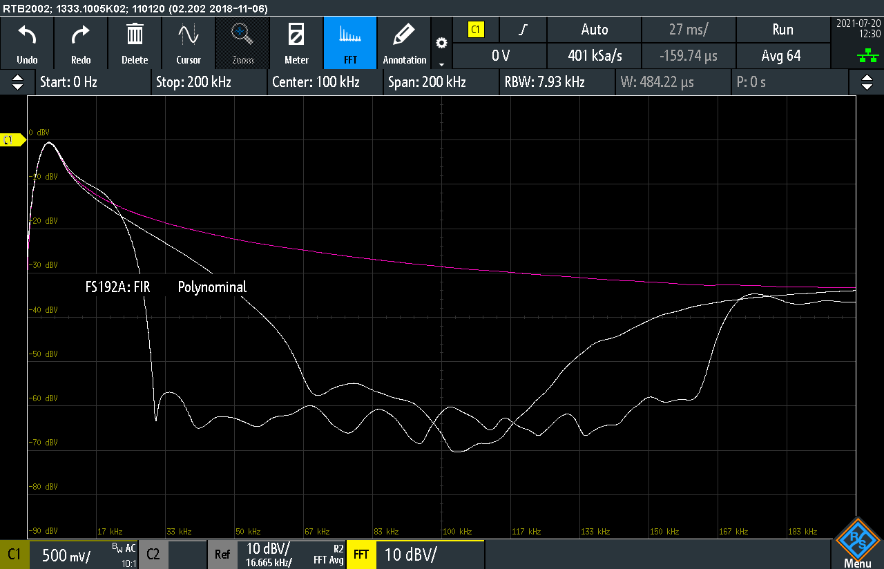

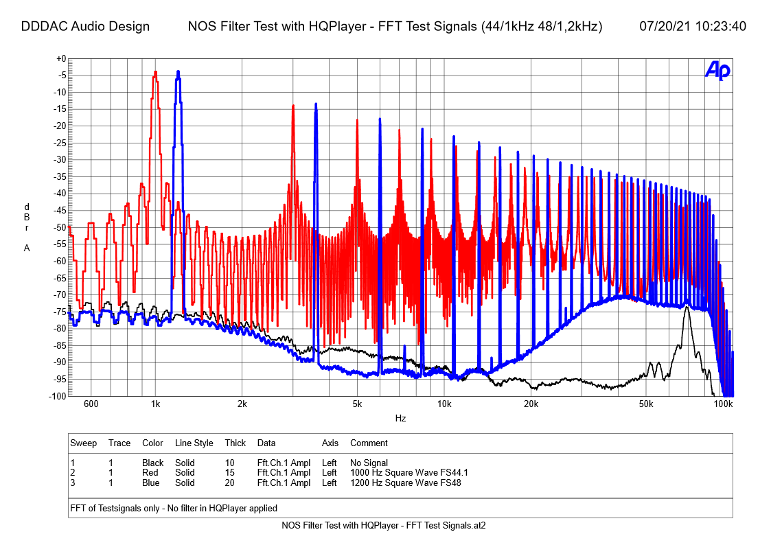

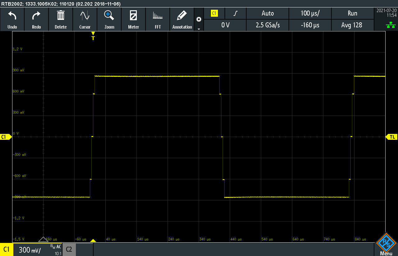

HQPlayer NOS Signal test
As always, took more time than expected to do this orderly...
No time for text, but the "ones who know" will be able to read this and draw conclusions 😛
I will write to this later today or tomorrow
HQ Player NOS Test - Square Wave 1200Hz FS48 - No Filter.png24.5 KB · Views: 291
HQ Player NOS Test - Square Wave 1200Hz FS48 - IIR Filter.png32.8 KB · Views: 294
HQ Player NOS Test - Square Wave 1200Hz FS48 - FIR Filter.png31.2 KB · Views: 296
HQ Player NOS Test - Square Wave 1200Hz FS48 - Polynominal-1 Filter.png26.3 KB · Views: 301
NOS Filter Test with HQPlayer - FFT 1200Hz FS48 with and without Filter low volume.png109.2 KB · Views: 299
NOS Filter Test with HQPlayer - FFT Test Signals (44-1kHz 48-1,2kHz) - No filter applied in HQP.png136.3 KB · Views: 164
NOS Filter Test with HQPlayer - FFT 1200Hz FS48 - Filter Effect.png91.2 KB · Views: 152
