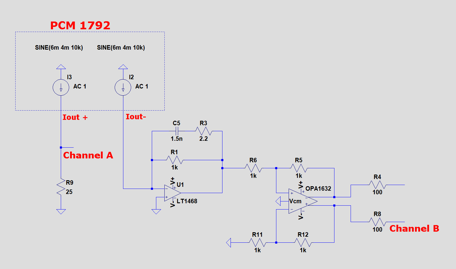

I did not simulate, but I measured first before doing a sim at a later stage.
Measuring is more revealing, for which I used the circuit in the first image below.
Both channels from the Dac where used, Iout+ going to 50R//50R termination, and Iout- to the original circuit with LT1468.
The 2.2R in series with the 1.5nF used to be 10R and the only reason I could think of why Bel Canto inserted this was for stability reasons.
I lowered this to 2.2R and noticed no stability issues.

3) I used the the output from the OPA1632 with the same polarity as the signal on the 25R. but since it's second input is tied to gnd, gain is 0.5
Difference in LF gain between the two signals is now 1K*0.5/25R = 20
4) the 100R behind the OPA1632 in series with the scope's 8pF input has a BW of 200Mhz, so that won't influence the measurement.

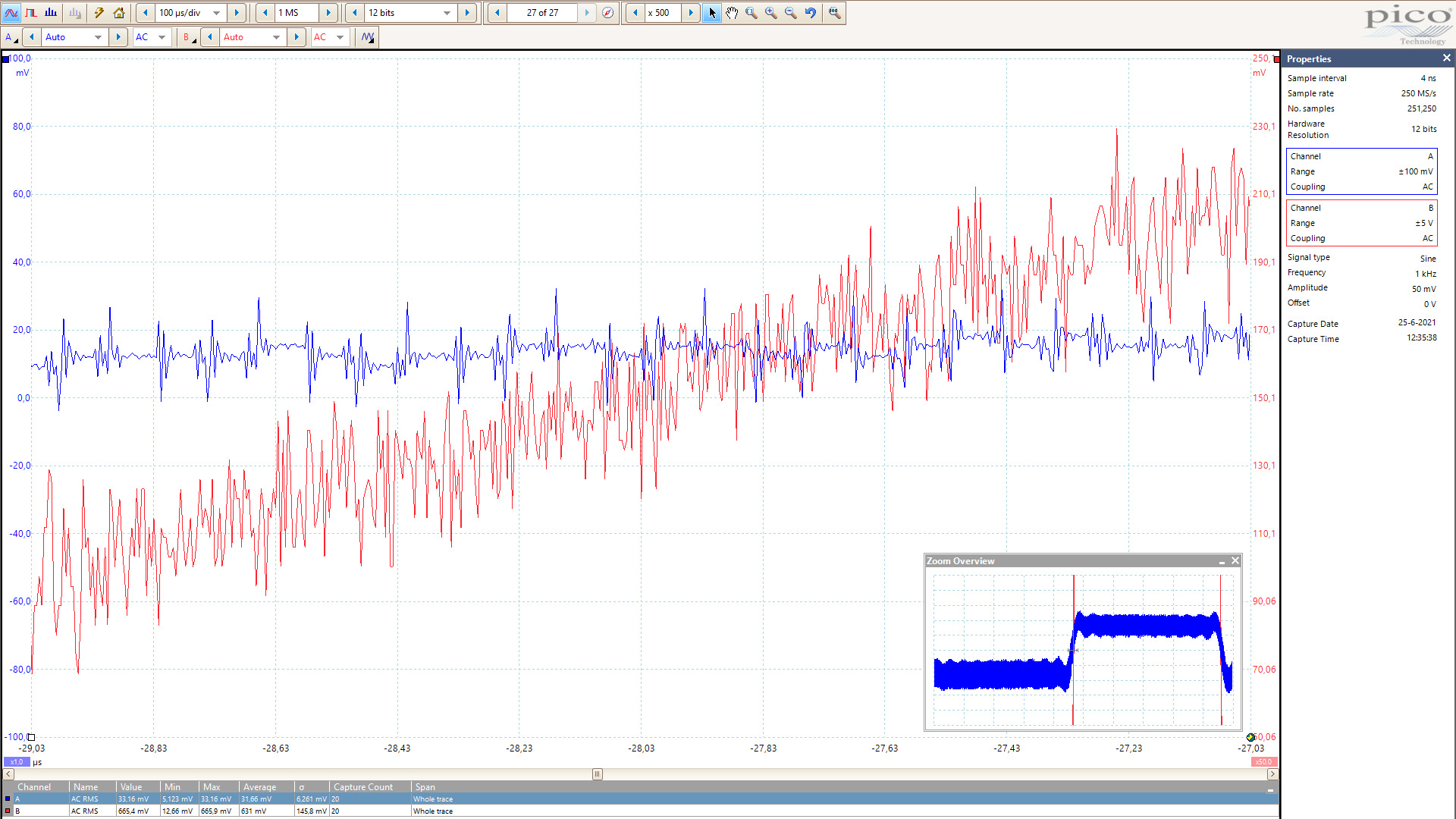

The second image shows the output to the scope's Channel A and Channel B for a 1Khz -12dBFs square wave, with both channels LF filtered @ 100Khz, proving the functioning as expected and with a gain of 20.
Thid image shows the same somewhat magnified in time, but now unfiltered.
Fourth image is magnified from a point in time on the upgoing slope, horizontally 200nsec/div and vertically both channels the same 20mV/div.
It is a bit hard to see, but the 200mV upwards slope in red, translates into 10mV over the 25R resistor in blue.

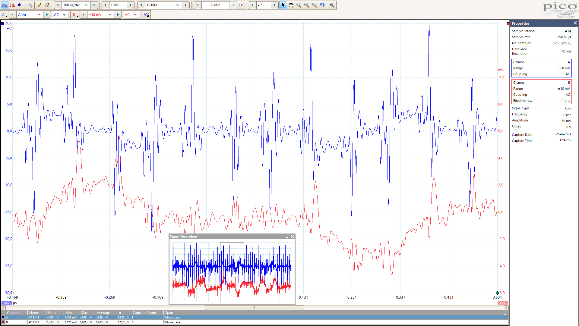

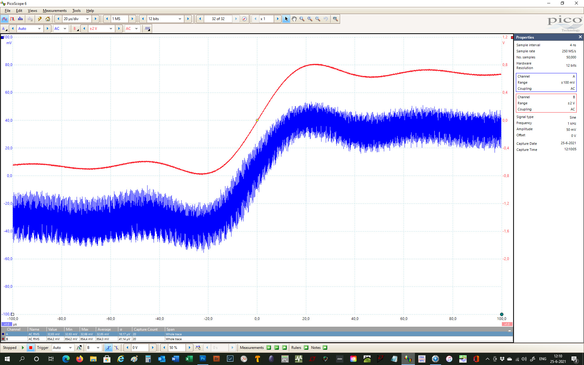

Fifth image shows the two output signals for a zero signal offered to the Dac , giving more resolution in the vertical axis of resp. 5mV/div for the 25R output side and 2mV/div for the LT1468 side as shown on a 100nsec/sec scale
The large almost +/-1mA nsec peaks on the 25R are hardly visible in the output of the I-V converter side.
But closer inspection of the signals between the large peaks each with a distance of 82nsec, shows a pattern that when the Dac takes one step down in this 82nsec period, that the I-V converter follows with a 200nsec halve sine wave downwards, and the same for one step upwards from the Dac.
Notice that this is the signal from the OPA1632 output, the signal on the LT1486 is twice as large, so still very small.
The step size on the 25R is ca. 2.5mV, translating in a 100uA resolution.
So my first impression is that the LT1468's input does not get overloaded by the 2nsec 1mA transients because it reacts almost immediately on a single 82nsec up and down step.
Hans
