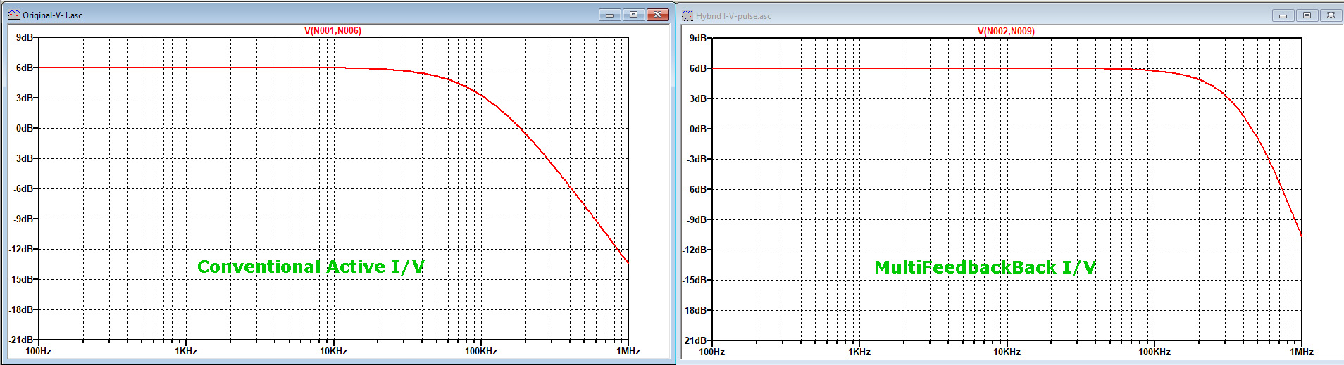

That is simple to explain.
The conventional I/V had it's -3dB point at 100Khz, whereas the MFB, being a second order filter has its -3dB point at 300Khz.
At 1Mhz both have roughly the same attenuation around -12dB.
And as discussed before, an LP filter has no effect on distortion whereas too low Slew Rate has.
So this difference in settling time can be disregarded.
As a matter of fact, in TI's most recent updated circuit diagram they also advise using 300Khz BW for the RC feedback network instead of the original 100Khz.
Hans

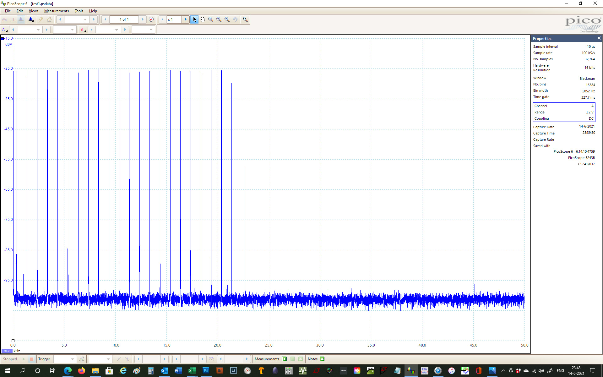

I did a multi tone test with the MFB I/V converter with tones spaced 1Khz apart.
I don't see anything spectacular, so there is seemingly nothing malfunctioning.
Noise level of the scope is -129dBV, well below the measured noise in this recording with a noise level slightly below -100dBV.
Hans

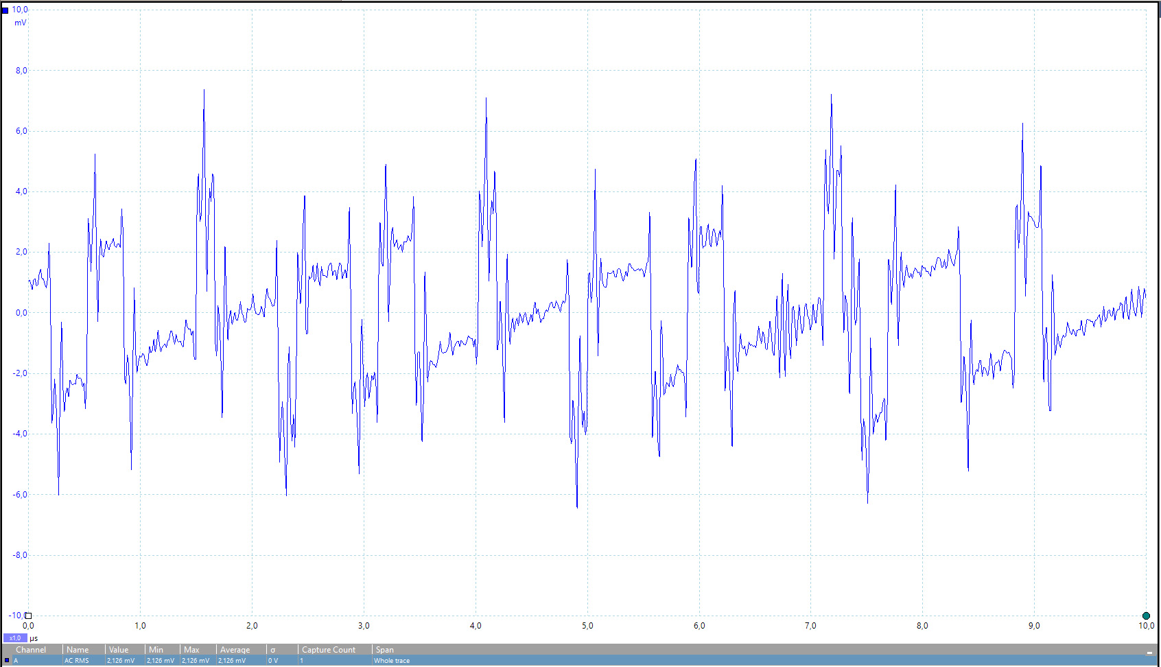

The deeper one goes, the more complex it becomes.
I should have known better, but I assumed that the PCM1792 was switching its output current at 1/192Khz intervals.
However the ΔΣ converter operates at a much higher frequency.
I offered a dithered 16bit zero signal to the Dac, while measuring at the output of the LT1468 I/V converter with only 1K/1nF filter across, followed by a HP461 amplifier.
In the image below showing the result, the scale has to be divided by 10 because of the HP461 and the used probe, giving a 220uV rms output signal.
As can be seen, the signal hovers around zero volt, not even at fixed switching moments, but when looking at the spectrum, the centre is at ca 1.2Mhz.
More to come.
Hans

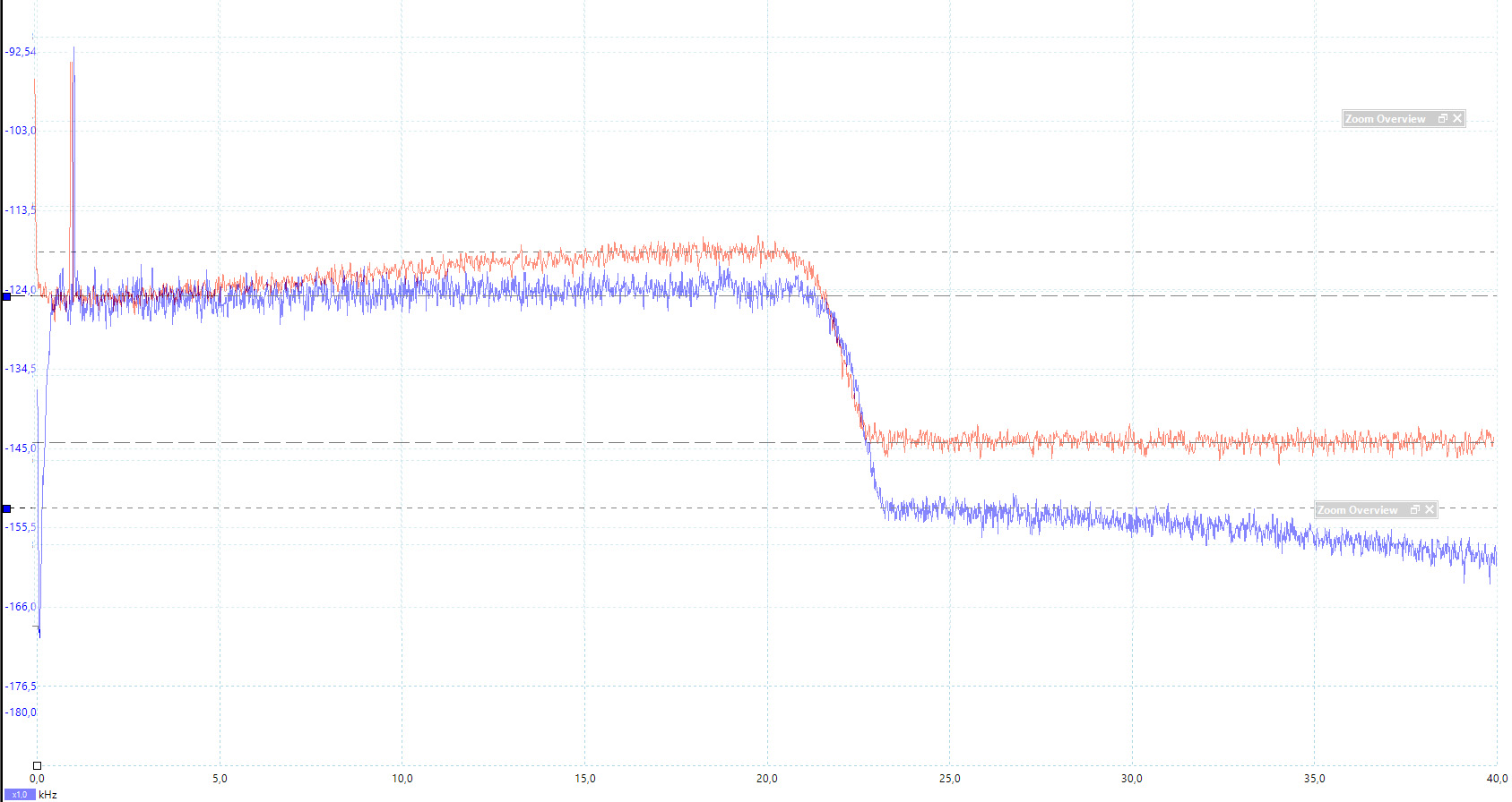

Here is the spectrum when offering a 1Khz -93.1dBFs 24bits dithered signal to the conventional active I/V converter in blue, versus the hybrid MFB version in red.
Obvious is that the noise production of the conventional version is superior.
At 200Khz the difference between the two is even 45dB.
It just seems that the current output does not like looking directly in the MFB's cap.

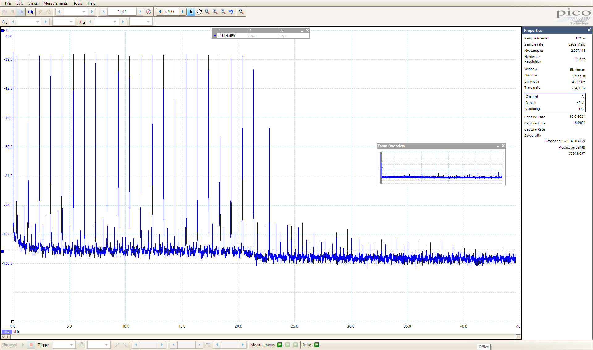

I also redid the multitone test, this time avoiding folding back of the very high noise from the MFB version.
And just like with the 1Khz test, noise beyond 20Khz stays on the same level instead of ramping down ??
Intermodulation products are now clearly visible.
Having added all of these experiences, I decided to go back to my original circuit diagram.
Hans
