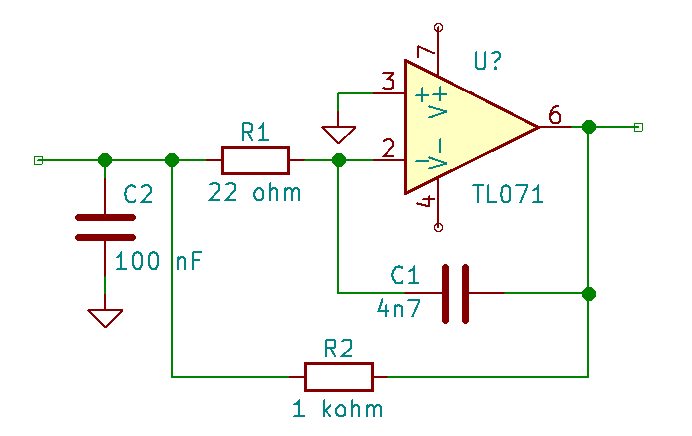

How about an MFB stage instead of either a passive I/V or a straight connection from the DAC to the op-amp?
I forgot to make the type number of the op-amp invisible, it can definitely be something fancier than a TL071.
When all components are ideal, the input impedance is that of an LRC parallel network with L = R1 R2 C1, R = R1//R2, C = C2.
Marcel,
That's a great idea.
I changed the values of the 100nF+4n7 into 9n+500pf to reduce the noise production from 5.4uV to 1.0uV for a single amp from 20Hz to 20Khz.
Not a big deal, but with the 100nF noise is rising exponentially above 20Khz.
Compare this to the conventional version that's producing 0.9uV for the same BW, but with a flat noise spectrum above 100Hz.

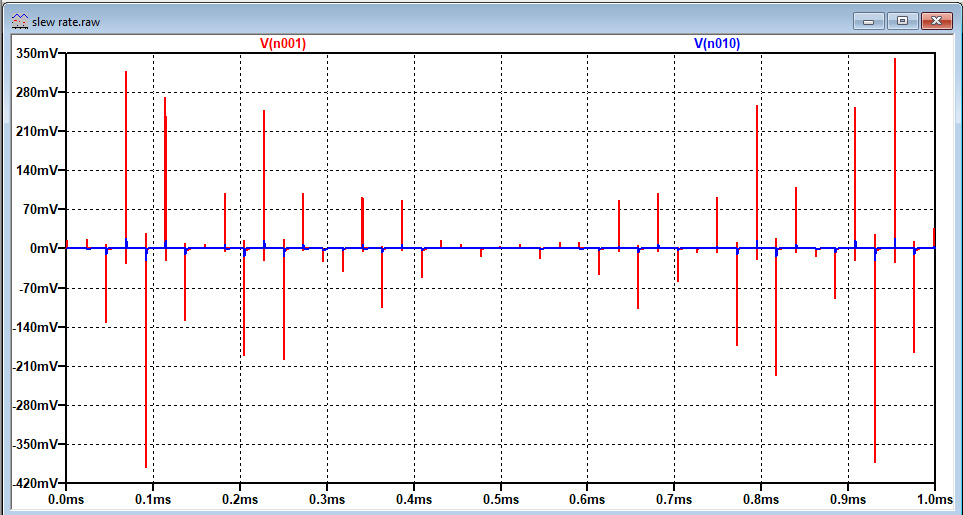

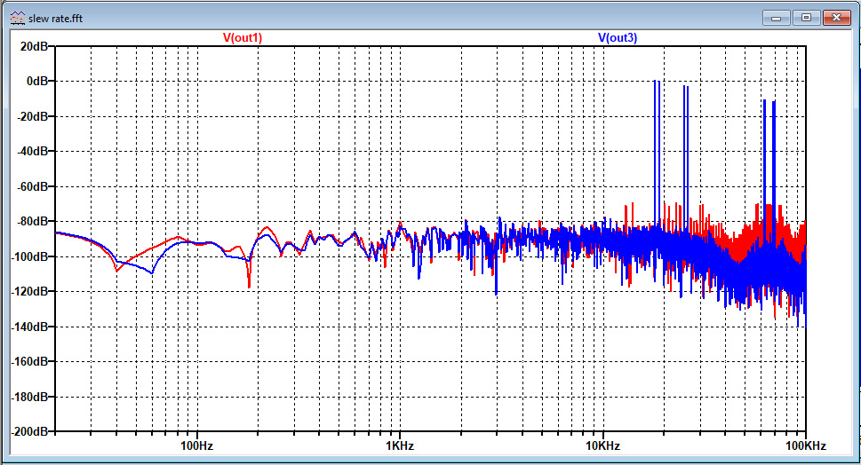

Still with the LT1468, I simulated the classical virtual gnd input version and the MFB version.
Image 1 below shows the signals at the virtual gnd input of both versions when offering a 18Khz+19Khz Fs signal sampled at 44.1K.
Quite obvious is the huge error signal reduction, almost a factor 30, completely preventing input saturation.
Also the spectra taken from both versions, conventional in red and MFB in blue with said input signal, is showing much less IM products for the blue version.
Hans
Hans Polak said:...Still with the LT1468, I simulated the classical virtual gnd input version and the MFB version.
Hans
Hans,
Have you tried simulating the classical virtual-ground transimpedance amp with a 9nF capacitor placed shunt, like C2 is located in Marcel's MFB schematic, to A.C. short the virtual-ground and the actual ground together? It would be interesting to know whether similarly minimizes the inverting-pin error signal produces largely equal results.
You can also reduce the ratio C2/C1, if you don't mind getting a more damped response.
That is, the fact that R2 C2 >> 1/(2 pi 20 kHz) is why you get the noise penalty. You solve that when you scale down both C1 and C2, but then the cut-off frequency gets very high. When you only scale down C2, the cut-off frequency doesn't become very high, but the response will be much more damped than the second-order Butterworth response that I chose.
Ken,
Yes I was also experimenting in that direction, but simply placing a 9nF cap at the amp’s input makes a perfect oscillator, so you definitely need the second RC network to get the needed phase margin.
Marcel was just a step ahead of me. 😀
Hans
Hans
