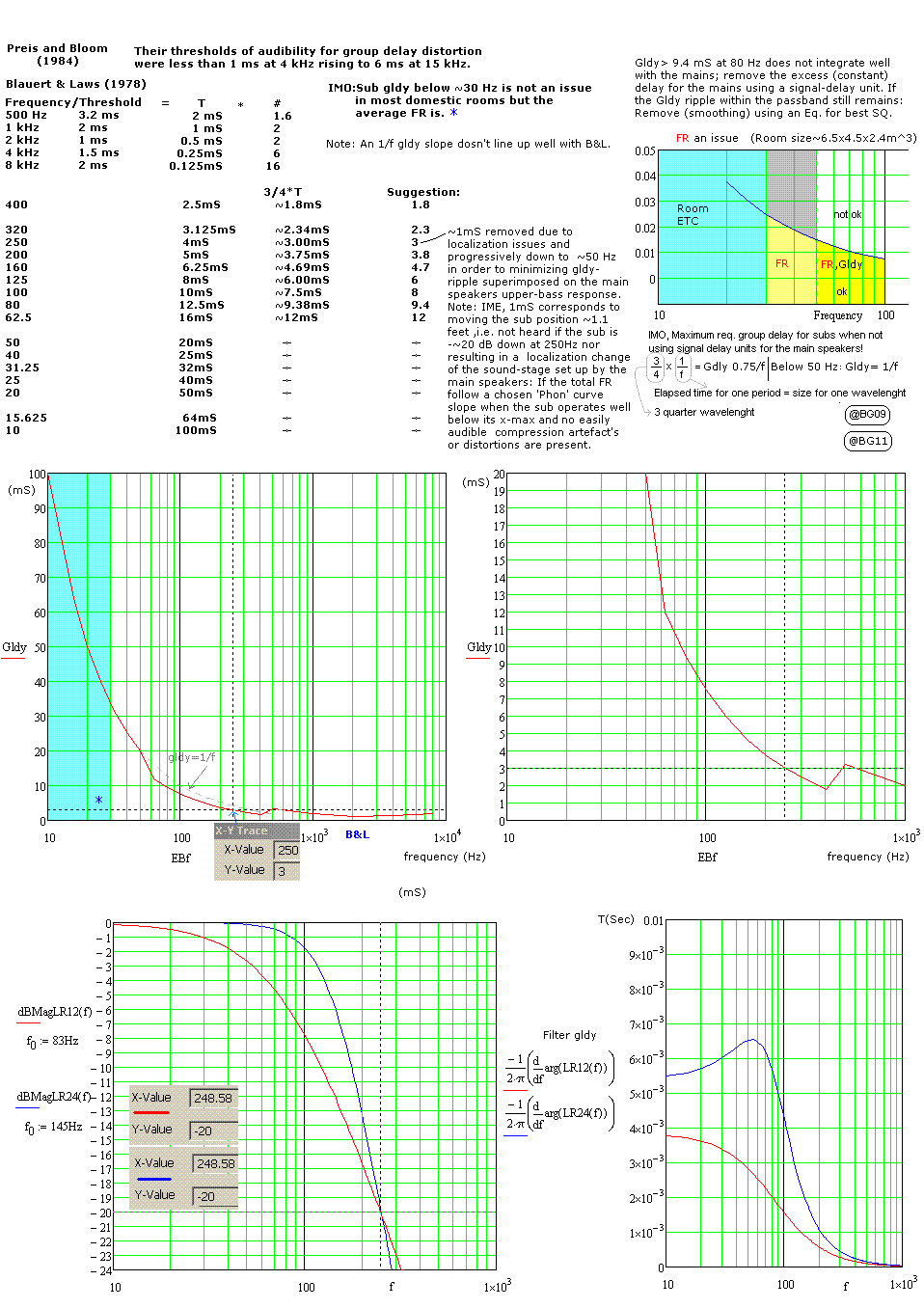

more10~ Thank you for your input this is good to know.
I guess by your description I try to get no more than 500/f and as close to 250/f that I can for my lowest frequency of interest.
Many times people have referred to just the time of the group delay without mentioning the target frequency.
Thank you for the chart !!

better than 800/f in milliseconds is what one wants, but hardly gets 🙂

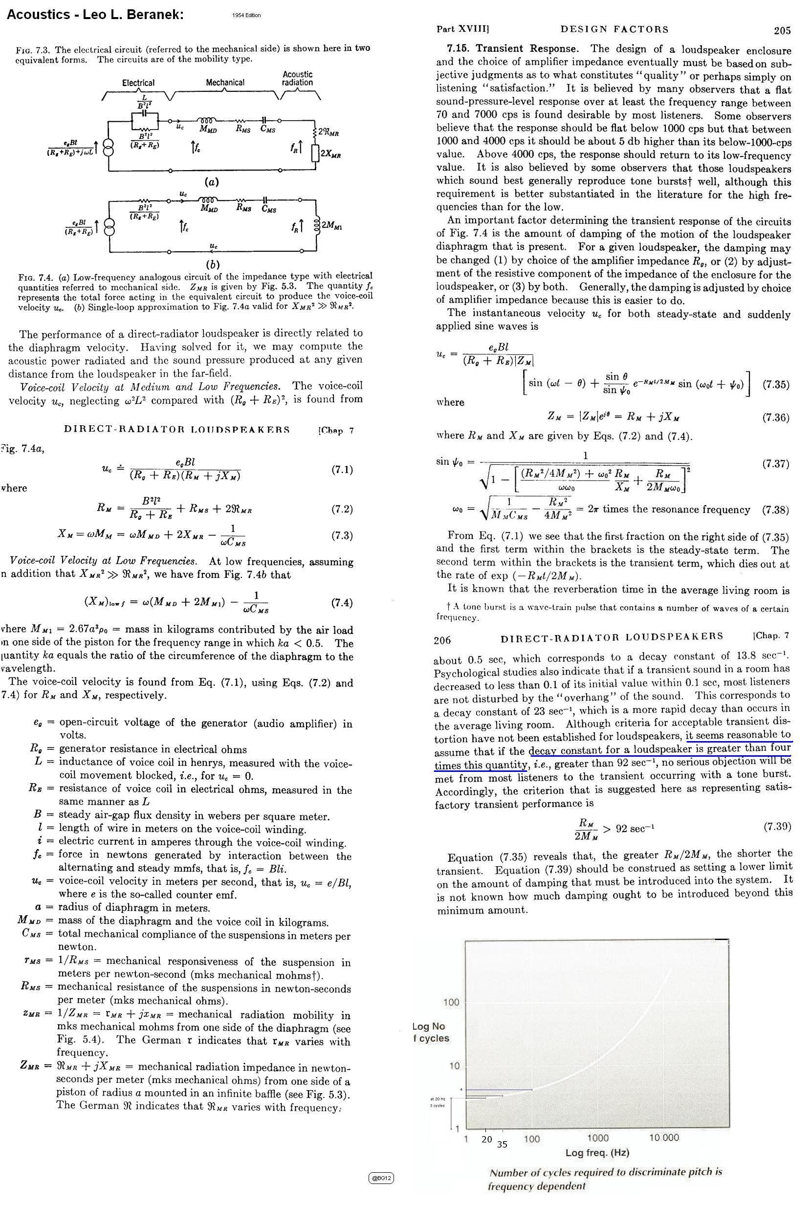

Another view of the same subject:
b🙂

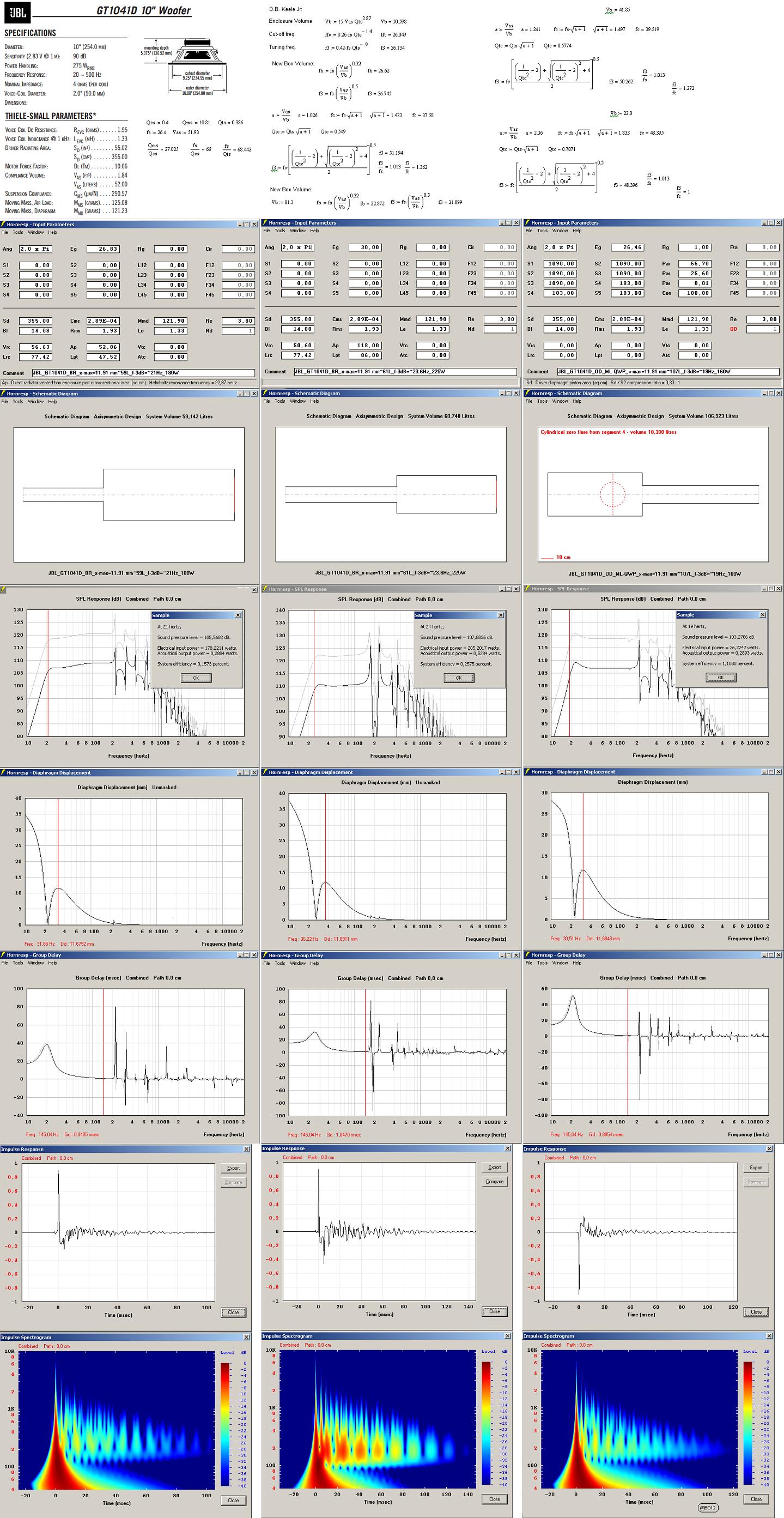

.. I did a WinISD this morning and found that they actually might work very well. Here is a screen shot of the Win results and the PDF for the drivers.
Your thoughts???
Hi djn,
IMO,It's a very good driver, looking from another perspective:
b🙂
Thanks B. That all looks very impressive, but it is way over my head. I don't understand what that horn layout is? Is it saying it would be good in a horn of some sort? I had hoped to mount these in boxes today, but I am still working on work stuff I brought home Friday. I have 2 cu ft boxes that I use for testing be they have 15" opening so I need to make a new baffle board. I'll try to get to that this week.
