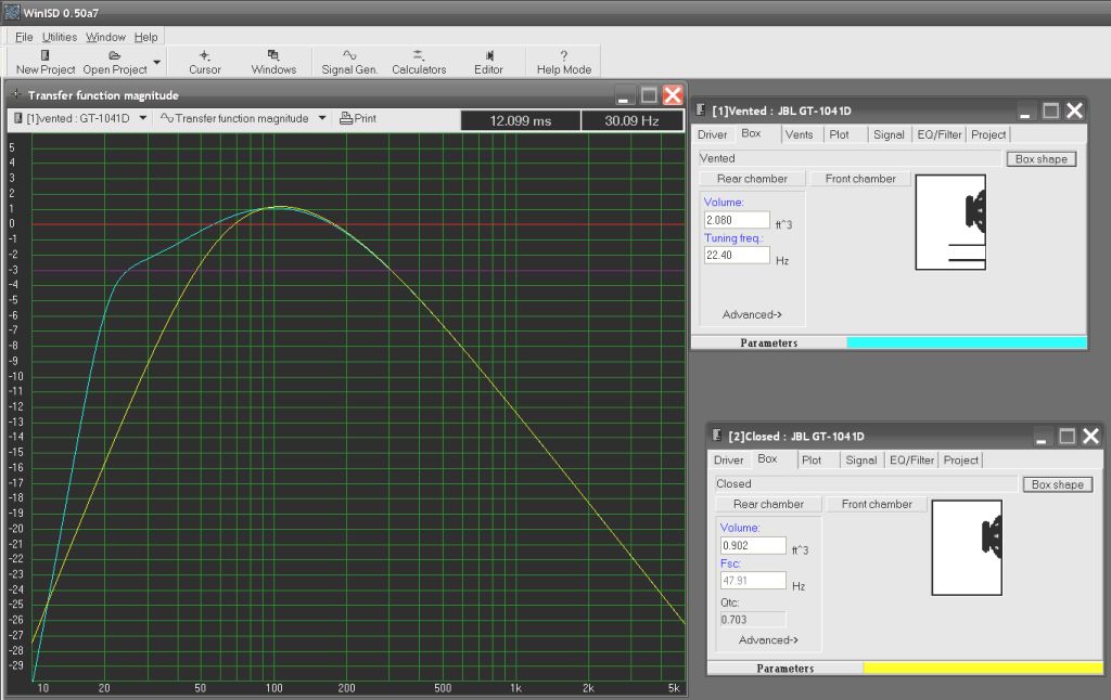

What do you think if this driver???
I have two 2 cu ft cabs and two 300w plate amps and always figured drivers would come my way at some point in time. Well, I was at a friends house last weekend and he asked if I want two speakers. I assumed he meant speakers in cabs but instead he handed me to JBL GT1041D sub drivers new in the box.
They are car subs so I assumed they might not work in a home system. I did a WinISD this morning and found that they actually might work very well. Here is a screen shot of the Win results and the PDF for the drivers.
Your thoughts???
  • JBL GT1041D PDF.pdf
    JBL GT1041D PDF.pdf

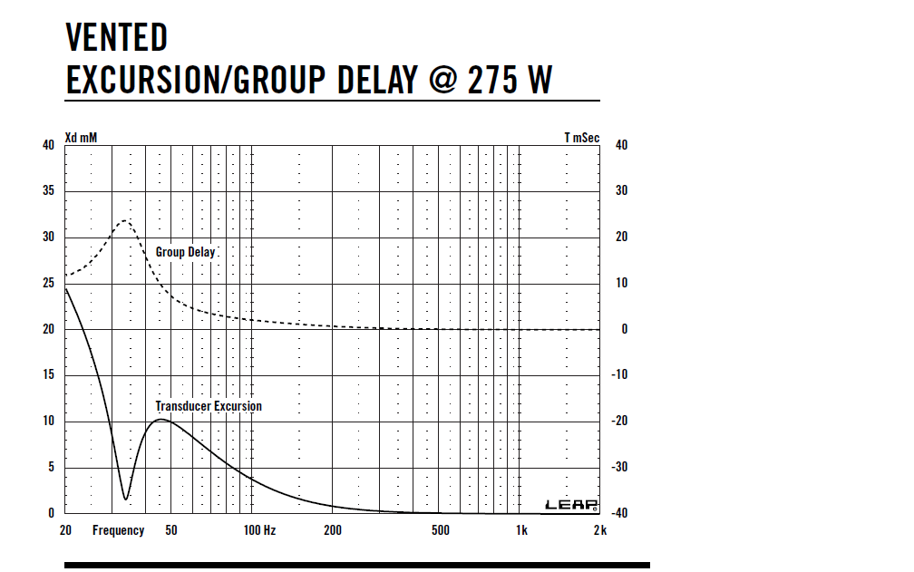

Hi Jer. Here is a screen shot of the group delay taken from the PDF. I have heard the term Group Delay many many times but never paid attention to what it means. What does it mean and what is the affect???
If the Group delay gets to high it can give the low end a muddy or slow as some put it kind of sound.
I don't know exactly how low is good.
But, I typically shoot for 1/2 to 1/4 or lower ms than what the peak frequency is as long is it doesn't hurt my target lowest frequency much.
For 30HZ is 33ms so I try to get below 15ms to 7.5ms as long as the frequency response doesn't hurt to much at this end of the scale.
This is a very hard decision and requires a lot of compromise.
But you can also consider room gain to help compromise for the drop.

In the plot you had posted by tuning it a bit lower you can reduce the group delay quite considerably to about 10ms at 40 hz and this might bring the peak of the curve at about 25hz to 30hz.
I will enter the data into Winlsd and check it out later tonight.
But I definitely think that you can have a really decent sub system with those drivers.

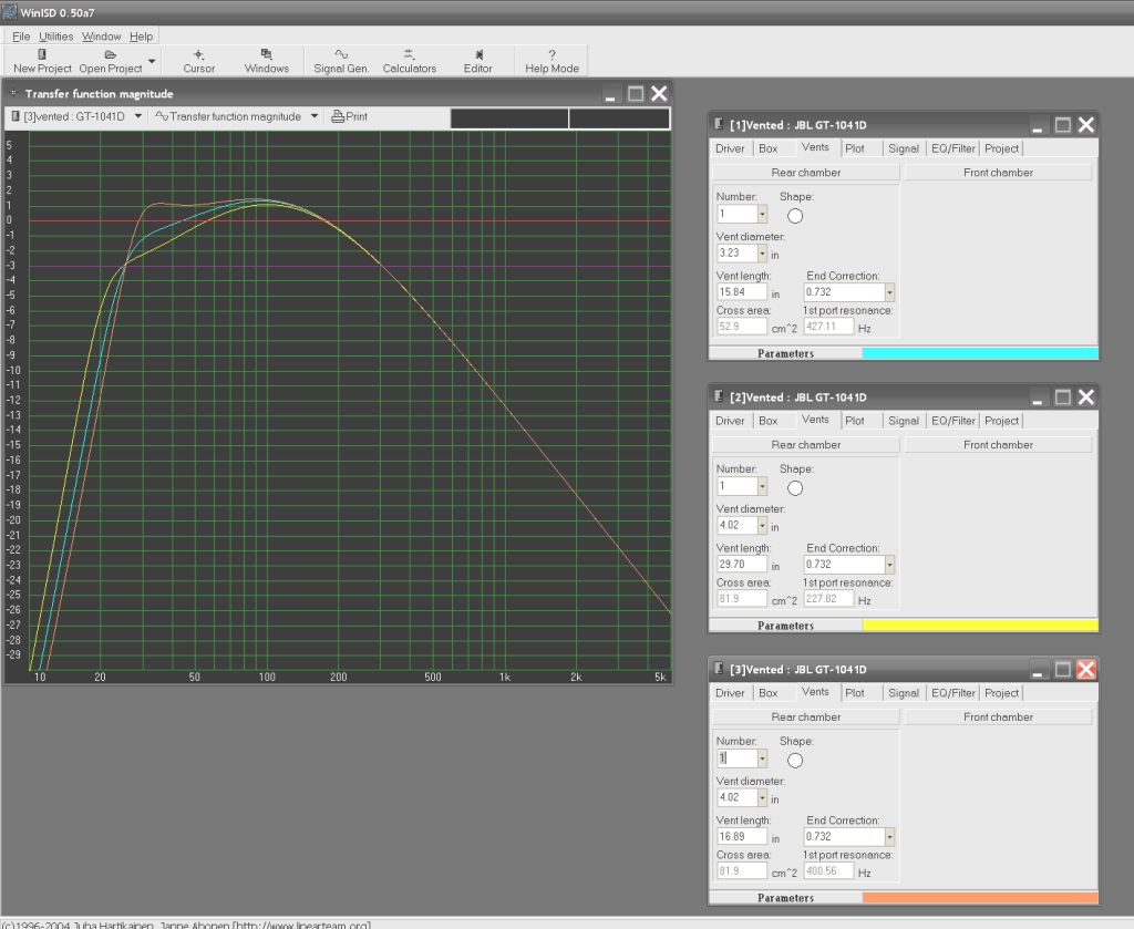

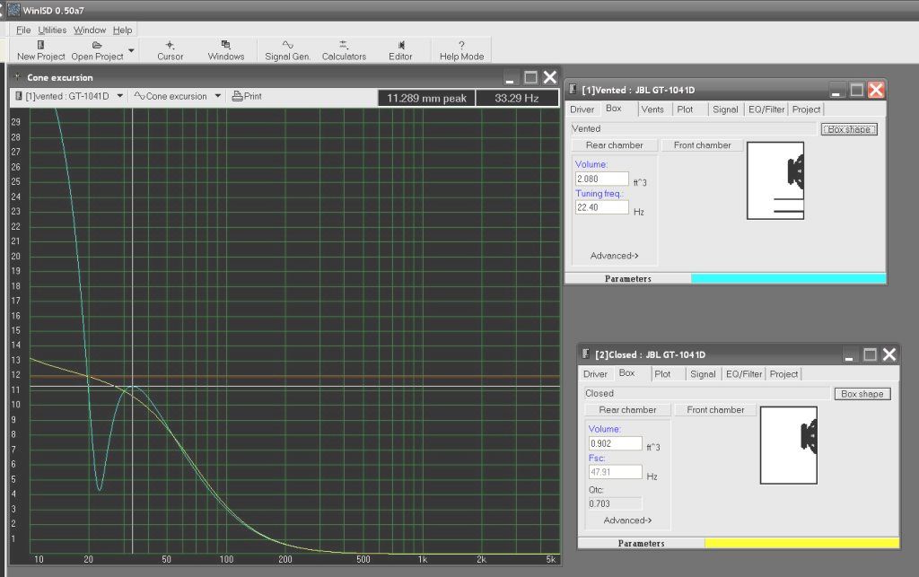

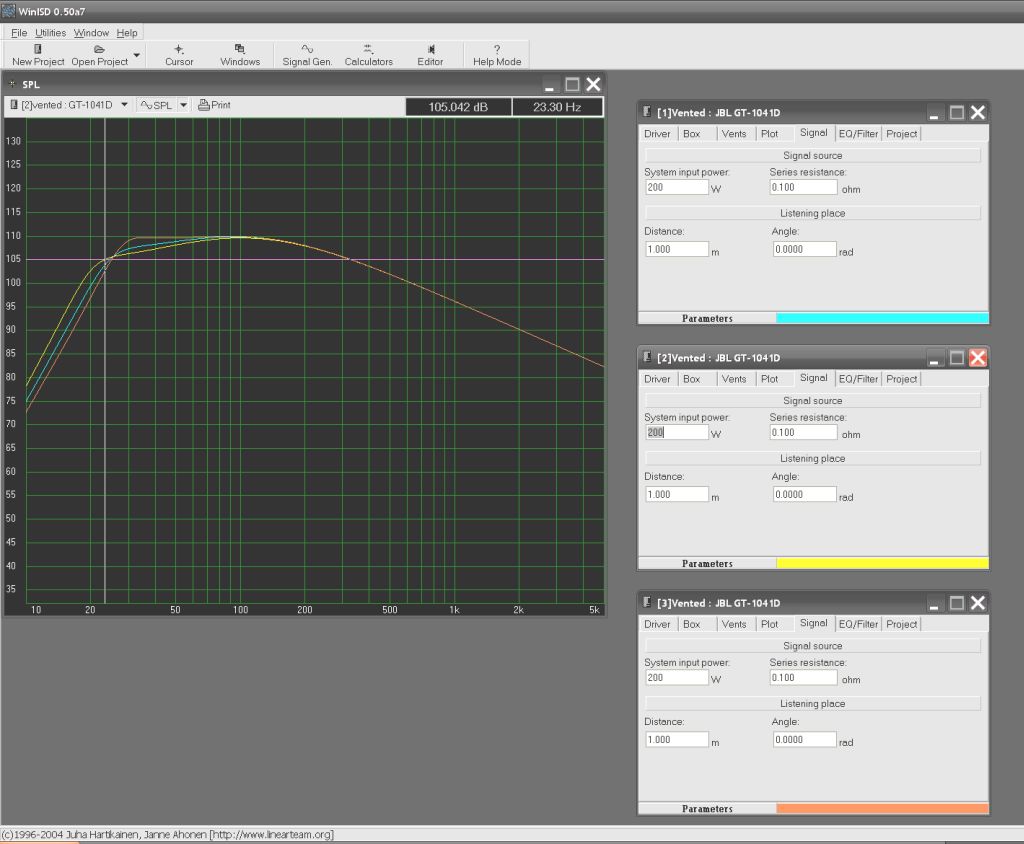

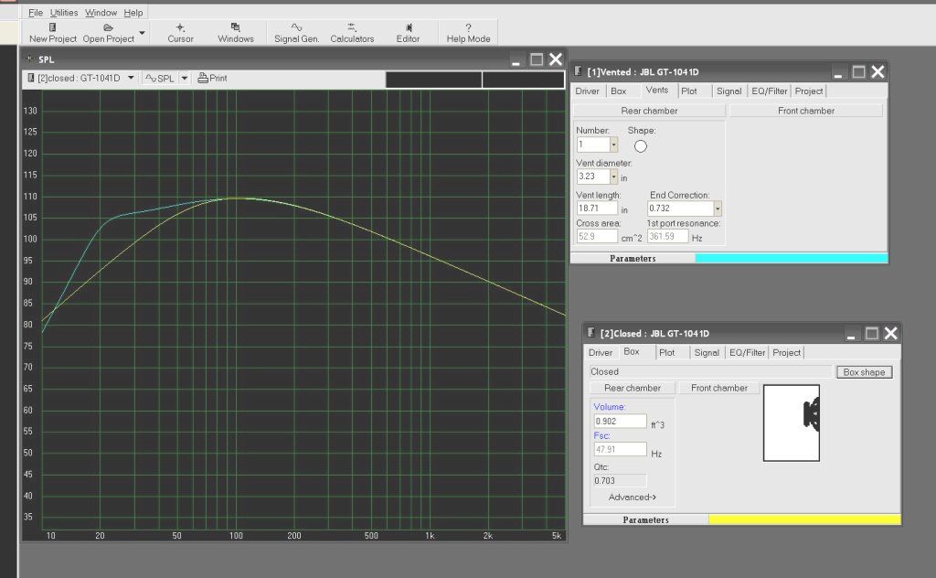

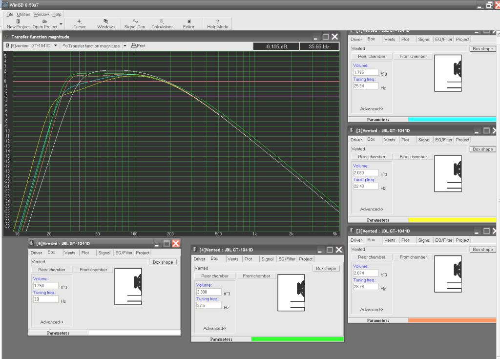

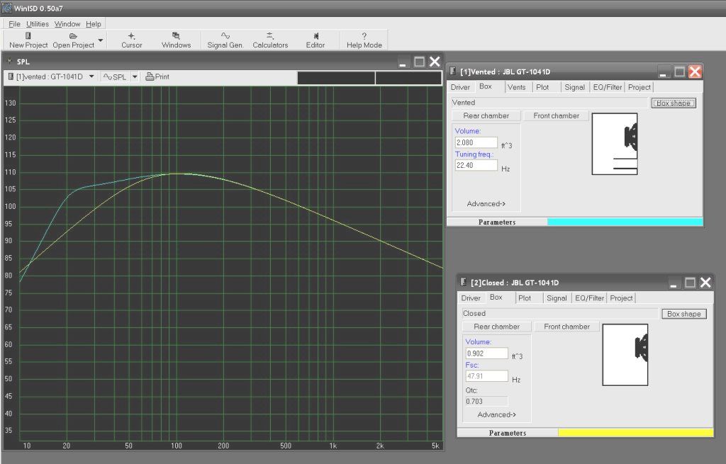

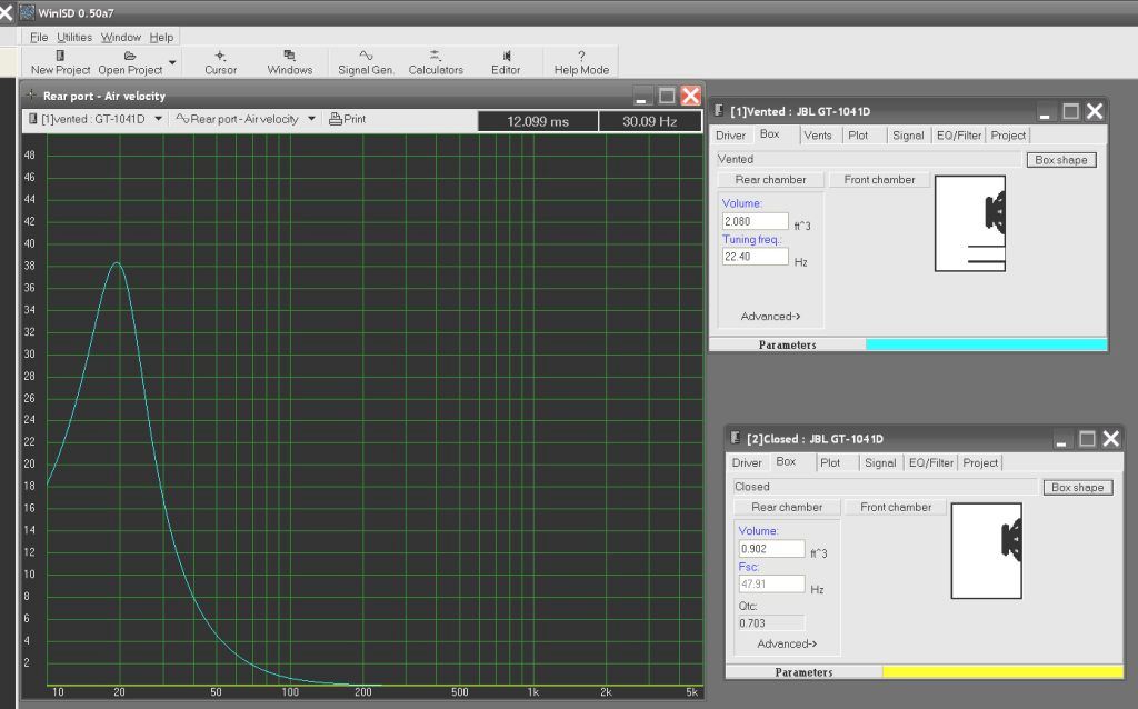

I was Messing with Winlsd and I must say that driver models nicely.
Here is what I have with it modeled in a 2 cubic foot ported box at 22.4Hz and 200 watts.
The port is set at a conservative 3.23" dia. and is 18.71" long as this would just fit in a box with 1' X 1' X 2' internal dimensions.
105 db at 20Hz and 110 db at 80Hz that is about a 2.5 db per octave slope....Nice !!!
It works nicely in a range of about 1.5 to 3 cubic feet for a ported and 1 cubic foot for a sealed.
Four of those would suit me very well as I do need to start building a new bass system soon.
My old drivers have now seen their better days...He,he,he,he!!!
Enjoy !!!
jer 🙂

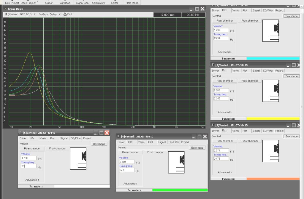

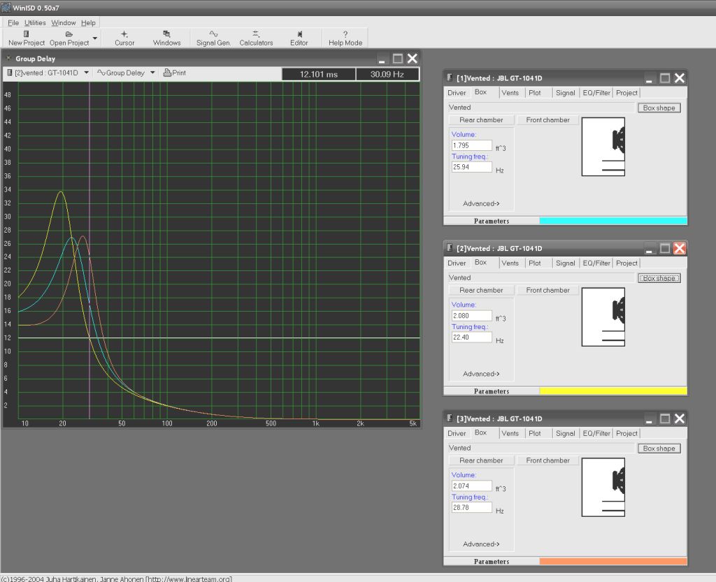

Nice work Jer! Yep, It does model well and the are not really expensive either. I did notice that on my WinISD, it is a very flat line but on yours it is more of a hump. Did I not add something in the parameters that I should have?
The slight drop is caused by a lower tuning in order to lower the group delay to 12ms at 30Hz.

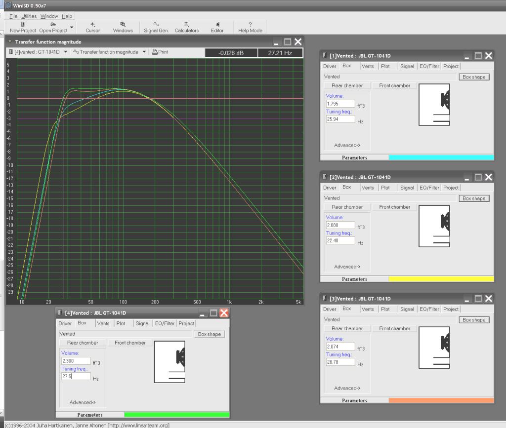

Here is a comparison of three different tunings,
Winlsd's optimised= blue
My tuning = yellow
My tuning flat= orange
I should have added JBL's tuning for comparison as well.
The drop in response will be compensated by room gain and most likely will be quite flat when measured in the room if not a slight boost depending on the size of your room and its loss factor.

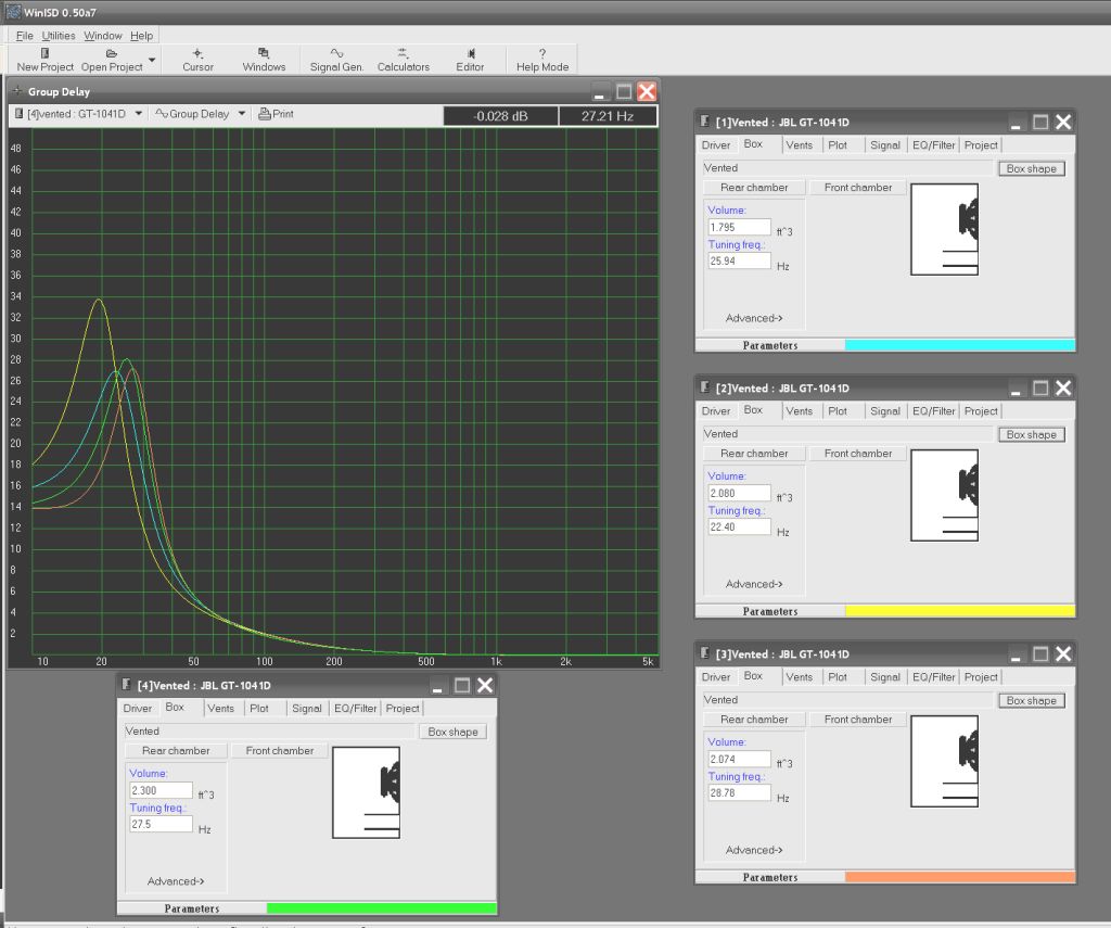

You can also have a more flatter response by increasing the box slightly to 2.3 cubic feet tuned to 27.5 Hz with an added .33 ohm series resistor as shown in the last two pictures in green.
This also raises the group delay considerably as well,almost double at 22.974ms !!
Remember that at 30hz a 33ms of group delay is a full wavelength of delay !!
jer 🙂
P.S all of the simulations are for the JBL GT-1041D that you originally posted and not the GT5.

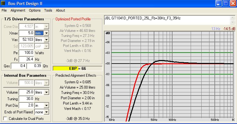

I have a pair of these JBL GT1041D. I must say they are one of the best 10" "car" subs that work well for home hifi. Tested them in 25 Liters (0.9 cu ft) ported boxes. Great dynamic/punchy mid-bass. They do go down low too, so low bass is not a problem.
It is always the subject of having a deep and low bass extension but for what cost when it comes to music?
It's always difficult to get the right balance. Often times, we get too caught up with either low bass extension or lowest F3. After building the speakers, we find that they sound lifeless. That's due to the lack of mid-bass. Nowadays, I would rather sacrifice a little bit of low bass in exchange for superior mid-bass.
Regards
Mike

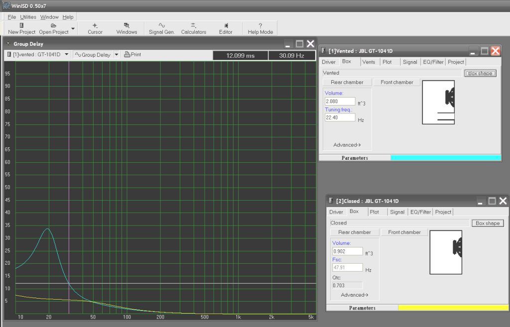

Here is the same charts but the JBL's tuning added.
Big difference but still acceptable for music (I guess).
IMHO I would take the drop in response and let room gain compensate for it.
And a lower bass extension with a lower group delay at 30Hz for music use as well.
Were as my tuning shows a 4Hz lower response at 26.3Hz for the same delay.
The JBL tuning is not bad as well as I didn't even look at it until now.
But I personally don't really consider anything below about 25hz to 30hz to be of any use for music although some do.
Cheers !!
jer 🙂

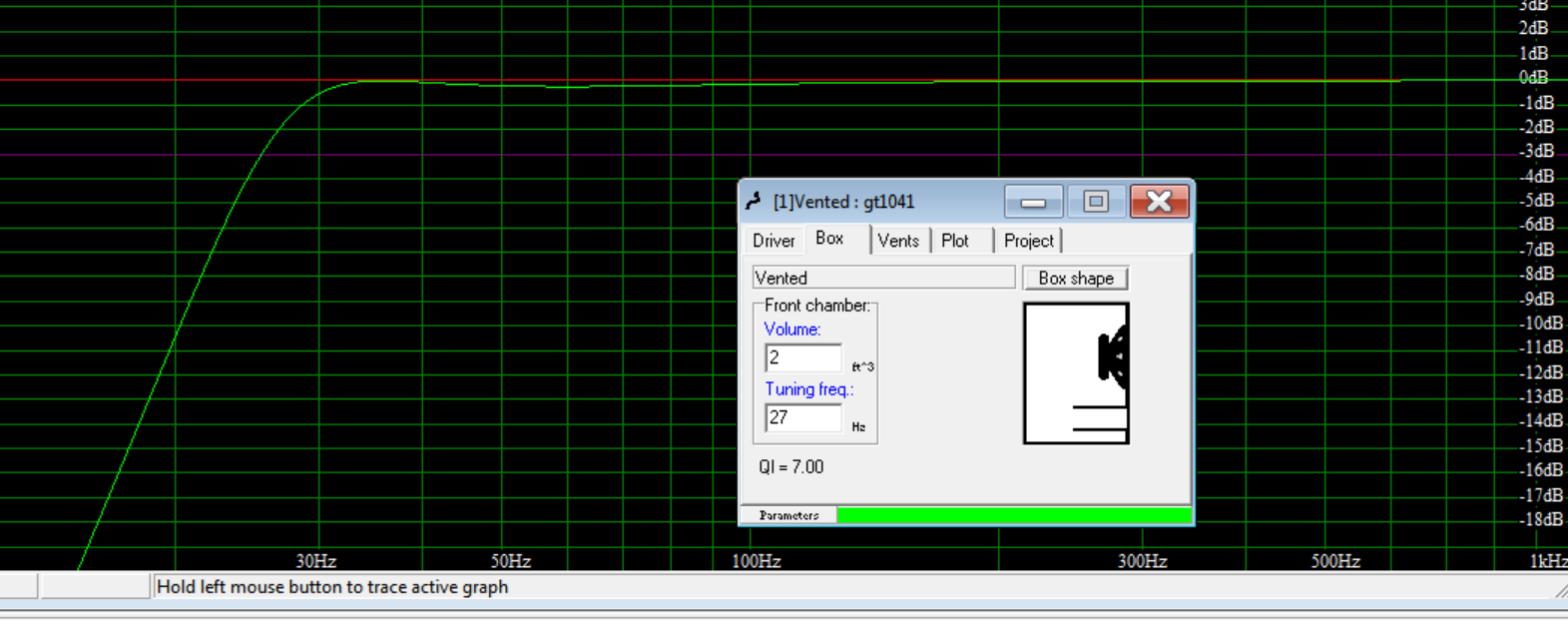

Thanks for your work Jer, it looks like these will work very well for my purposes. I don't do HT so it is music only and these will actually be 3rd and 4th subs in the room. When Joe handed me these, I took them to be polite.....I'm glad I did!

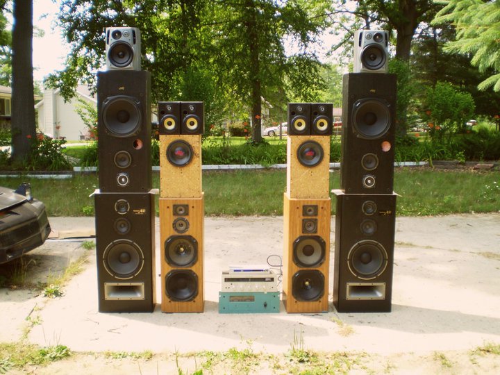

I think those subs will work nicely.
I had 4 x 12's and 4 x 10's going of some average speakers but sadly I just lost 3 of the 12's.
It would reach 110db tight and clean when it all was working right.
Here is a picture of my system after I had just rebuilt it.
I don't have any big ESL's made yet.
jer 🙂

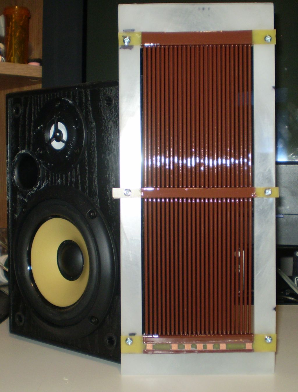

Here is a picture of my latest mini panel.
It is 12 inches tall and 5 inches wide.
All that is needed is to mount the diaphragm and get the resistors needed for the segmentation.
I will be having a First test of this one some time this week.
jer 🙂
