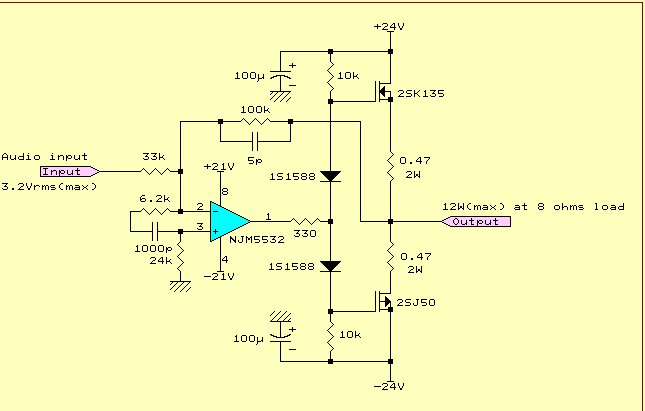

i am a new member on this forum i want to build this little
amp i found on the web its my first amp project !
do you have some recomandation or advise or modification for
this amp is seem very easy to build on veroboard.can i subtitute the fet on this circuit by irf type its easy to found.
