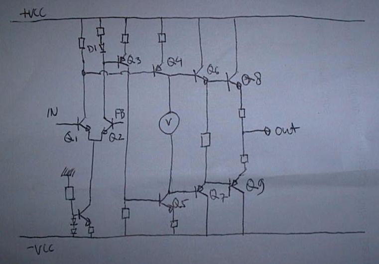

What do you think about this?
1. I attach the schematic here. It uses only single differential (Q1+Q2) fed by CCS below. But it dosn't use CCS anchored VAS, because it uses push-pull VAS (Q4+Q5). This is possible from single differential, because the output of Q2 is level shifted by Q3 so it can perform a push-pull VAS.
My assumption is single differential is better than complementary differential. But Mr.John Curl stated that there is some advantages with push-pull VAS (like the one used here). Mr. NP stated that CCS anchored VAS is good because it anchored the whole system. There is some contradiction about this 2 opinion, I cannot compare these 2 opinion clearly.
From the books, I read that there is another advantage about push-pull VAS, that is the positive and negative slewing is "forced" to be the same number. While in CCS anchored VAS, the positive and negative slew rate will certainly be different (as stated in Mr. Doug Self book).
Maybe this design accomodates all, maybe not. What do you think about this design. What is the merit and drawback of this design?

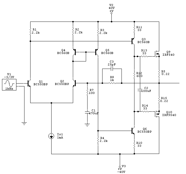

The only advantage compared to a 'standard 3 stage amp' is some increased openloop gain, but a bit worse phase margin.. I did a simple version of your idea in my sims and it looks good.. How does your idea effect PSRR or CMRR ? Offset seems very low and good controlled with this topology..
Thijs
Thanks, Tschrama for your analysis and newidea.bmp. I just re-read the book of Doug Self and find one important thing about to have exactly splitting the current between the two differential transistor. The exact splitting between Q1 and Q2 is very important and sensitive (specially to distortion), so Doug himself always use current mirror to split equally (so does Randy Slone).
My schematic will not split equal amount between Q1 and Q2, because Q2 have to feed both its rail resistor, and the level shift mechanism.
But in your newidea.bmp, level shifting is done by current mirror, and in my opinion, your newidea.bmp will force the current tobe equally splitted between Q1 and Q2.
But I don't understand about "worse phase margin". First, I dont have any equipment to measure anything about this.
Second, I don't really know what is the criterion of "good phase margin" and "bad phase margin" and also on how to measure them. Could you tell me about this?
