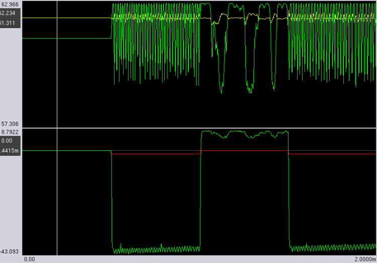

What do you think about this amp schematic?
pprasse said:
The upper waveform is from the net where you can read LTPout1 in the schematic. (30% from top, center)
The lower is from LTPout2 ( right from LTPout1).
The waveform is 1kHz. (see scale at bottom)
Patrick

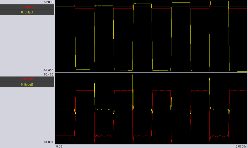

Should be okay.Patrick, It depends how hard the VAS stage is loaded. What is you loading of the amplifier and how large is your output signal of the amplifier.
With no load the LTPout1 waveform should be smaller. What is the peak-peak voltage of the waveform.?
If you run a squarewave through the amp the LTPout1 should have spikes which are placed on the rising or falling edge of squarewave it is because of the rapid charge/discharge of miller cap/stray capacitance on the VAS stage. Try it out.
Sonny

Vpp (LTPout1) = 1.31 V
Loading of the amp is 4R, Vpp (output) = 94V
Vpp (signal) = 1.4V
With no load Vpp(LTPout1) = 0.92 V.
I will simulate squarewave later because when I try to simulate spice eats up all my CPU time.
Therefore I think it "hangs".
Thanks!
Oh. It didn't hang. It took 500 sec (500MHz CPU, highest priority).
Think this was due to the infintitly short rise and fall time of the square wave.
Hmm... The signal doesn't look very nice...
Ok:
upper panel:
yellow: ltpout2
green: ltpout1
lower panel:
red: signal ( 0 - [-1.4V])
green: output
Some nice traces of oscillation, don't you think?

The sine looked like a sine.
No, seriously: It looked like a very good and smooth sine with approx +10mV offset.
With 100nF the you can see the glitches the spikes perfectly (with square wave),
but the sine is more or less like this:
( I don't know the english word) /\/\/\/\ on the output
I cannot tell you right know why it oscillates... I am at work right now, and i don't have the time to simulate this circuit right now.
What i can tell you is that you have a heavy loading of VAS stage. You drives as sink and source +/- 6.5mA (1.31Vpp on the base of T5 ~ same on the emitter) from your VAS stage when driving 4R at 94Vpp.
Personally i would add another buffer between VAS stage and the output stage.
Maybe you should try run some sims first with R1 (1.8k .. 2k7) as suggested by P.Lacombe. Take some look at DC Offset,Gain, phase, Look at sinewave and squarewave signals.
Then later try add the currentmirror and do the mods in order to get it up and running with the currentmirror.
Sonny
