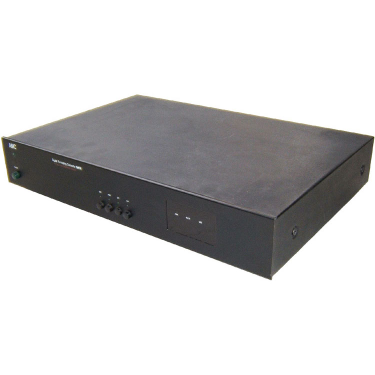

I recieved the DAC8 yesterday and installed it. With some close listening, I have to say that the AMC is not as bad as some of you think.
I have since taken the Parasound CD/P-1000 out of my system which actually did not sound as good as my current Panasonic DVD-A120 dvd player. I then hooked up the DAC8 to the fiber optic output of the dvd player and heard a major improvement.
This thing really sings! It reveals a lot more detail and resolution, and it reproduces an incredible 3 dimentional soundstage that I haven't heard in my system ever. It has a very clean, natural, pleasing sound that I think cannot be beat in its price range. There also seems to be more acoustical space between the instruments with pin-point accuracy and superb detail in the acoustics of the recording environment.
The AMC DAC8 may not be an audiophile grade d/a converter, but it surely is a great d/a converter for only $115US.
I'll have to see if there are any kinds of tweeks or mods I can make to it. Maybe somebody here has some ideas. I'm not sure if it can really be improved apon, but I'm always open for suggestions!

Nasty JRC
Chops,
What a nasty JRC op-amp it has there!
If it plays well as it is, imagine if you put an OPA2604, OPA2132 or LM6172!
All these are excellent.
You can remove that op-amp and put a good machined socket.
Bypass the psu pins to ground, under the circuit, with a 22 to 100 uf electrolythic, bypassed with 0.1uf poly or ceramic.
You won't believe it when you hear it again.
Try any of the three op-amps above, or get them all and listen to them, see what you like most.
It's easy to change op-amps if you have a socket.
And hey, it seams like a double sided circuit, so you have move components under it.
Maby the clock is smd, and is under the circuit, as the Dac.

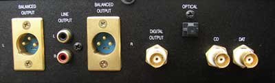

Hi, chops.
There is not present crystal oscillator, the main clock is recovered by PLL in TDA1315 (this is a spdif receiver, similar CS8412). There are jitter very high (up to 500pS).
What there is a DAC IC?
Inscription on PCB (TDA1015) is mistake, because à TDA1015 is a 1 to 4 W monolithic integrated audio power amplifier.
TC4081 is multiplexer.
7805 is power supply. Only one source on all is poorly. And in general, 7805 is bad.
Begin with upgrade power supply. It is necessary to divide it on 2 parts -digital and analog power supplies. There it is, but a supplies is divided by feritte bead.
It is desirable to use different transformers, and different IC linear regulator, which separate should be for everyone digital IC and pin of digital supply of DAC IC . Digital and analog ground should incorporate on DAC IC. Two steps of linear regulators is better.
IC linear regulator:
LM317 -good
LT1086, adp3303 -very good, but I use the LM317 as current limiter + shunt-regulator on TL431 usually. It`s excellent.
Change op-amp.
ad826(dual) good
ad825(single) good
opa627 (single) excellent
ad843(single) very very excellent
For single op amps use special adapter.
AMC differed by greed on caps always, therefore throw out them all ("wendell" and ceramic caps) and put in analog supplies:
Elna-Silmic 2
-Cerrafine
Panasonic HFZ
BG Fk îr N or similar.
in digital supplies:
tantalum caps (10-50uF) with polypropylene caps (WIMA MKP, FKP) or ceramic caps (NPO only) 0.01-0.1uF as shunt,
or Sanyo OSCon, or BG Nx-HQ.
Caps should be located close as possible by power supplies pins of IC.
The same or another set caps should be located on outputs pins of power supplies regulators
In lines of a digital supplies it is necessary to use ferrite beads.
It is my experience.
You should be happy, you have a lot of place in the box for experiments.
Photograph the main board with the removed plugs. I do not see some inscriptions on it. There can be I still something I shall advise you.
Regards.
