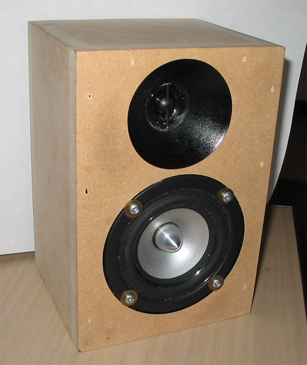

I think they are great.. nice bass as well. Use them in a 2-way center, going to build the 2-way towers to go with it eventually.
rdf what do you mean by high? 4-5khz?
Someone else recommended to cross lower, around 2-4kHz.
I like mine.. There small and clean sound.
I use them in a Fostex recommended horn. They are great! But its true about the peak about 7-8khz. Its not very nice. But i have an old eq so i removed it with that. I think it is a little weak at the top so i use a tweeter to help. No x-over on the TB, just using x-over for the tweeter. Ok, it is a really bad piezo **** one, but it still helps. i will replace it some time in the future.
