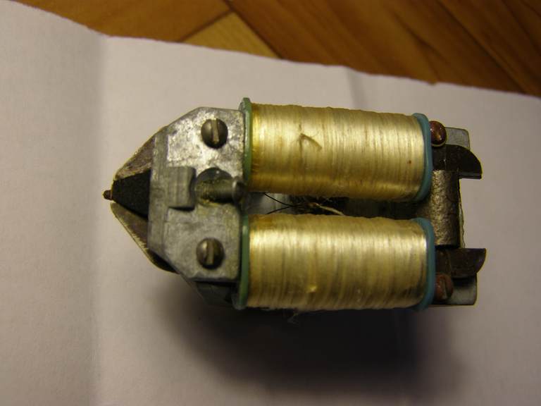

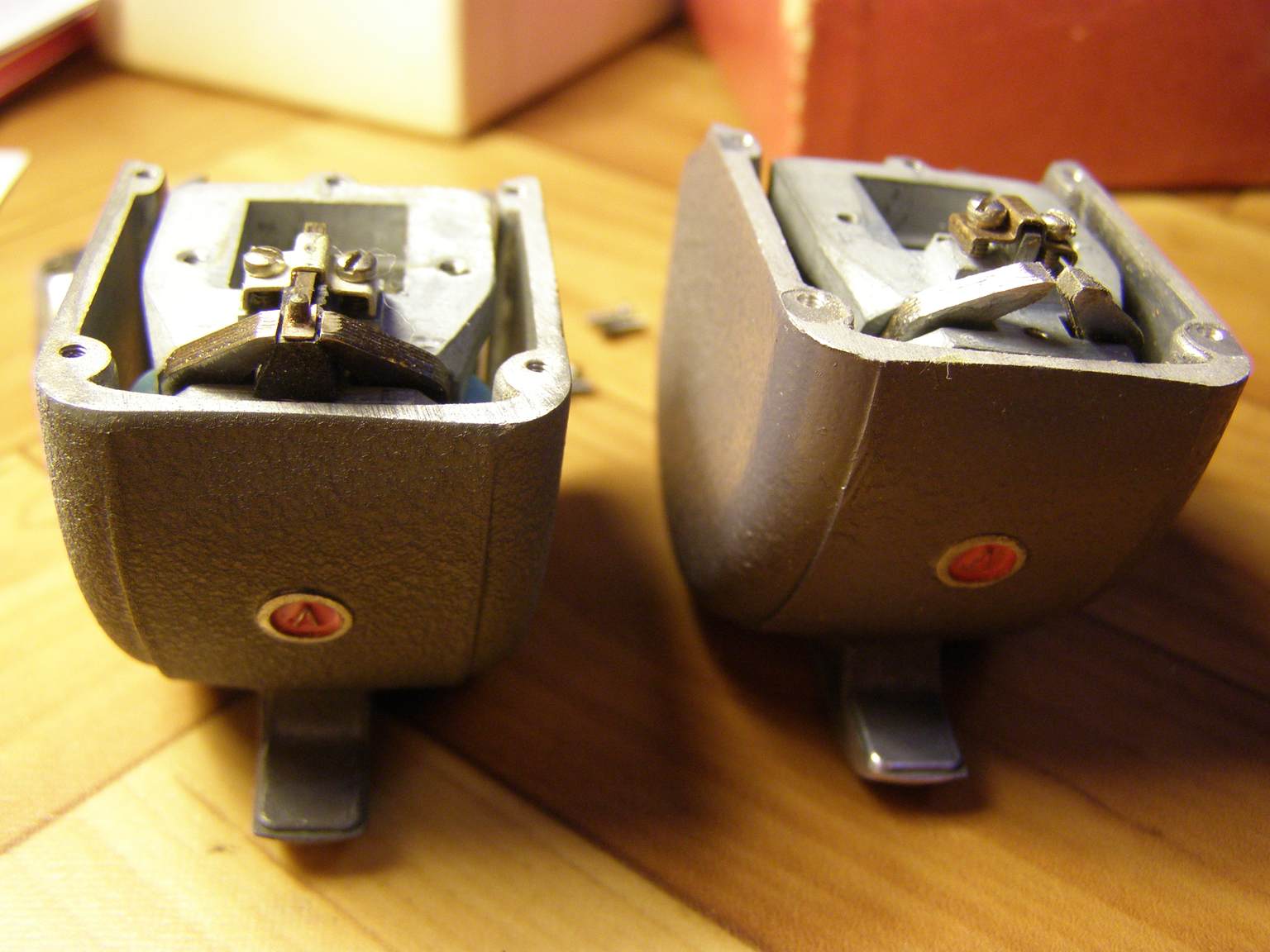

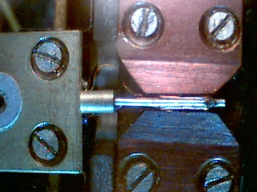

Both of you are actually making moving coil cartridges, so maybe you could explain the physics of why moving coil should be superior to moving magnet. I’m a retired electrical engineer and I get the advantages of air core coils and MC low coil resistance and inductance compared to MM’s, but MM resistance and inductance issues can largely be dealt with by proper loading. In principle both MC and MM generate voltage by a wire cutting magnetic lines, either by moving the wire through a stationary magnetic field or conversely by moving a magnet so the magnetic lines move through the wire. Why is moving the coil preferred? My observation over the years is that MC cartridges have had more difficulty with keeping moving mass down than MM and have historically compromised/compensated with higher VTF to keep that higher moving mass in contact with the groove.
I actually have an original Neumann DST but have not yet acquired a suitable arm and SUT or preamp for it. Among my concerns is that it requires 6g VTF and even worse, with the small gap between the coils and the pole pieces, it looks to have very limited cantilever excursion capability. I have several ‘hot’ LP’s that have passages that I’m sure would exceed the DST’s limits.

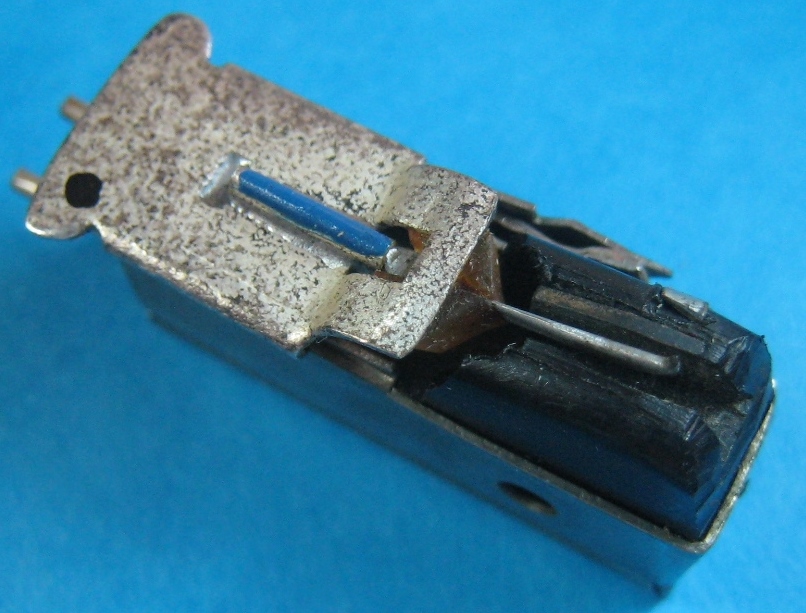

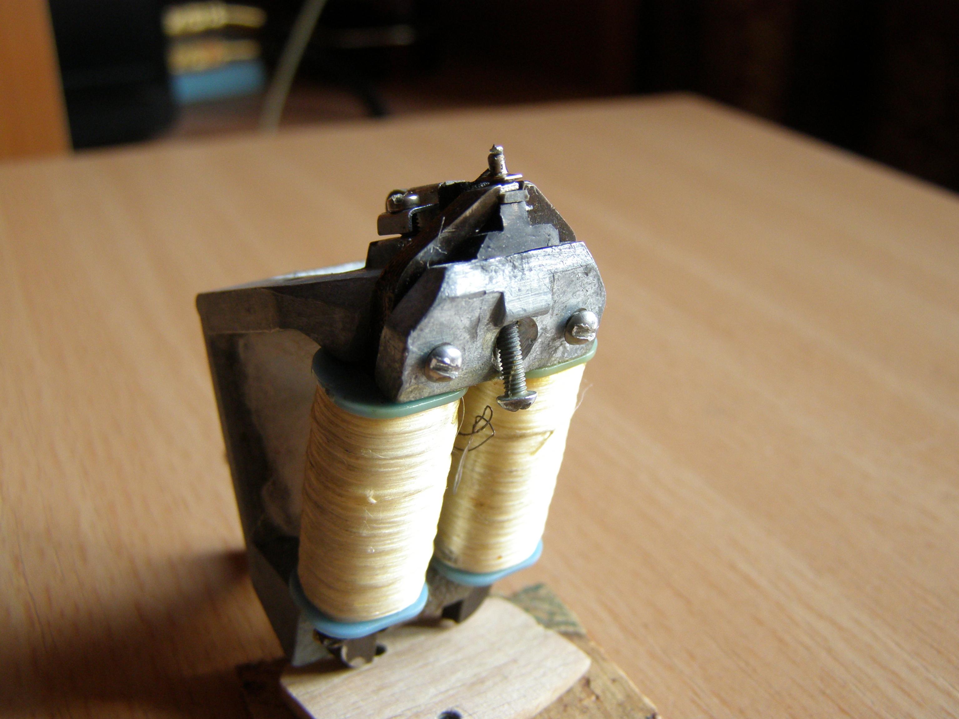

My next pursuit is restoring/renovating a Weathers FM cartridge. Like the DST, Decca, and GE, the signal sensing in the Weathers is on the stylus side of the pivot, right up to and including the tip. It uses the entire cantilever as a capacitive element controlling a RF oscillator. It has no moving coil, magnet, or iron mass at all. The big gotcha is that it is mono only.

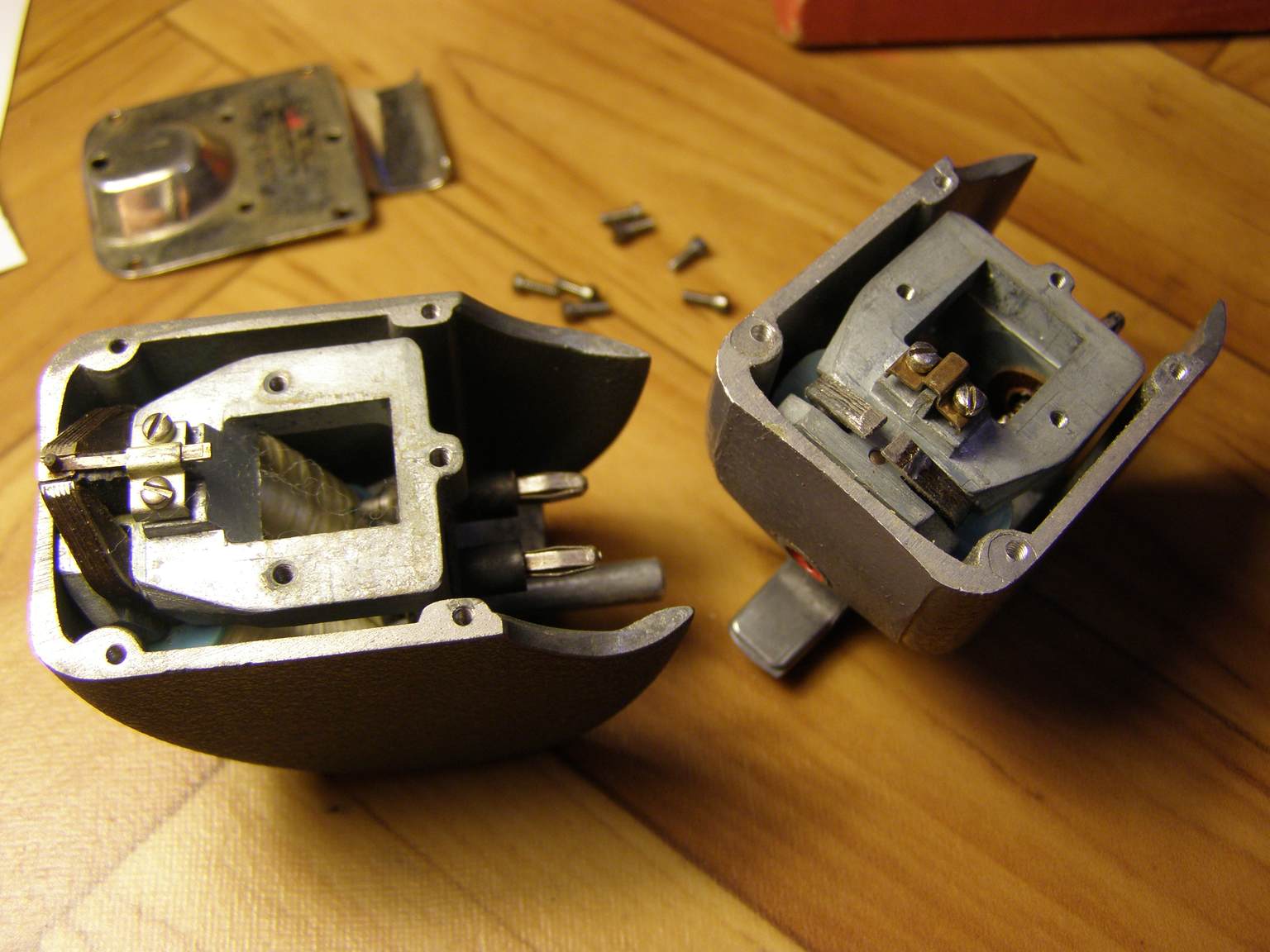

Ray, it has already been done long time ago, in the middle of the last century. And it worked very well. In Paraflux mono professional induced magnet cartridge, a small piece of metal, located co-axially with diamond, works as an induced magnet. From the mechanical point of view, with the same setup we may put there moving coils, instead of magnet, and it will work . Actually, channel separation easier to achieve with Neumann-like coils, than with moving magnets, in case of stereo cart. Decca-like design is complicated. Maybe, someone of DIY-ers here will create MM with simplicity of Neumann, and motor location near the diamond? I'm looking forward to see it.
As to "The advantages of generating the signal voltage near the stylus tip make sense to me, as cantilever bending and mechanical resonances shouldn’t degrade the signal as much", I would agree.And in that case we have additional advantage of not decreasing the already microscopically small amplitude of stylus movements.

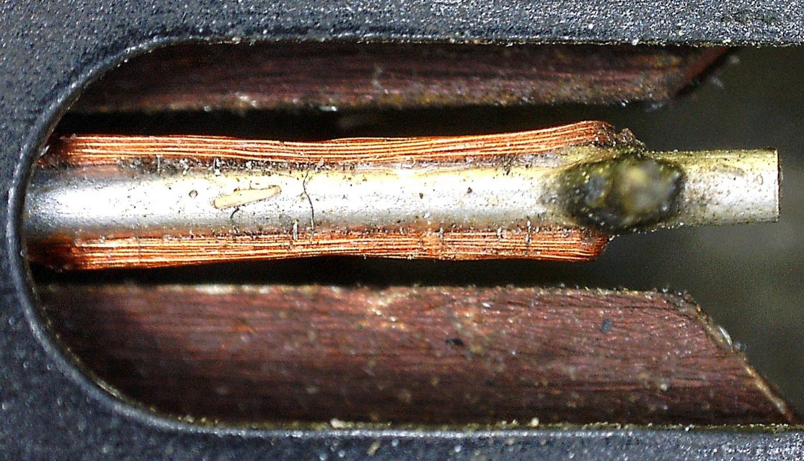

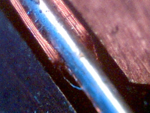

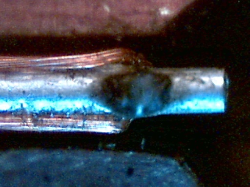

walterwalter,
Got a new USB microscope to play with. Took a hi-res picture. It looks like the spiral striping effect in my other photos is some form of Moire' effect optical illusion. BTW, what's the safest way for me to clean this? It almost looks like some microscopic metal filings.
attachment.php
Ray K
Thank you, Ray. Now I can clearly see the coils, and even count number of turns. I'm going to build DST replica and compare triangular coils to other shapes. For now both my DIY mono and stereo cartridges are working with very good sound performance. Air coils for certain are better, than those with a core, and location near the diamond is great. I, honestly, can hardly understand, why put them on the other side of cantiliver, where already microscopically small amplitude is decreased several times. Not a smart solution, what is commonly accepted.
Diyraik I actually have an original Neumann DST but have not yet acquired a suitable arm and SUT or preamp for it. Among my concerns is that it requires 6g VTF and even worse, with the small gap between the coils and the pole pieces, it looks to have very limited cantilever excursion capability. I have several ‘hot’ LP’s that have passages that I’m sure would exceed the DST’s limits.
DST were made for the purpose of studio monitoring freshly cut records. So, we may expect it will track grove on even the most difficult passages. I will be surprised if not.
As to concern about high VTF, IMO 6gram is almost on the margin ( which is about 8 gram) of to be safe for the record. In my experience with many MC, with up to 3 gram VTF there are no traces of record wear. The same with both my DIY core-less MC, they track at 3-3,5 gram.

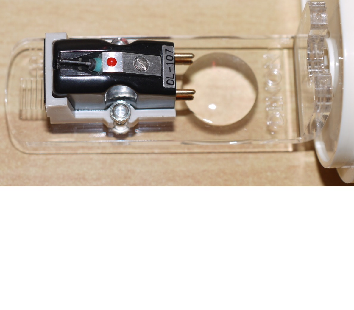

I've never see a credible argument for lower mass for either tech. If you look at the lowest ever effective moving mass cartridges then MM and MC tie for first place, mainly because technics were in competition with themselves.
Likewise distortion. I've not seen anything that really backs up the distortion claim and have yet to have time to do any meaningful measurements myself.
I do however keep collecting odd historical cartridges Latest is the Denon DL-107 which was launched 50 years ago and is made the same basic way as the DL-103. They also did a version which was swappable with the DL-103 for broadcast use! An MM with 0.35mV output. Boggle.
My holy grail at the moment is the Jeweltone/Nagatron ribbon cartridges.
