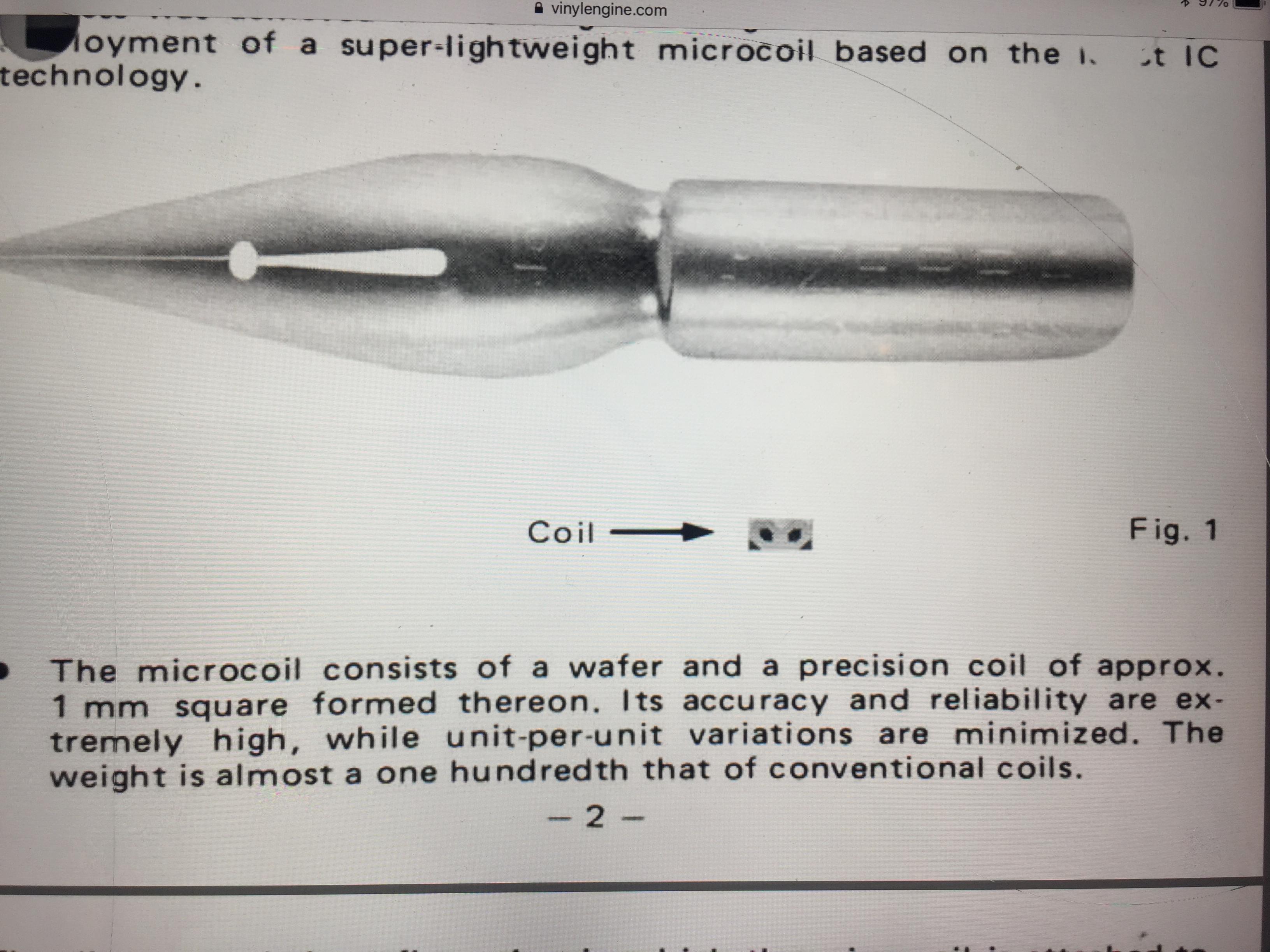

The 1mm square wafer coils of the JVC mc1 and 2 were fully immersed in the magnet field and looking at the ART 1000 I do not understand why they built it this way.
The 40 year old JVC appears to be a superior design in comparison.
.2 MC output /30ohm

Interesting, wonder how they achieved the required precision in manufacturing economically enough for a cartridge like this. The low mass sounds pretty appealing.
