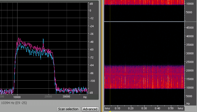

I have lowered the pitch of the file so that the information is now located between 9,5 and 23KHz for comparison with what you think you hear in the Difference.wav file.
It is amplified with 25dB and the average RMS power is now -33dB
No need to crank up the volume anymore.
DifferenceLowerPitch+25dB16.wav
/Hugo
