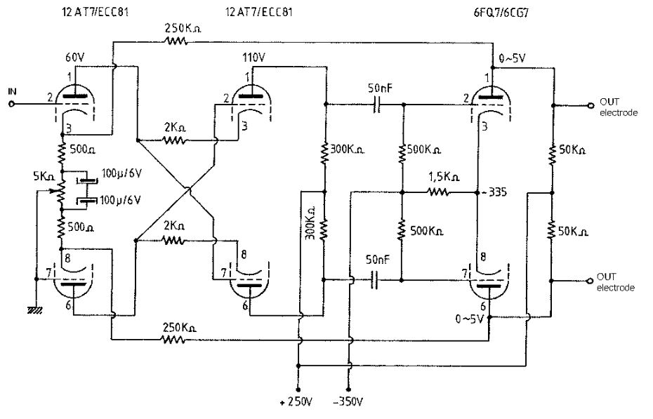

I'd like to build this circuit but the Schematic only shows one channel with a differential output ? I'm assuming I'd have to build this circuit twice tat would connect to four of the five pins. on the headphone connector. Where does the 5th wire on my headphones connect to ?
Hi rajugsw,
indeed the schematic is one channel.
Sorry to be outright, but based on your questions, I suggest that you do some research about Stax amplifiers. These circuits involve dangerous voltages, even more than usual audio, and extra precautions must be taken.
Just quickly (you'll find it explained better than what I can do):
Stax headphones are indeed driven "differentially", so the schematic has a "plus" and a "minus" output for one channel.
The fifth connection to the headphones is the so called "bias", a constant voltage of about +580V DC.
The circuit for the bias supply is not represented in this schematic.
You'll need one bias supply for one headphone, going to both right and left "earspeaker"; you will not need two of those circuits.
The circuit for the amplifier power supply is also not represented in the schematic.

I’ve built his KGST, Carbon, Grounded Grid and Current Feedback electrostatic headphone amps, and don’t recall a schematic to a Keven Gilmore designed electrostatic amp with output capacitors. Tube or SS. His tend to be fully differential direct coupled outputs. His all tube Megatron has interstate coupling caps, but it’s outputs are direct coupled (no capacitors).
I’m not following the figures you are posting. Can you post a circuit of what you have in mind?
There is a simple reason to use DC coupled output, or rather dual (symmetrical) voltage power supply.
If you wish to have say +/-350V output per phase, you would need a +/-380V PSU, or a bit higher.
But for a single voltage PSU and hence capacitor coupled output, you would need to go to +700V or more.
PSU for such high voltage is not trivial, and it is also getting dangerous and hazardous.
