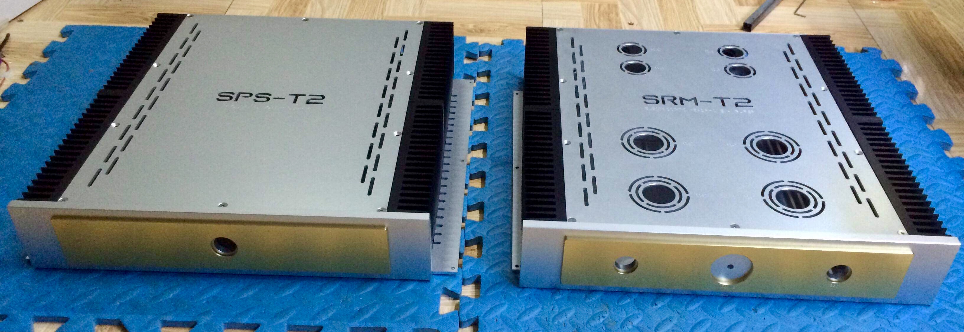

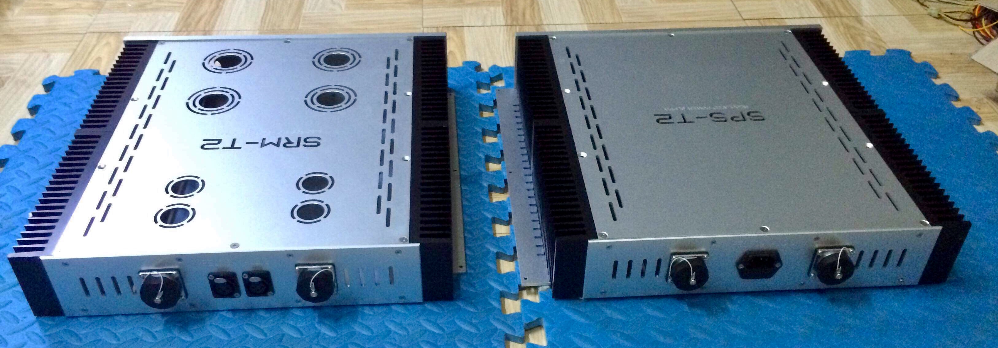

I don't own a Stax but if I did, it would be the 009s with a Stax DIY SRM-T2. 🙂
The ultimate DIY? A Stax SRM-T2! - Do It Yourself - www.Head-Case.org
Is there a schematic? That thread on head case links to many files that are no longer available. I googled and saw some pictures of stuffed circuit boards, and it appears to be an otl push-pull design, with op amps, guessing to be constant current source feeding the tubes. Bi-polar regulated power supply, it seems.
