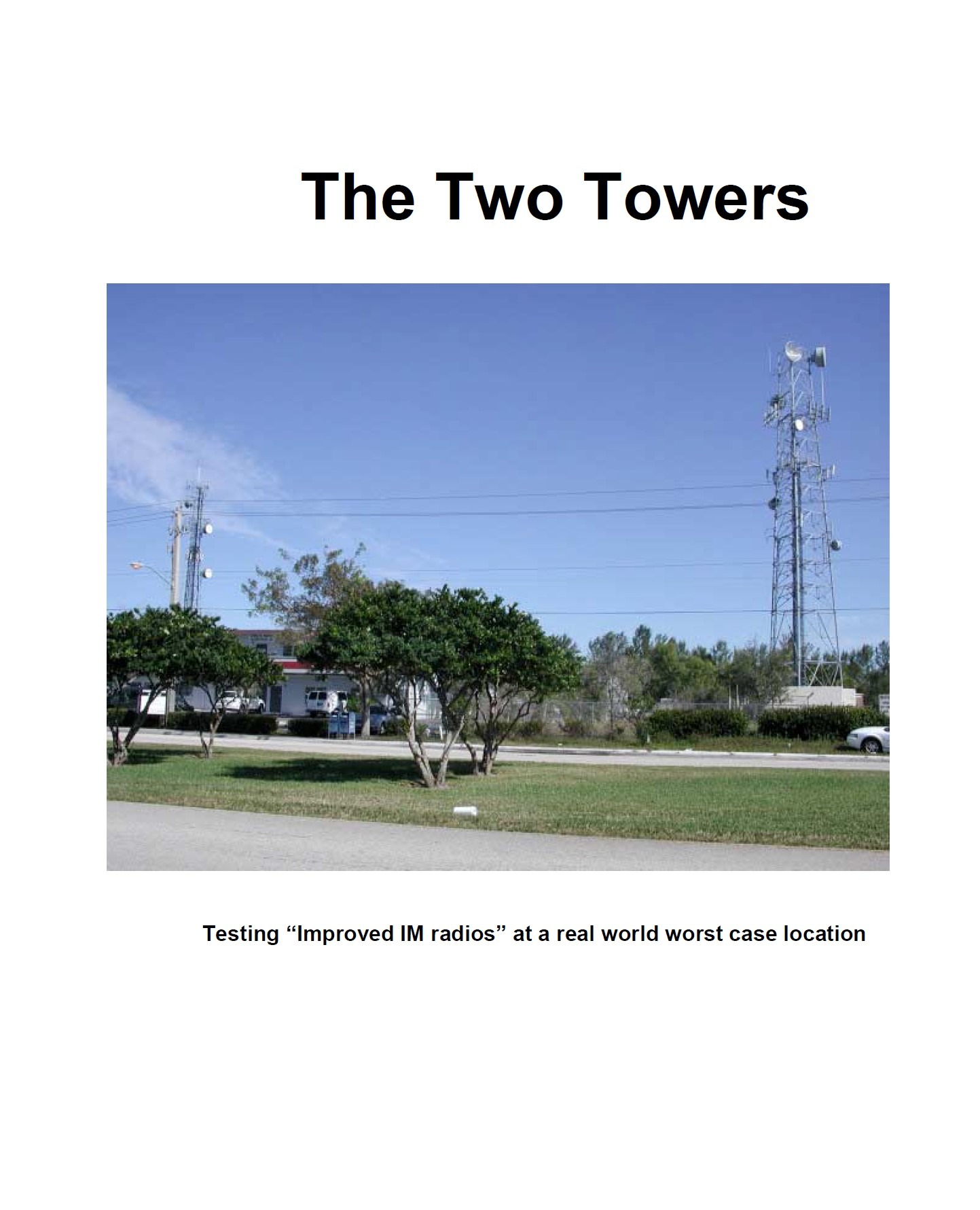

That's one of the reasons that I had a new, unique, and never before seen cell phone almost every month. Nobody could "destroy" or find faults in a phone like me, and I had access to places that most of the other engineers couldn't get to or didn't even know existed. I had roof access for several years at the Motorola plant. Ever climb the framework and sit on the top of a cluster of about 20 antennas carrying live transmissions on every usable frequency from 30 MHz to a few GHz (IMD immunity test). Who would think to hold the phone in the same hand that's holding a spark plug wire on a running engine (impulse noise interference test).
I also knew where the strongest cell, TV, and other towers in south Florida were. This pair were aimed west to cover the Everglades swampland. Maximum RF exposure to ground level humans don't apply to the cattle, horses. and goats on the ground to the west, nor the snakes and gators in the swamp a bit further west. Unfortunately, this mess trashed reception for police radio equipment. I spent many days in the fields west of the towers testing modified radios and making measurements. Another high RF environment is the east end upper deck at what is now known as Hard Rock Stadium. Here you are looking at 12 TV transmitters that each put out 1 MEGAWATT of Effective Radiated Power plus several lower power transmitters. Yes, I got the boss to sign for tickets to a few Marlins games, but he wouldn't go for a Dolphins game.
The picture shows the front page of a 12 page document I wrote back in 2003 detailing the testing and measurements I made at that site. Nobody wanted to do this kind of work. I never understood why someone would rather sit in front of a computer all day, every day, doing pretty much the same thing every day. At least I got to go outside and play while getting paid for doing it. I learned that goats will eat your notepad. That experience got me two extra days outside. It took a few years for the local cops to realize that the two guys driving around with test equipment strapped to the roof of their car weren't terrorists, as the World Trade Center incident was still current news. What's a cop to think when they see that you have about a dozen police walkie talkies, that are on their frequencies (with the transmitters disabled) and far newer and better models than what they had.
