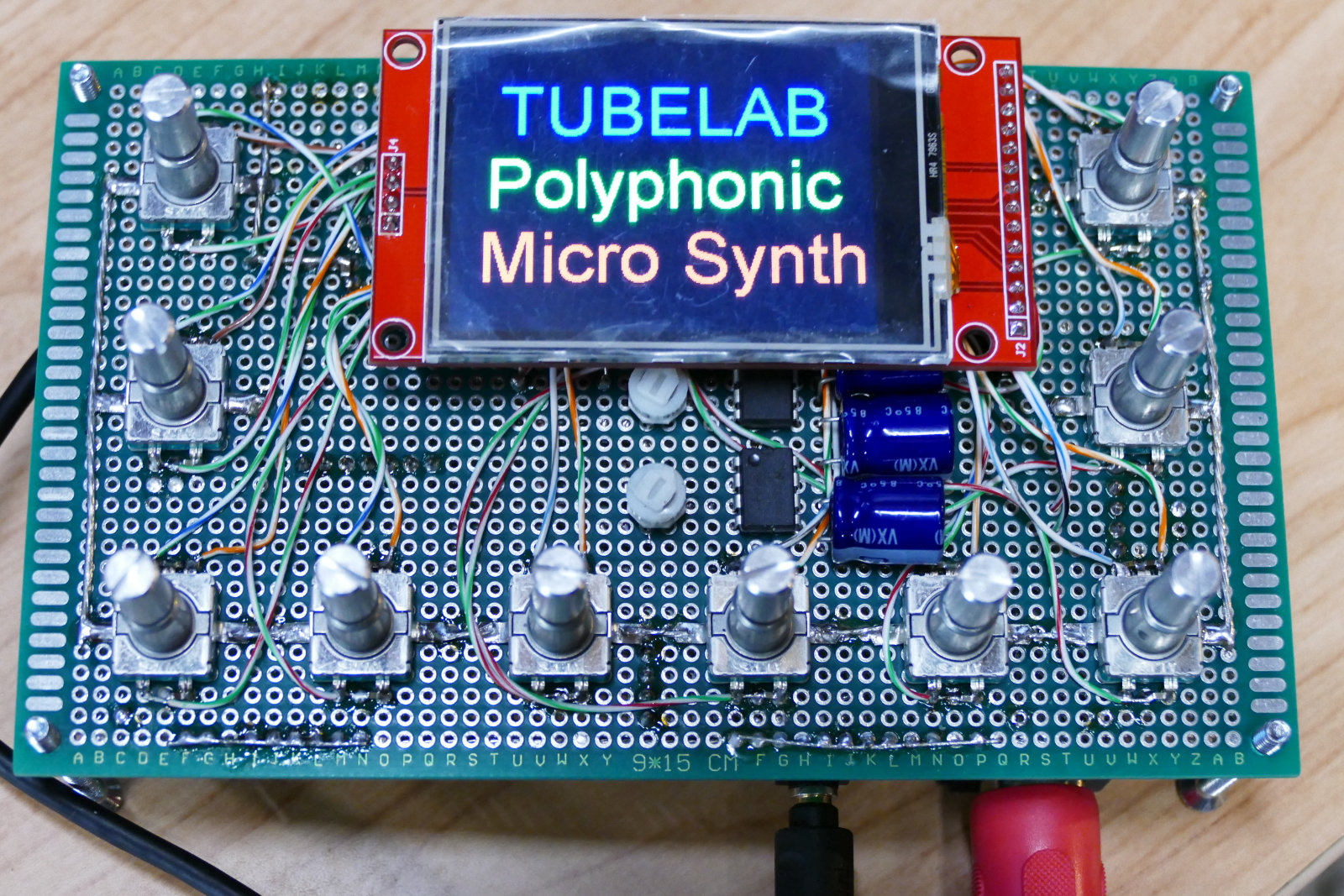

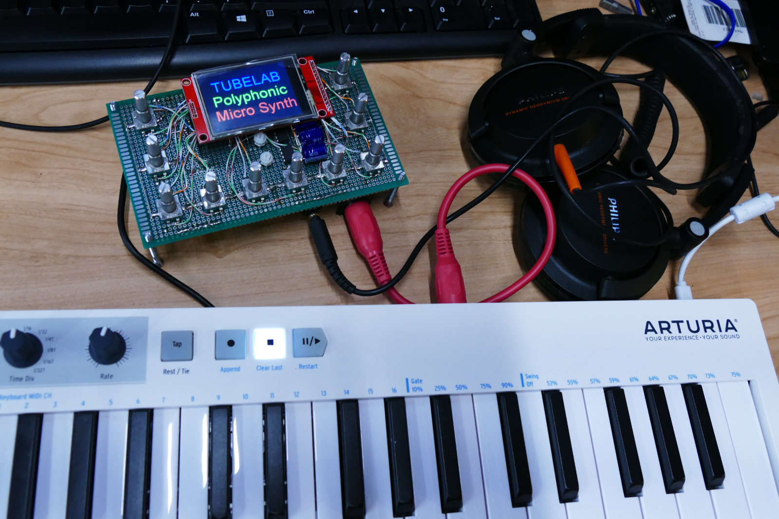

I have been working on this one for a while, and it's obviously far from done, but it made it's first sounds a few minutes ago, so it is now "created." It remains to be seen how it will mature. This is a hand wired breadboard, and several revisions and mistake fixes have been performed already. The final version would be on a PCB, and may even take on a different form factor.
A few months ago PJRC sent me a free sample of their latest and most powerful Teensy board. My mission is to see how many digital music synthesizers it can support running simultaneously. With an ARM Cortex M-7 running at 600MHz (overclockable to 1GHz), I'm aiming for 16, as there are 16 MIDI channels in a cable.
My previous Teensy synthesizers have all been virtual analog synths with 1V/oct voltage control. This one accepts MIDI directly which eliminates a lot of A/D reads, multiplexing, and software conversion.
Right now I'm fumbling with the code writing, which has always been my weakest link.

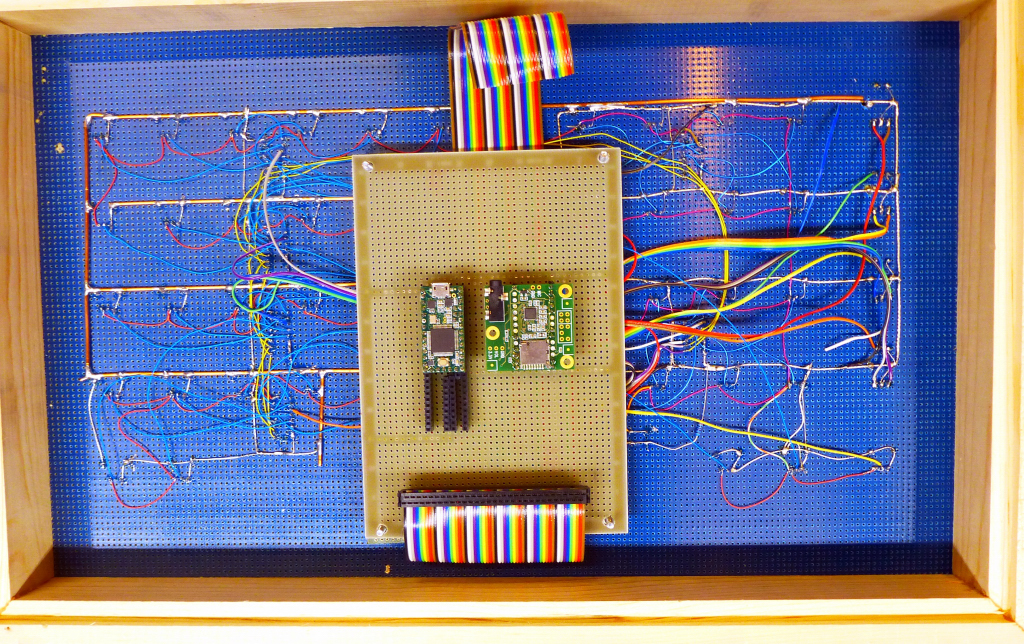

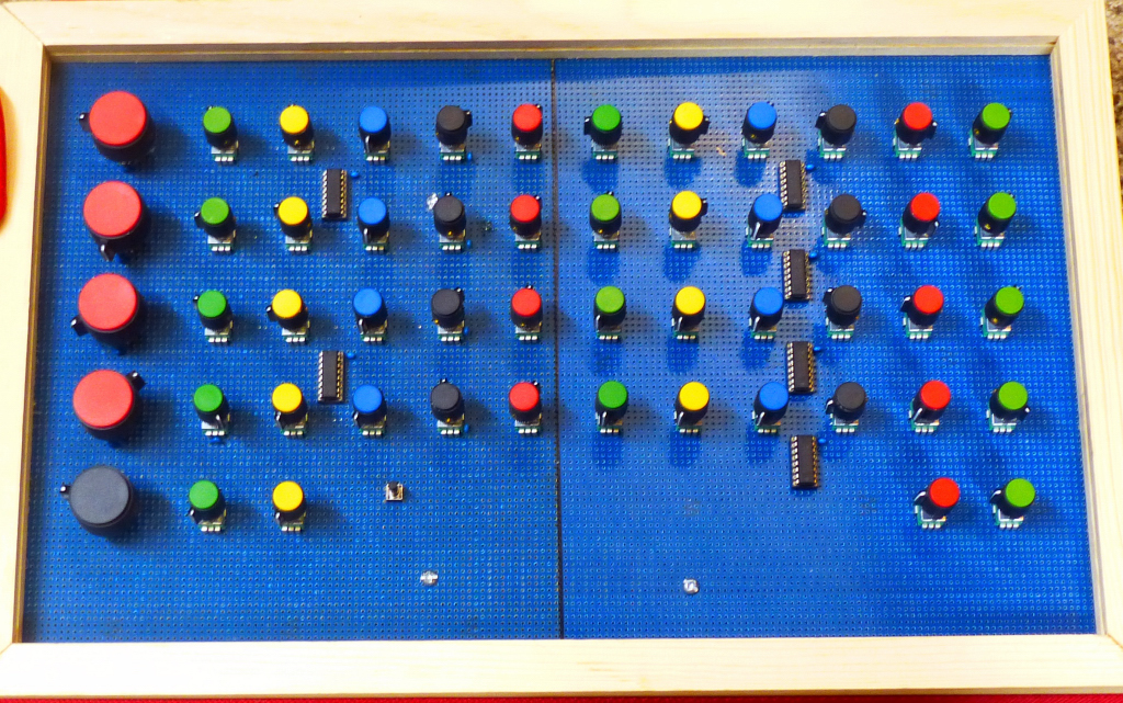

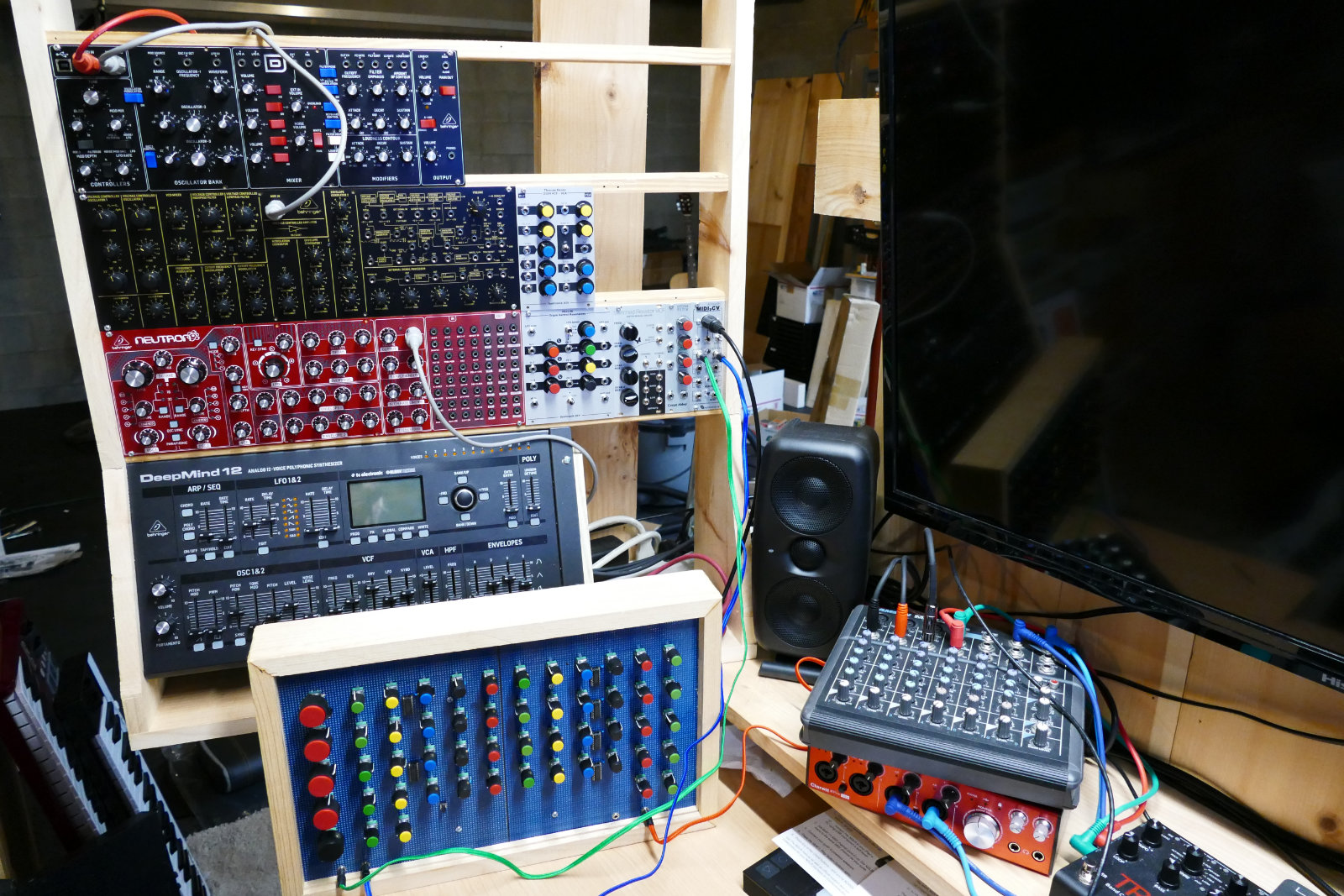

There is no printed schematic as yet. This synth as well as all the other Teensy based synths started with the Teensy module. I added things like pots, encoders, an LCD touch screen, a MIDI input jack, an audio DAC and a pair of LM386 audio amps to drive the headphones. All were wired like the examples given on the Teensy web site. I simply hooked up different combinations of these things until all of the pins on the chip were used up. I have made 4 working synths this way so far, a new one for every new module that they release.
If this thing gets to the "make a PCB" stage, then I will make a real schematic. This has not happened with the first three synths yet, since I have not been satisfied with them enough to make another copy. All are technically quite simple though.
There must be a happy medium between a full blown modular and a simple box with a couple knobs, a screen, and 27 layers of menus to control everything. These synths have been my attempt to find it, at least for me.
The modular has the highest degree of flexibility, but minimal ease of use, and zero "program memory." The best "memory" is lots of different color patch cords and a lot of pictures of where the knobs are set. The high number of controls, and jacks dictate a large size, and high cost for the completed machine. Portability is also very limited.
Synth #2 (pictured) had a fixed signal path (no patch cords), but 53 controls. The highest cost in this unit was the 48 pots, followed by the 53 knobs. This synth has limited portability, and signal routing, but it useful. The cost of a PCB for something this size along with the pots and knobs make it prohibitive. A Behringer model D is cheaper than the parts to build this, although this is essentially two D's.
Synth#1 is the light colored board in the 3rd and 4th picture next to the UPS. An Axoloti synth board is to its right. The last 4 pictures were taken on a vacation trip where the UPS was often the only power source. I would charge it overnight, then use it for power during the day. It would run the synths and the portable PC (middle chair) for up to two hours.
Most humans have two hands and two feet. This means that under most use cases only 4 controls can be operated simultaneously. A synthesizer with the capability of a full blown modular could be built with 4 controls, but the methods to multiplex them all would require some serious effort. In any event a serious learning curve would be needed for the end user to figure it all out, which is why a lot of keyboard players never get very far past the build it preset sounds.
This box is an exercise in the other extreme. 10 knobs and an LCD screen. Where it goes from here is yet to be determined.
Right now it runs a simple Karplus-Strong synth that gives a somewhat realistic, but pleasing acoustic guitar sound, especially with strummed chords. That's synth #1.
I am now working on synth #2, a 6 note polyphonic version of the duophonic digital "D" in the blue faced box without 1V/oct control, just MIDI.

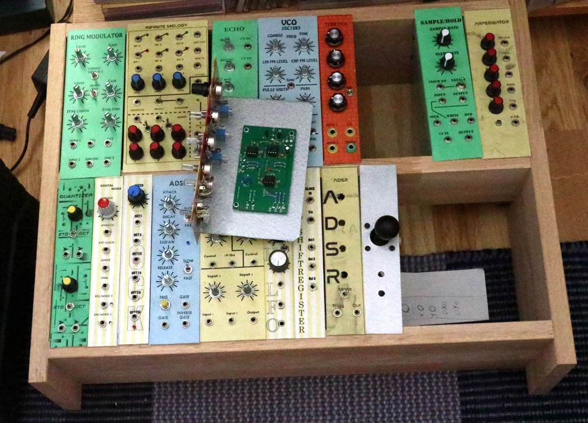

This is more or less what I have achieved this year. However I have problems with the connectors and even if the sheet metal is pretty sturdy, I would probably need something like 2mm aluminium instead.
I have a 32-step sequencer, but plan for a 3x16 step using an Arduino to control the logic and one thing I would find very cool is a way to adjust the three banks si I can have them start independent of eachother, but still the same timing.
(Got myself a Behringer Crave, to have something that is working and is making noises, and I have hooked it up with my Mutable Anishru).

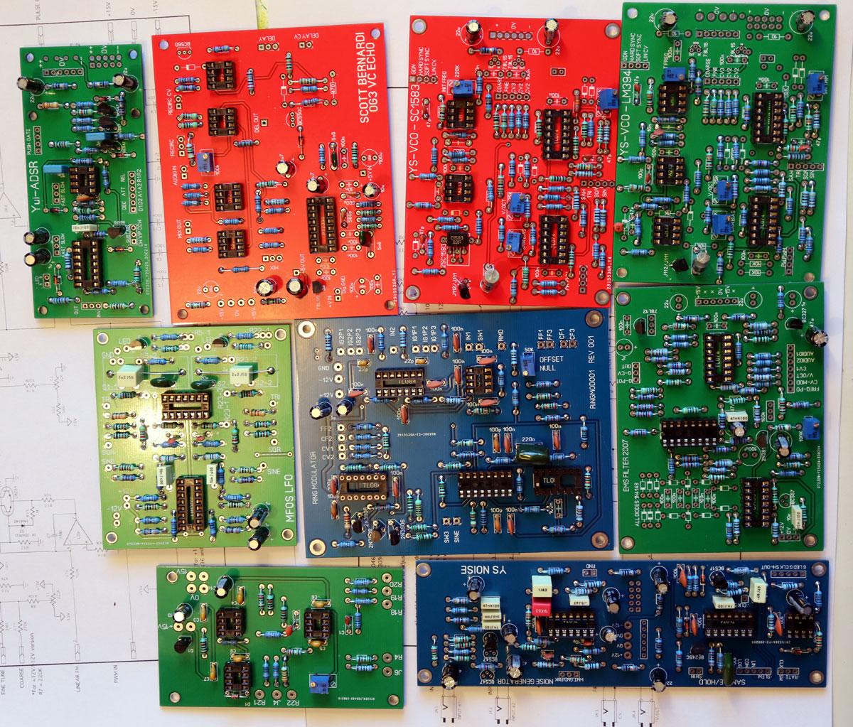

I did finally finish populating both of my MFOS boards, the Ultimate and Ultimate expander. It only took about 6 years. Some of the individual circuits on the Ultimate have been tested, and a couple mistakes were fixed, I'm sure there are more waiting to be found. The front panels and cabinet are still works in progress.

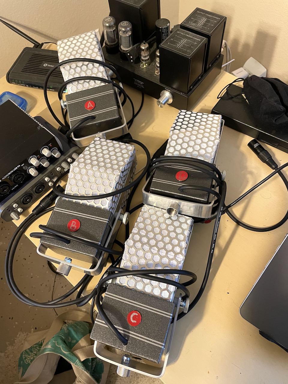

Also a pile of fake RCA mics for the same play. Each has inside of it a working AT2020 mic. That means they are not just props, but the actual mics for the play. They look good 3+ meters away.
