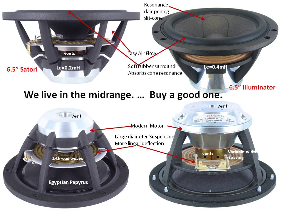

Several respected designers praise the Satori line of drivers from SB-Acoustics.
CHECK OUT kits which use either the: 6" Satori MW16P or 7" MW19P midrange in a sealed cabinet, plus a 10" or 12" musical woofer that fits your room requirements.
