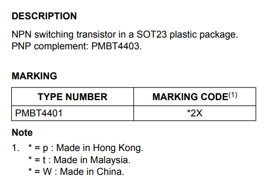

What could these 2 transistors on a Infinity Reference 10001A?
The two markings below are T2X. I am unable to identify the other two, but I have encountered T2X alongside T2T.If anyone has information regarding this, I would appreciate assistance, as I cannot locate a schematic for the Infinity Reference 10001A.

I'd agree, The leading lower case t isn't part of the part number mark. It's likely a production location (Taiwan?)
Attached is an example from a different manufacturer. The prefix t means Malaysia.
