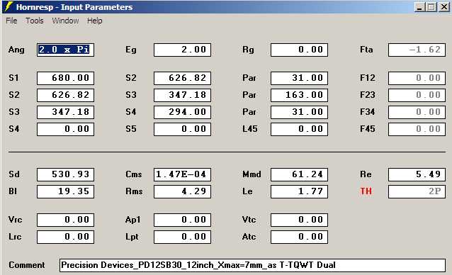

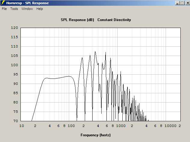

Specs (apart perhaps from the high Vas) look good for 30 Hz THs.
A quick sim suggests that, if you can live with 6 cu.ft. sub boxes per sub, you could use four of them in 30 Hz THs, and the other four as midbass drivers in two/way tops.
