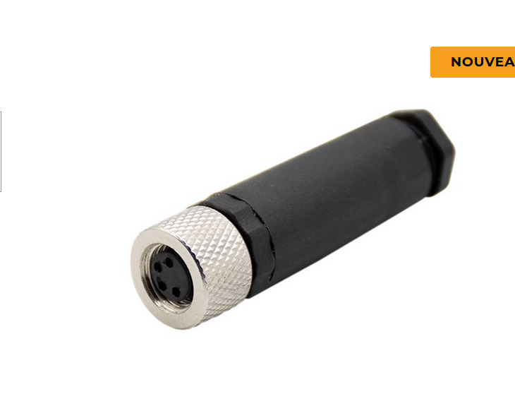

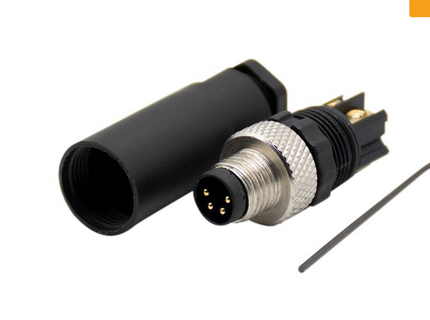

after looking at the diverse suggestions, I have found the perfect combination in M8 with 4 poles, specified for 60V/3A, I can of course wire 2 poles in parallel. They exists with screws, solder lugs, angled or straight, male and female flying and panel-mount, plus decent pricing and sizing. For those in Switzerland, Distrelec (not affiliated) has them for about 6-7 CHF each as articles 301-64-666 and 301-64-664. Thanks all for your inputs!
At distrelec.ch, I see these 4 brands : Binder, Bulgin Limited, Phoenix Contact and RND Connect (the internal distrelec brand). However if you search "industrial M8 M12 connectors" you will find multiple vendors. Seems like it's a standard for sensors. They have as well multiple "coding", I didn't check this aspect, I suppose it's to avoid mixing them.
My 1st application is 12V DC to my Squeezebox Touch (3 of them). With time the power socket get loose, I open the case, solder wires, and then put a male/female pair of those M8 to be able to disconnect the power module. I can then at some point, eg when running out of projects, build a linear PSU with such a M8 case socket just for the feeling of having a new box on the audio rack 😉
