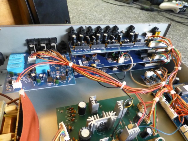

If you need a hand let me know. I'm fairly good at debugging. My phono stage had a problem where the left channel only worked when you had a DMM on to measure the supply voltage! If you can take a picture to post that would be helpful.
Can I just double check. Is it both channels or just one?
Hi bill, it's both channels, and actually, I only tried the digital out once, when no sound as I heard the speaker hum, so I presumed it was working, I double checked but nothing is coming out of it while music is playing, music (in optical input) it does play music in all the phono stages even while it is crackling loud...

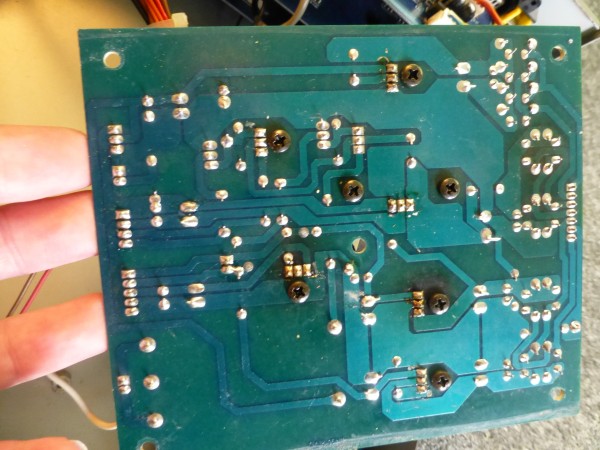

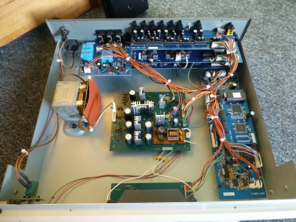

I'll take a few pics of it and underneath the main power supply board...

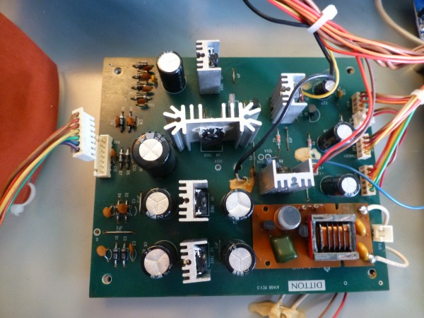

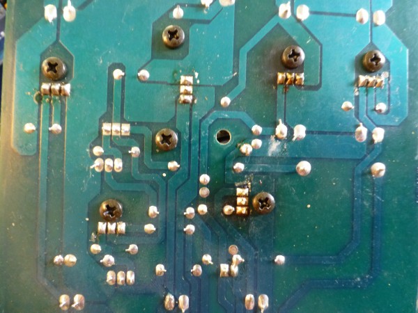

The pics, might just be me, but 2 of the underneath transistors there look a lil burnt...

The burn doesn't necessarily indicate a problem but it is a sign of things running hot and hot parts can fail.
I would suggest you carefully measure the voltage output of those regulators (on the heatsinks) and see if the voltages you get seem reasonable. You need to be careful measuring and one slip with the meter leads could be disastrous. So be careful.
Although we don't know what the voltages are we can still check if there is output and whether it is reasonable. See what the devices are, for example 7812 or LM317 etc etc and determine what the expected voltage for each would be. There doesn't look enough extra parts for the regulators to be discrete.
