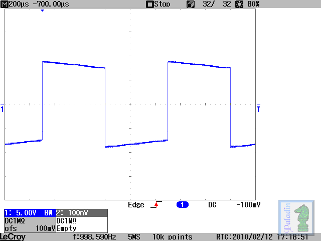

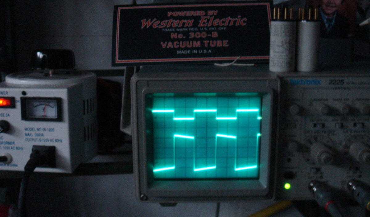

LF rolloff, probably 5-10 times lower than the squarewave frequency.
First order, perhaps.
LF roll-off, -3dB at 25 Hz or so.
Here's a simulation generated using a Khron-Hite hi-pass filter set to a 25 Hz -3dB "knee"...
