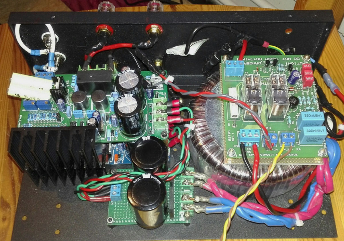

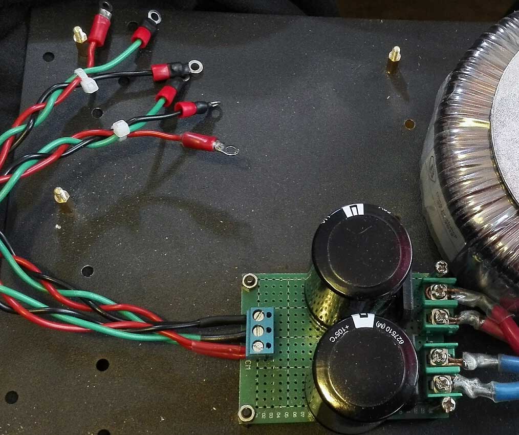

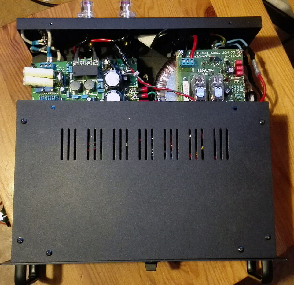

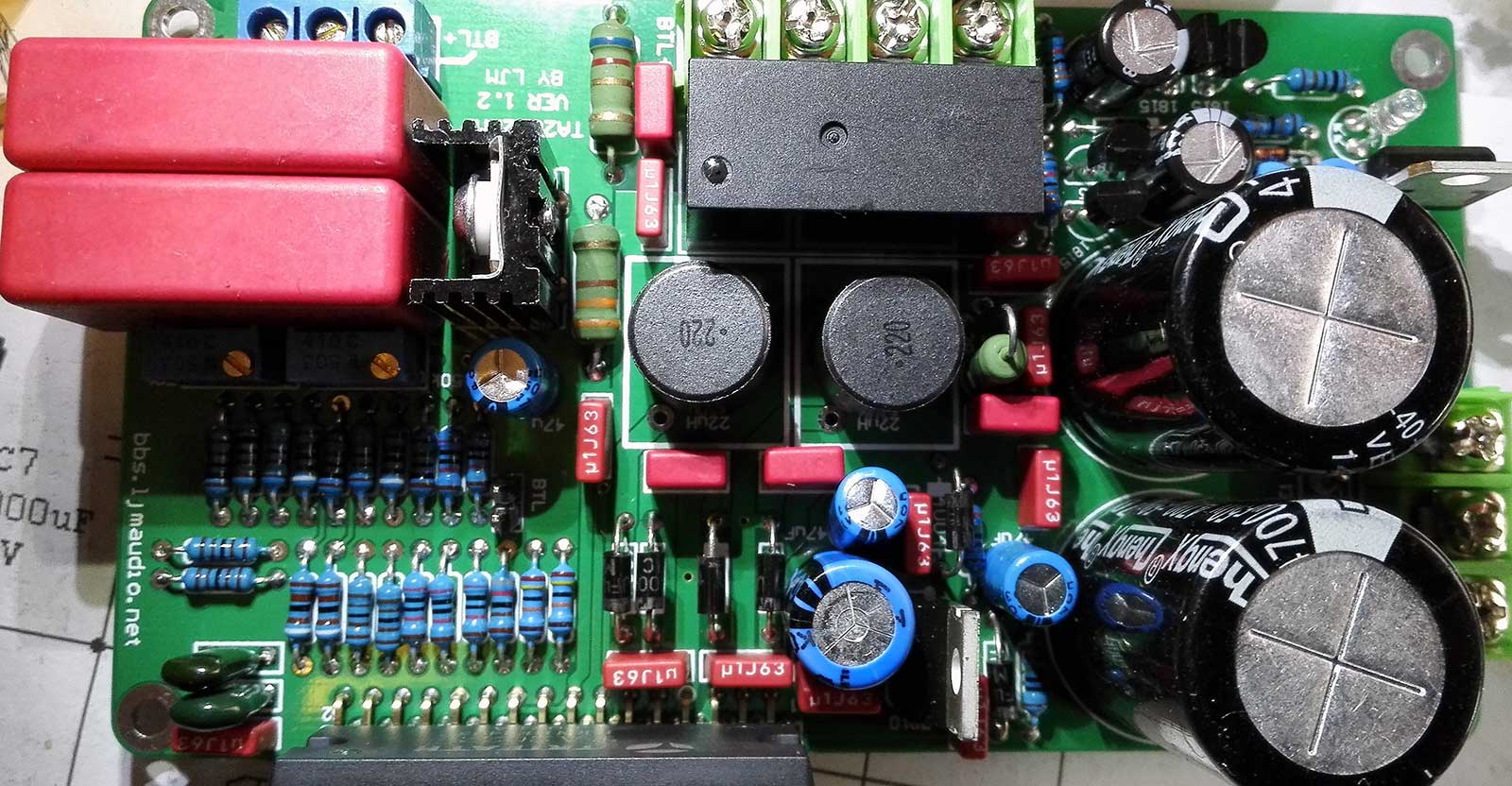

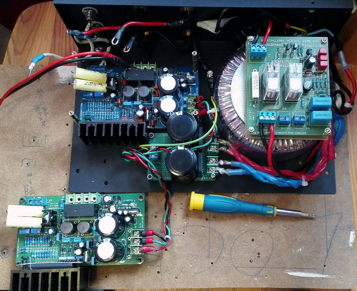

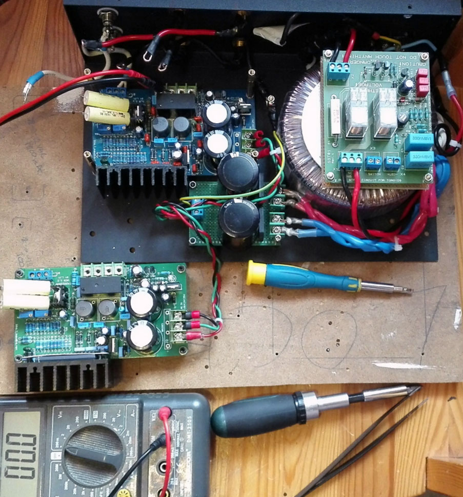

I've done some work on the amp.
The boards are identical except color.

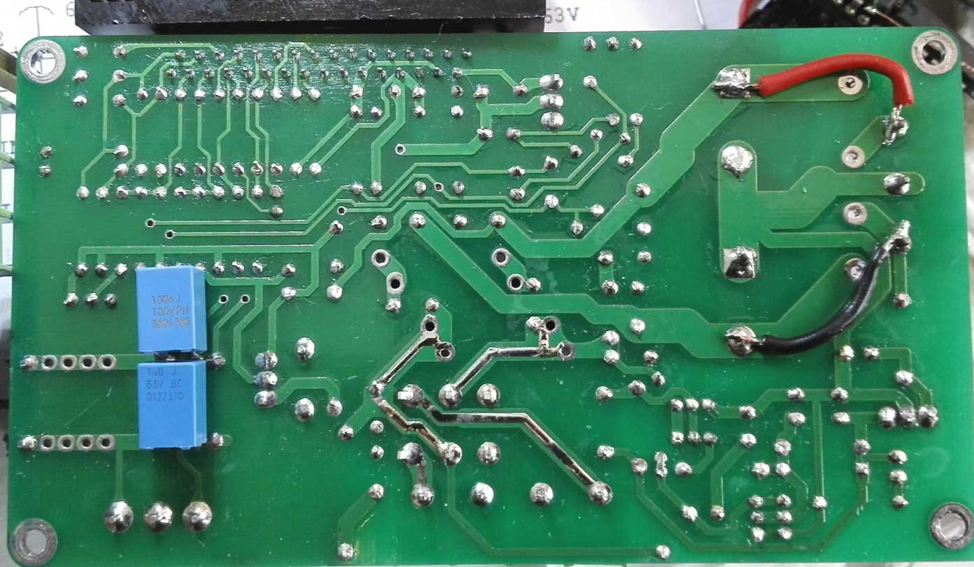

I've removed on board rectifier bridges to be able to power them with a 0-22vac 0-22vac 400VA toroidal transformer.
Added 10000uF per rail on the rectifying board.
Using ICEL 1% 2.2uF parallel with 1uF Vishay BC as input caps.
Due to the size of the enclosure, I can't get the boards further away from the transformer.
Now I'm waiting for XLR connectors and I need to read up on TA2022 offset adjustment before doing the trimming and eventually putting the boards in BTL mode.

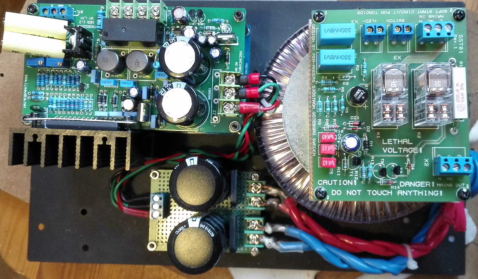

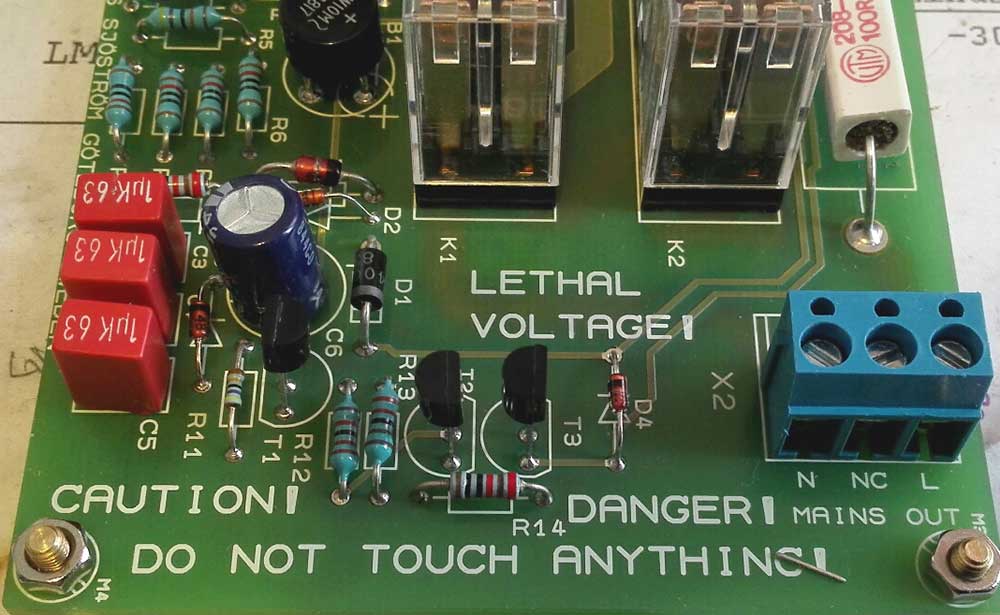

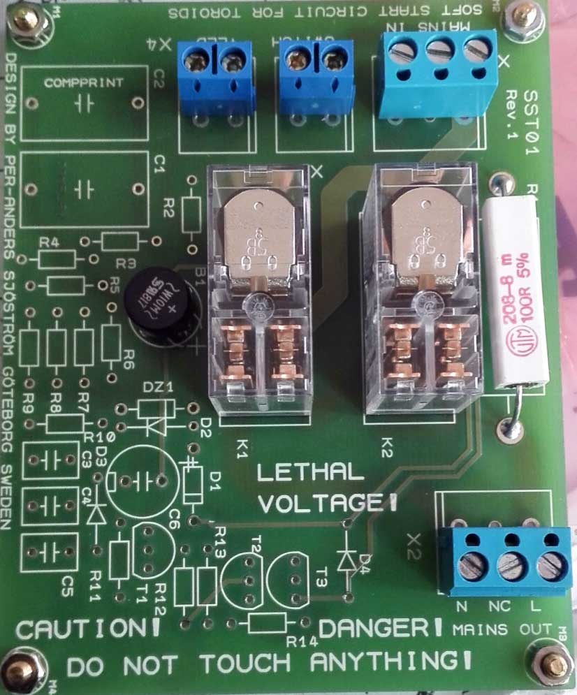

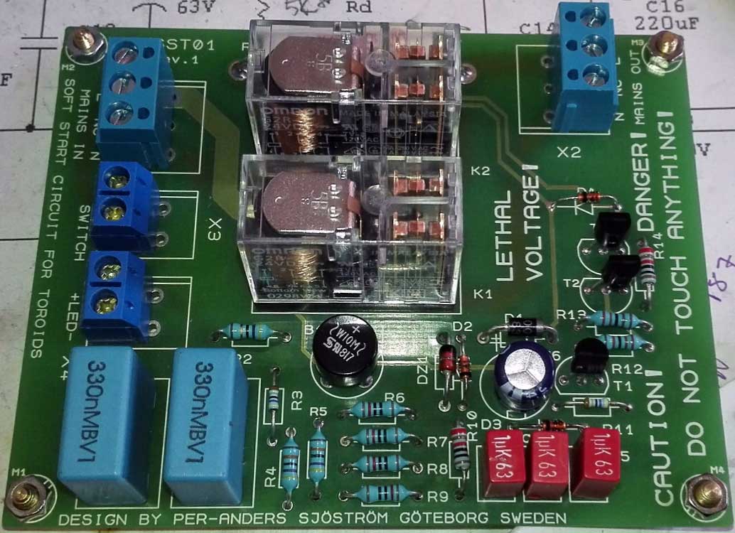

I found a SST01 softstart PCB in one of my parts boxes yesterday.
Unfortunately the BOM and other documentation seems to have been misplaced in the years since I bought the PCB.
I did find the relays and 5W resistor in the same box, but nothing else regarding the SST01.
Sorry about the crap phone pic.
This should be a good addition to the TA2022 BTL amp, especially with the 400VA toroid and extra capacitance.
Thanks for the link to the BOM P-A 🙂
Softstart built and ready to go in the power amp.

I hope to get far enough to trim DC offset of the boards(individually, in stereo mode).
I found some info saying it was OK to power on the TA2022 without anything connected to inputs/outputs.
I have misplaced my 25W 8R dummy loads some time over the years unfortunatly.
I have some metal work to do as well, I need to shorten the bolt holding the 400VA toroid transformer as I plan on mounting the SST01 on top of the transformer due to limited space in the enclosure.
I need to cut a hole for the power switch on the front panel etc.
A question;
Will the TA2022 x2 in BTL benefit from additional input caps, some kind of filter or similar on the connectors(chassis connectors)
I've come to realize I don't need a balanced signal after all, feeling a but stupid not having noticed that until recently, but XLR connectors will make the interconnect to the DCX2496 easier to make with balanced connectors in both ends.
I'm just about ready to test the amp now.
I figured I need to trim DC offset as low as possible on each board individually before jumpering them for BTL.
The switch I had originally intended to use(in the pics) unfortunatly broke.
I've ordered another, 15A 250VAC, switch.
I have connected PS gnd to "star-gnd" that connects to IEC earth.
Since I don't have my big 8R resistors, what power rating would be ok to use as dummy loads? I figured I'd need something or the caps would take forever to drain.

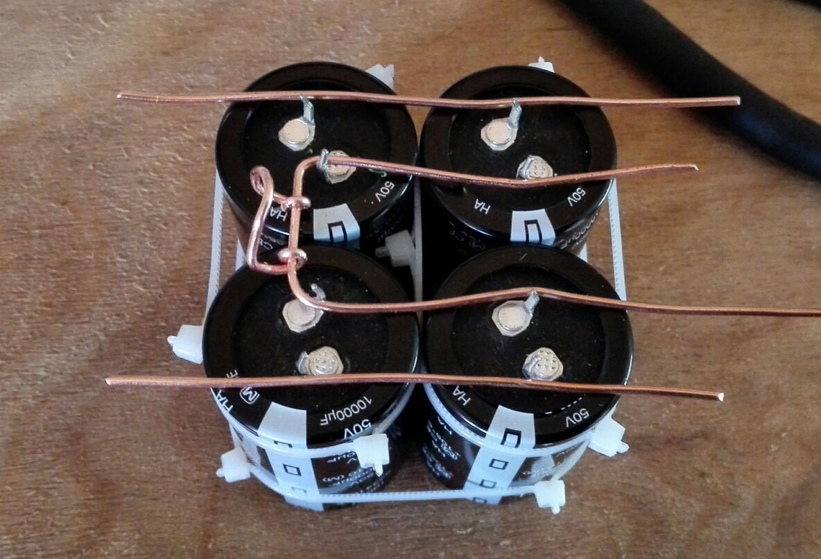

I may rebuild the rectifier/cap bank board, I could probably fit two more Panasonic ha 10000uF caps if I point to point wire bridges and caps.
What fuse rating would be enough for offset trim? 800mA slow(should be ok up to about 180W total, 0,8A*230VAC)? The 400VA toroidal transformer shouldn't cause that much inrush current with the P-A SST-01 softstart module.

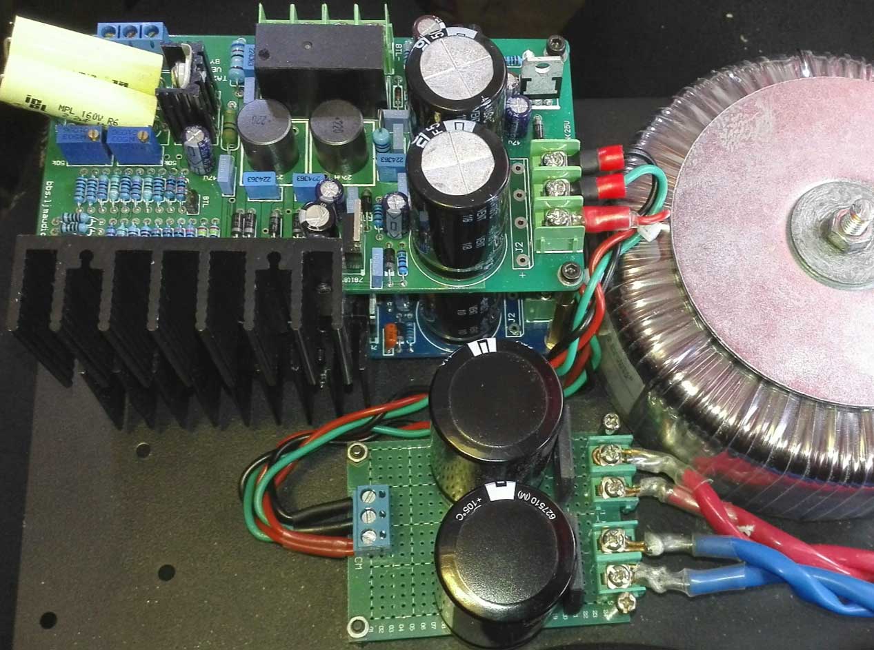

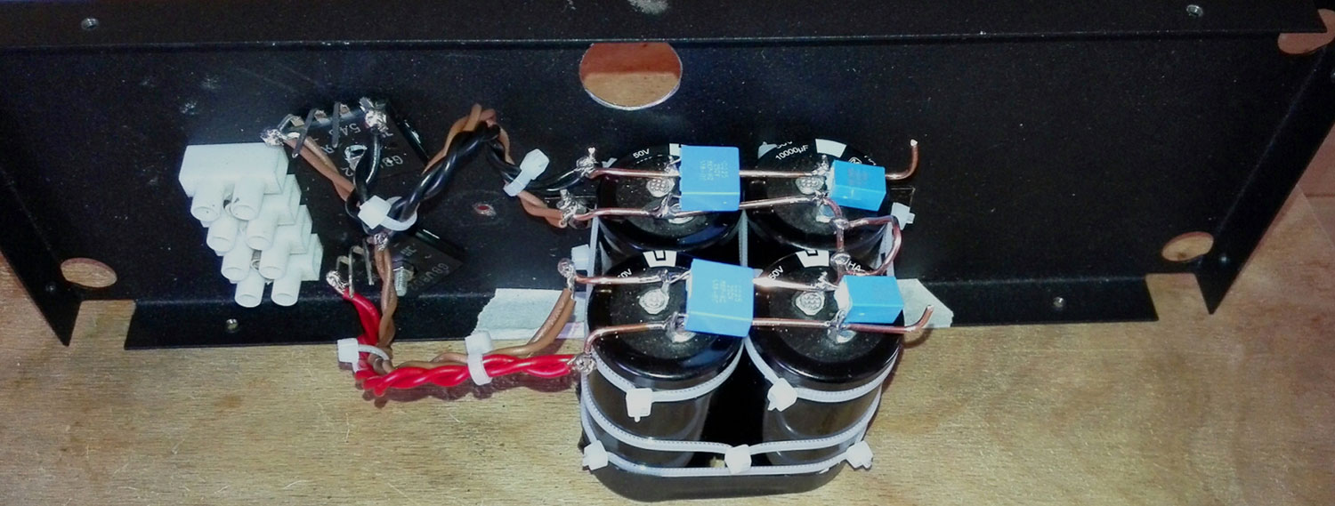

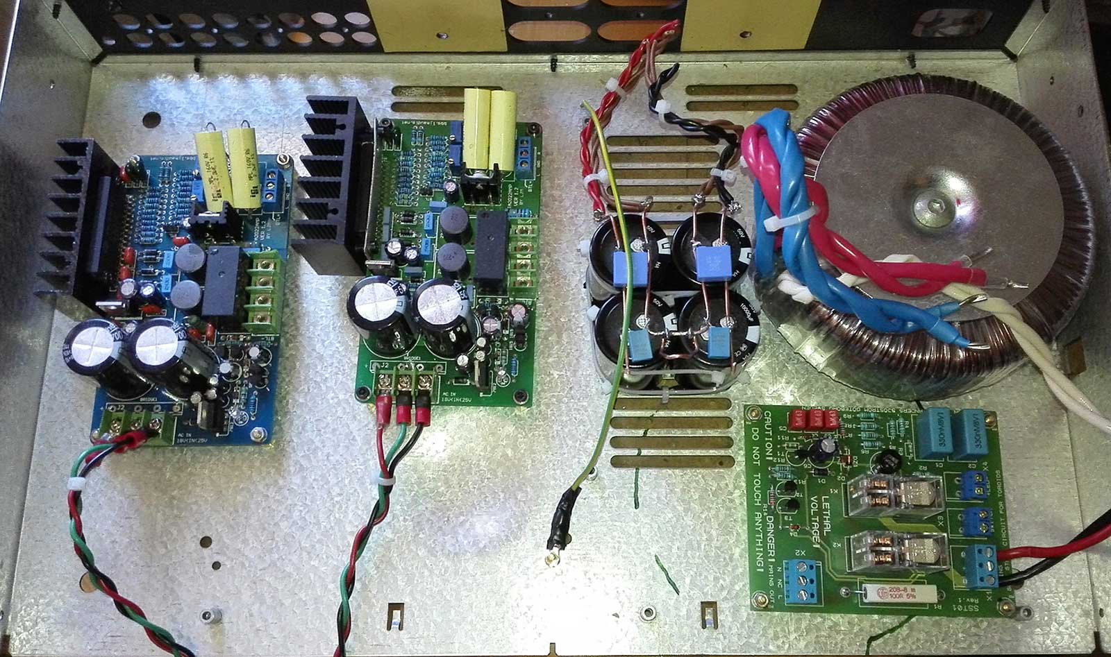

Didn't get around to trimming DC.
Did however increase the cap bank to 4x 10000uF Panasonic ha.
I had to mount the whole thing on the inside of the frontpanel to make it fit.
Again sorry about the bad phone pics, I'll try to get better at using my DSLR.

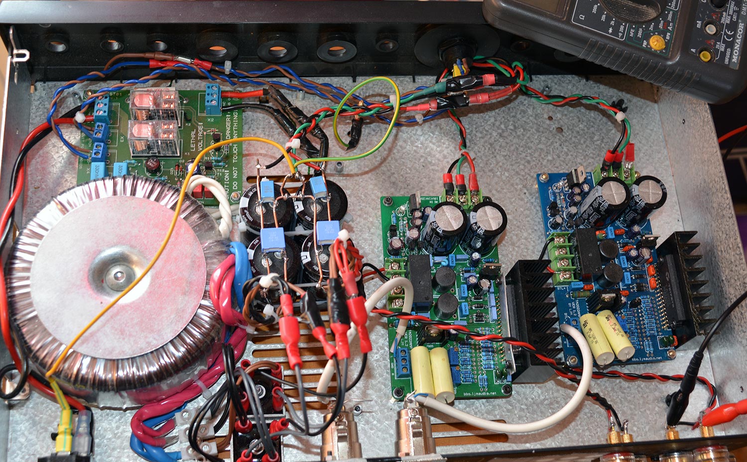

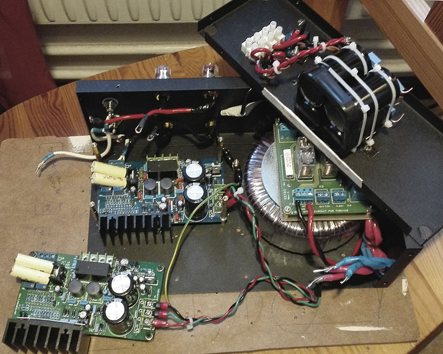

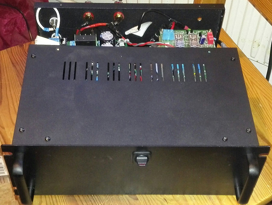

Moved the BTL amp to a bigger enclosure.
Still not quite done though.
Waiting for some beafier bridge rectifiers, and I'll need some nice wood or similar as front panel.

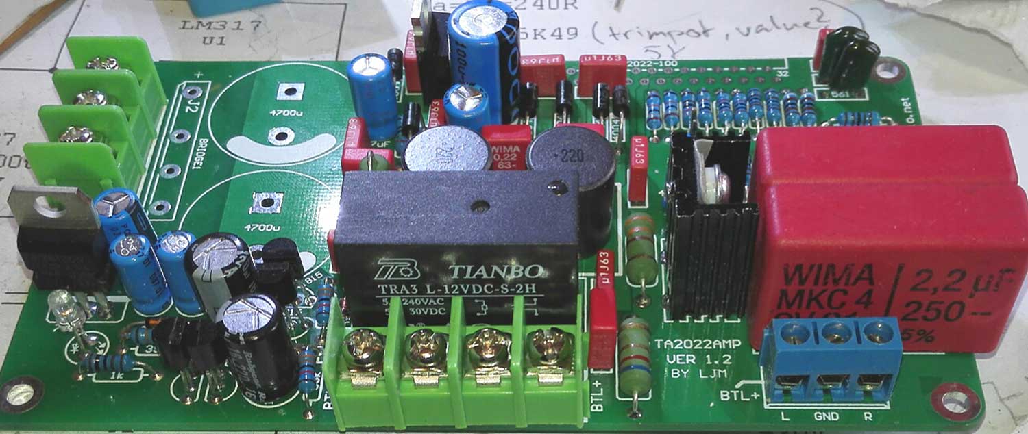

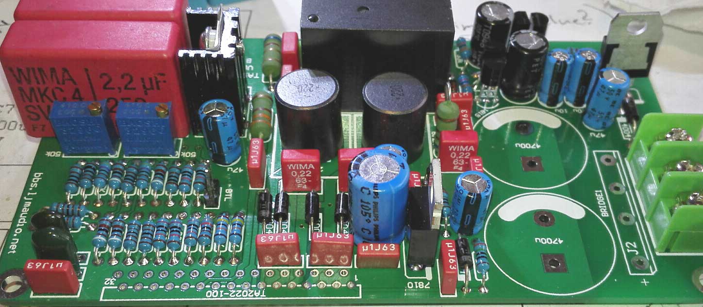

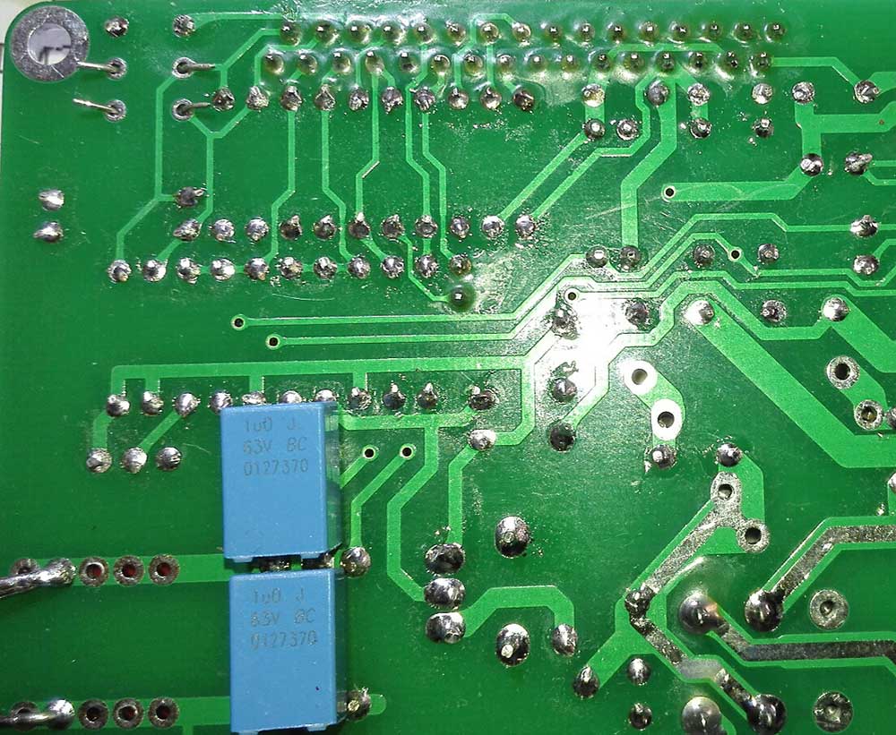

Got started on the Stereo configured TA2022 that'll drive the mids/highs of my dipole speakers.
Transformer for this is a 200VA 18-0-18Vac toroidal transformer.
I'll use off-board rectifying bridges and extra capacitors(2x 10000uF Panansonic ha).
Original plan was to use Rifa PHE427 3.3uF as input caps, but there was no chance of making them fit.
So I went with 2.2uF Wima MKC4 paralleled with BC Vishay 1uF caps.
I've used other parts than the ones that came with the kit a few positions.

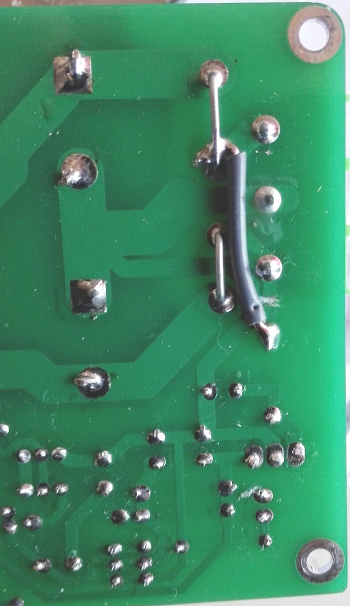

Flipped the switch on the TA2022 BTL amp today. No puff of smoke 🙂
Wiring needs to be cleaned up, I know.
I had to make some changes to the PCB's to use "off board" rectifying and caps.

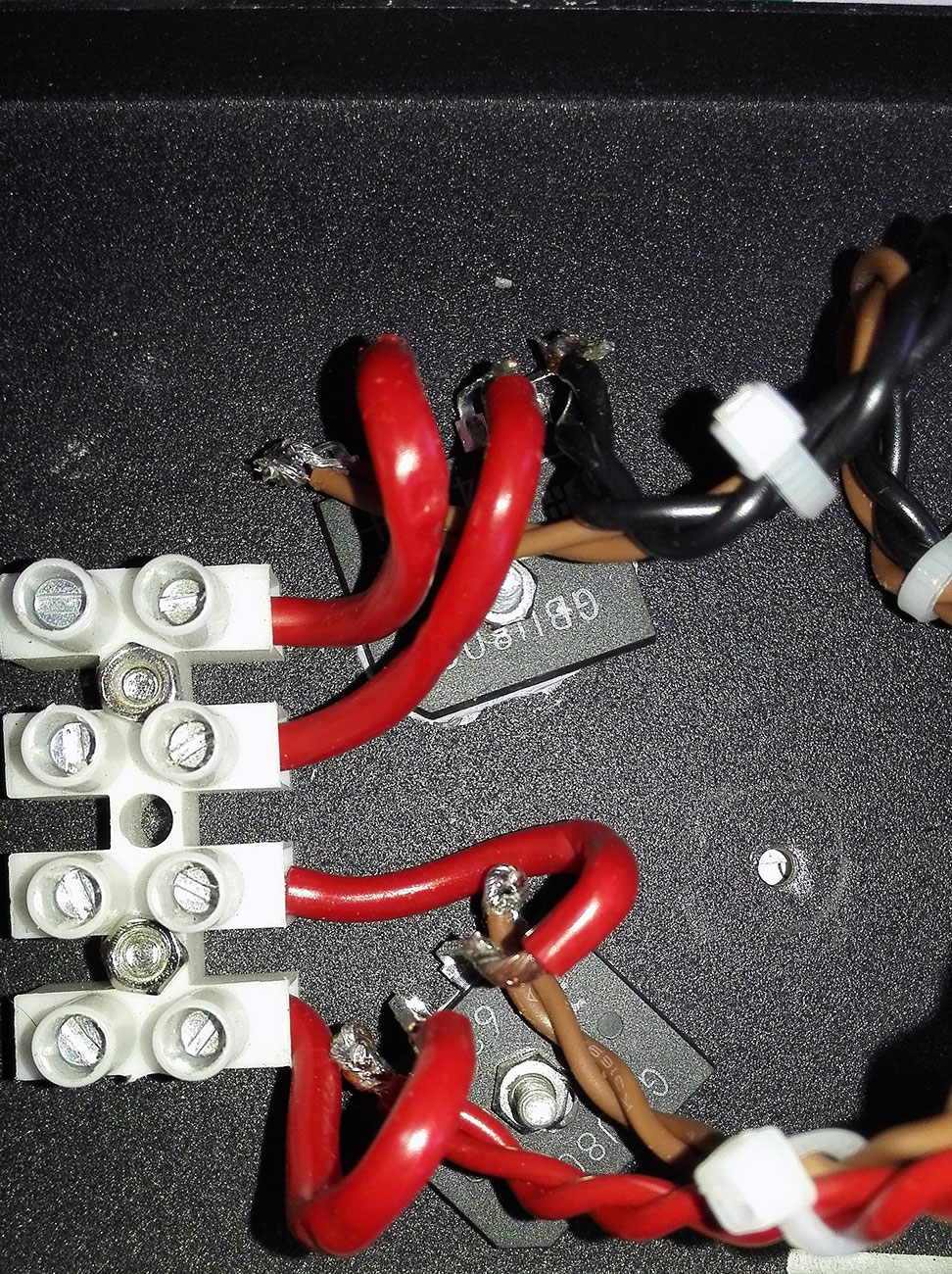

Is the TA2022 able to run without load? Ie, can I trim down DC offset without a load connected?
Are my woofers ok with that DC offset until trimmed down?
I get about +89mVdc on the board I bought a few years ago assembled (when jumpered for BTL operation). DC offset spikes to over +350mVdc at power off.
All the above without load on inputs or outputs(I had the amp powered on for about 5sec as I didn't want to risk damage if the TA2022 doesn't like running without a load).
My woofers are Dayton 15" IB's in open baffle.

I'm not sure how to proceed here...
Grateful for any and all advice.
