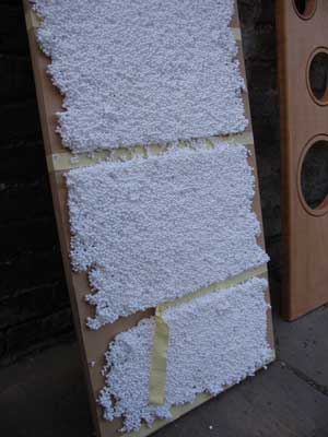

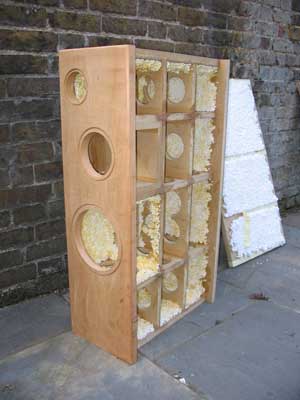

What changes should I make to this cabinet?
Side of cab.
I masked off the areas where the bracing will attach and will just finish cutting the beads and then remove the masking tape before glueing.

Vikash said:
Not worried about size there are you 😉

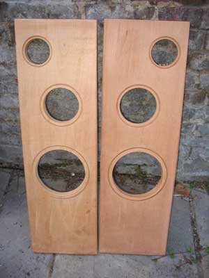

Looking very good! Comprehensive bracing :up: but applying it asymmetrically might be something to consider in future to spread out panel vibration. Also the driver distances seem a little far apart, but it all looks very grand thus far... 😉
😀 I think they look bigger in the pics, they are only 11 inches wide. 🙂 Anyway, bigger is better 😀 They are 90 litres without the bracing, beads and mid enclosure which should give me about 50 litres.
Thank you. 🙂
I have made the bracing so no two compartments are exactly the same size, I'm pretty short of time so had to go for something easy to build quickly - cheers for the idea of asymetrical bracing - I'll have a go with that for the next set. 🙂
I couldn't really get the drivers much closer because of all the bracing so have spaced them out very slightly so they look good (I hope)
They should be finished next weekend. 🙂 I haven't got time to do a gloss black finish as I wanted (I'm OK with spray paint too) so have ordered a black satin finish I can brush on. I can always refinished then in the future.
The baffles look great - really nice pieces of wood - you can't see it in the pics but I wiped them down with white spirit to see the colour - they'll look fab. 🙂
