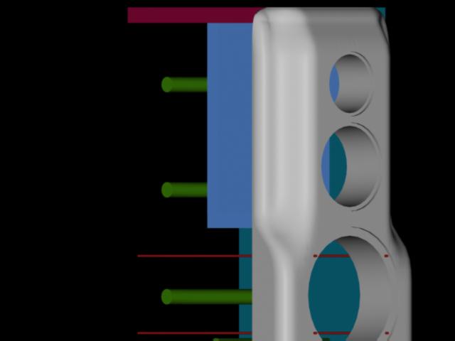

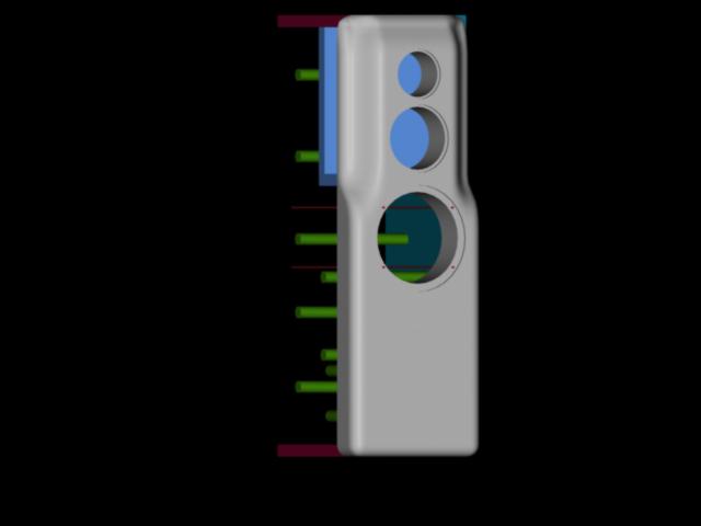

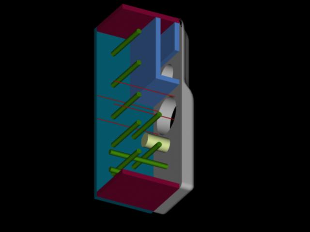

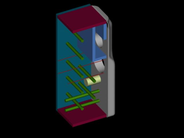

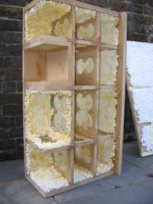

Looking very good! Comprehensive bracing
but applying it asymmetrically might be something to consider in future to spread out panel vibration. Also the driver distances seem a little far apart, but it all looks very grand thus far... 😉
Vikash said:Not worried about size there are you 😉
Looking very good! Comprehensive bracingbut applying it asymmetrically might be something to consider in future to spread out panel vibration. Also the driver distances seem a little far apart, but it all looks very grand thus far... 😉
😀 I think they look bigger in the pics, they are only 11 inches wide. 🙂 Anyway, bigger is better 😀 They are 90 litres without the bracing, beads and mid enclosure which should give me about 50 litres.
Thank you. 🙂
I have made the bracing so no two compartments are exactly the same size, I'm pretty short of time so had to go for something easy to build quickly - cheers for the idea of asymetrical bracing - I'll have a go with that for the next set. 🙂
I couldn't really get the drivers much closer because of all the bracing so have spaced them out very slightly so they look good (I hope)
