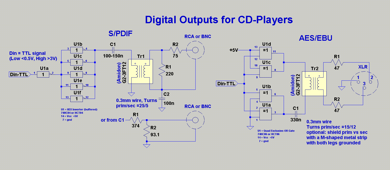

Hi Calvin, a few questions as I'm not an EE. By the digital filter chip are you refereing to the CX23034 or the CX20152? Once I find out if I can get digital out from it, how do I hook it up? I'm thinking attaching a wire to the leg or soldering it to the back side of the PCB and running that to the center pin of a RCA jack. What about the ground on the RCA jack? Tie that to chassis ground or does that get tied to a ground on the chip? I'm hoping to get time this weekend to research this.

from the DS Pin19 is Dout, serial data output, MSB first.
From page 4 one can read that Dout´s level will be Low <0.4V and High >4.5V at 1mA .
That is TTL level.
The first circuit uses simple inverter logic to buffer the Dout.
The 74HC04, or 74HT04 are Hex Inverters, of which 5 are paralleled to achieve sufficient current drive capability and the first is used to double the inversion for a non-inverted output.
C1 AC-couples the signal to the signal transformer.
As core a toroid G2-3FT12 from Amidon may be used, wound with 0.3mm thick magnet wire.
Turns ratio is 25:5, because the S/PIF signal level is only 0.5V.
You may use any other suitable signal transformer too.
If You don´t want to use a signal transformer, the voltage divider made from R1 and R2 will suffice also.
Its values are chosen so low-ohmic to guarantee the specified output impedance of 75R.
The voltage divider gives no galvanic isolation though, but that should be no major issue as there will probabely be a transformer at the receiving end anyway.
A 75R BNC connector will be fine, but often one finds RCA/Cinch as connector also.
The AES/EBU output is a balanced output.
Here a Quad Exclusive-OR Gate 74HC86 or 74HCT86 is suitable.
Two Gates each are paralleled for more current drive capability.
C1 AC-couples the signal to the signal transformer Tr2.
Again a Amidon toroid core G2-3FT12 is usedd, but this time with a turns ratio of 15 to 12, as AES/EBU requires nearly TTL level.
One may optionally increase signal inegrity by shielding.
Just cut a piece of copper strip into a M-shape that fits across the toroid core and ground both legs.
The shield should separate the primary from the secondary winding.
R1 and R2 and the impedance of Tr2 result in ~115R output impedance.
If one wishes to correct for the originally specified 110R reduce R1 and R2 to 44R2.
Output connector is a 3-pole XLR.
