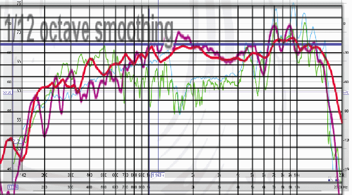

This is PRV 5MR450-NDY, right? It is true that xrk971's measurements (purple) resemble the spec sheet (red), and these (green, blue) don't...

1) measure with far higher integration (at least 1/3 octave , even 1/2 octave) to damp the "fuzzies" and achieve a curve closer to that published by the speaker maker.
Otherwise excess of detail clouds the issue instead of clearing it.
2) I design and make guitar speakers and I see that 1.5kHz anomaly all day long, just look at any guitar speaker curve and you'll see it too.
And being a phase cancellation is impossible to equalize.
In your case, it *might* be caused by speaker cabinet (or front panel) diffraction, so my first suggestion would be to pull the speaker from any "fancy" enclosure, simply to reduce the number of variables, and mount it in a large flat panel, which is the simplest baffle there is (and the easiest to duplicate :) )
You seem to have done something like that, yet that anomaly didn't change (much) , so I suspect the second culprit (the one I always find in guitar speakers) which is undamped/uncontrolled cone flexing.

3) so I must also agree that, since other speakers same brand and model do not show that behaviour, it's a speaker defect and you will not correct it with cabinet alterations.
I'd speak to the speaker manufacturer and tell him about it, showing measurements and even pointing to this thread.
He might have had a bad cone batch or simply yours was improperly assembled.
